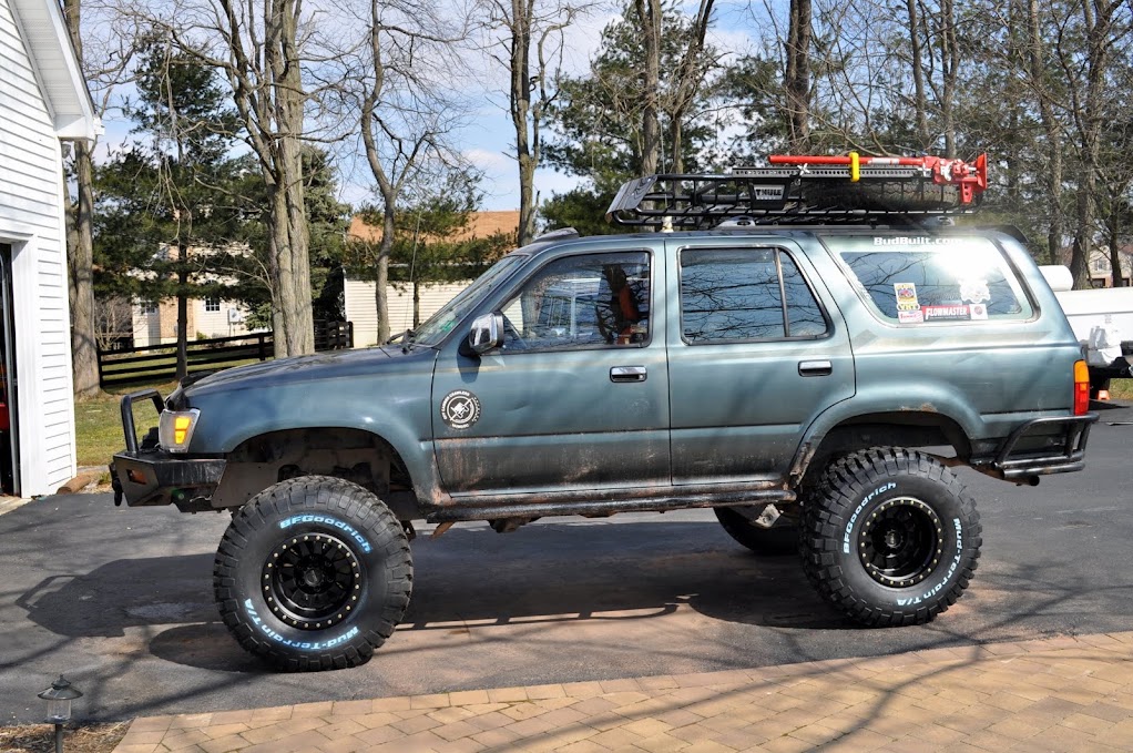

The good news - tires/wheels installed. Hi-Lift jack - installed.
Today - off-roading with some buddies from 'Off-Camber Crawlers' - VERY GOOD!

Breathers - on the to-do list - gear oil - DONE!
Oh, and put your skid plate back on. That's positively indecent.
Working on it. Going to do some changes to make it easier to take off-and-on.
