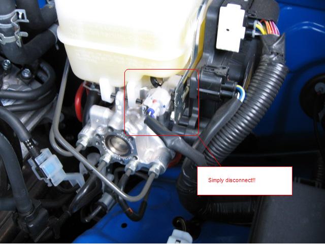

For all those who know, sometimes you dont want or need this activated (Sand,Mud, Ect...) Here's how you disconnect it. Keep in mind that you warning lights will stay on.(also Disables ABS so be Safe)

Yes, that's been posted before. Another option would be putting a switch inline with the power (or ground) wire in that connector and running it to the cabin.
I thought about doing it as a mod, but I've never really been in a position where I wished I could turn it off completely. I tend to just lock the differential and then I'm able to power out of almost anything.
But maybe I'll do it in the future....
Yeah i would much rather have that also but haven't had the time to figure out all the little details. Sorry about the repost but i just haven't seen it as easily detailed. just thought other might find it informative.
IIRC, there is also a pin on the OBDII connector that you can ground at or after startup, which will turn stability and traction control off until you restart. The process is meant as a service procedure to use when you're going to put the 4Runner on a dyno for an engine or brake check. It's discussed in the service manual.
You could buy an OBDII connector plug and rig up a switch, I guess. It would be easier than running something through the firewall.

I followed our colleagues directions above in post 1 and disconnected my VSC/Anti lock brakes over the weekend to play.
Wow, a V6 T4R will smoke both back wheels with a little motivation, well a little brake and a lot of gas.
unreal and way cool

so guys, does unplugging this switch really worked successfully?!
as i have tried taking off the ABS fuse last weekend but the result was NO brakes at all.
