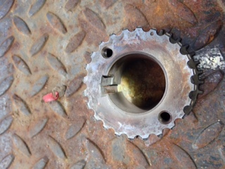

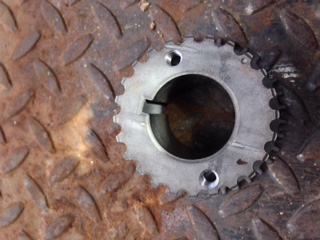

Here are the pics of the gear. Look at that groove it made. Removing the key was a tedious process to say the least. It was really set into the crankshaft.

Wow!
Good lesson for the us weekend mechanic apprentices! A generous helping of loctite maybe in order, on future TB/WP jobs! I just did 3 in the last 6 mo. and used an impact driver to on/off these bolts!:fear:
I'll keep an eye on mine... maybe if I have time this Winter (when my 4Runner is off the road), I'll give it a snug...... (and buy a torque wrench that will do 217 ft lbs!!)
Red LocTite is a must if reusing bolt. Toyota specs new crankbolt which comes with encapsulated thread-locker pre-applied. 250 ft-lb. torque wrench is a must for this job.
Had a look at the specs on my impact driver and it max. torque 240ft.lbs.... I hit it pretty damn hard... now for a new torque wrench and some elbow grease....
When I noticed in the FSM the bolt was a replacement item, I contacted my 2 local Toyota dealers and they told me it wasn't a stocked item. They also told me it would have to be ordered from California or Toronto??? (I live out west) go figure.
