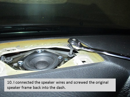

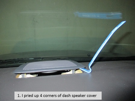

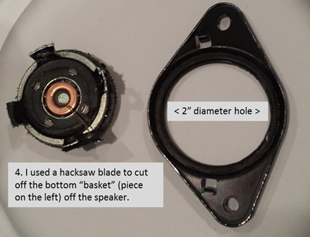

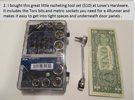

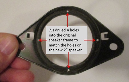

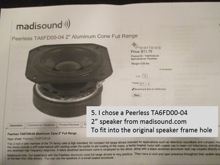

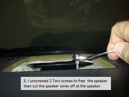

2003 4Runner Dash Speaker Replacement
My 2003 SR5 4Runner front dash speaker was in tatters and produced - at best - scratchy sounds. So I removed the speaker, cut off the speaker basket, dropped in a new 2" speaker into the hole of old speaker frame and then reinstalled the whole thing back into the original mounting in the dash.
Here are pictures.
Here are pictures.
Very nice, that's a lot easier than cutting the dash up to fit a 3.5" coax speaker like I did
