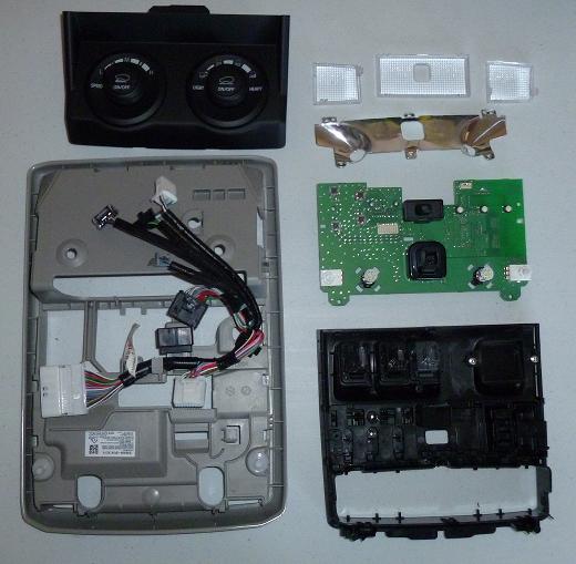

I already have the console down (and in parts) doing my variation on Antman's console lighting mod. I'm adding 5 LEDs, one for each Homelink switch and two for the moon-roof switches.

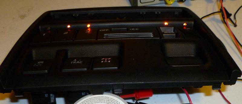

Below is my crappy pic of your console lighting mod I ripped off. The light on the left is as bright as the others but because it's recessed it doesn't look like it. I used 1.8mm orange LEDs, tied them together in parallel and through a 1.6K resistor to the rear diff lock switch's LED power lines (you can almost tell it's illuminated in the pic). That way I can disassemble everything if I need to.
NOTE TO OTHERS:
This mod is not for the faint of heart. While not technical, it requires a very steady hand, fine miniature modeling tools and skills and SMT soldering tools and skills.!!! Because of that, I'm not going into more detail than what's here. If you have the skills and tools, you won't need more than the idea, if you don't have the skills and tools I don't want to encourage anyone and have them trashing their console!!!
NOTE TO OTHERS:
Awesome! I am impressed- it is NOT EASY to get those LED's in there, and I only did one. Nice job man. :hatsoff:

Yeppers, it was a real PIA and test of my skills getting those LEDs in the little pockets between the switch area and the map light area. Then getting them at the right angle so they would shine through the holes onto the switches and not the rear-view mirror was interesting. It involved several dental probes, mini clamps, third-hands, tooth-picks and a mirror. I used a mirror to see where each was shinning while I positioned it then epoxied it down, wait for it to setup then on to the next one. Then wiring them together and to the existing switch plug required trimming the plug and fine (SMT) soldering so I could tap into the power while still letting the plug clip into place correctly. Took about 4 hrs in between mouthfuls of turkey and stuffing.
Ha! I was waiting for you to mention the rearview mirror. I spent a good bit of time "tuning" my LED too. Hows it look at night?
