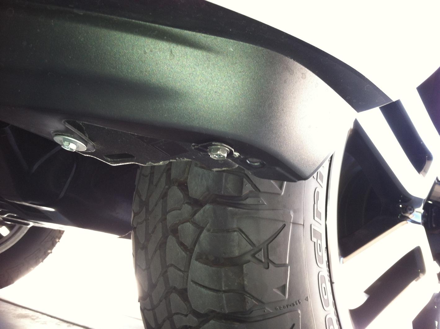

After installing 1.25 wheel spacers the tire rubs a little on the front side of the wheel well, front tires. Not much. I think if I heat the plastic I just need to bend it 1/2" or so. Of coarse I am bit nervous working on my baby. Any advice would be appreciated.
I did the heat gun a first, but after awhile it started to rub again. +1 for just moving the fender liners forward. About as easy as a mod gets!
Thanks guys! It worked great. Took me 20 minutes. Someone with just A LITTLE skill could do it in 10.

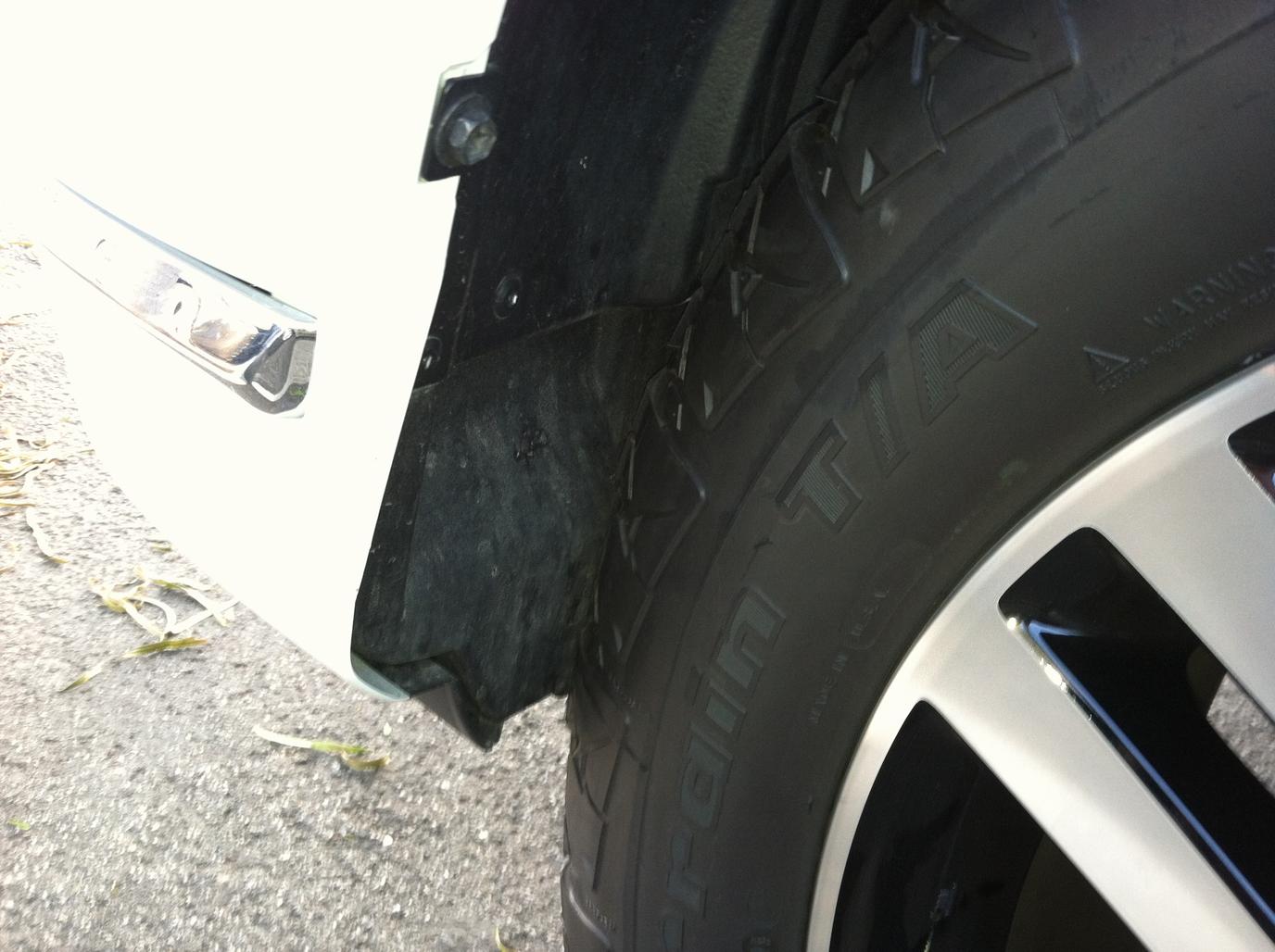

Picture is looking from the front of the truck as if facing the right headlight.
