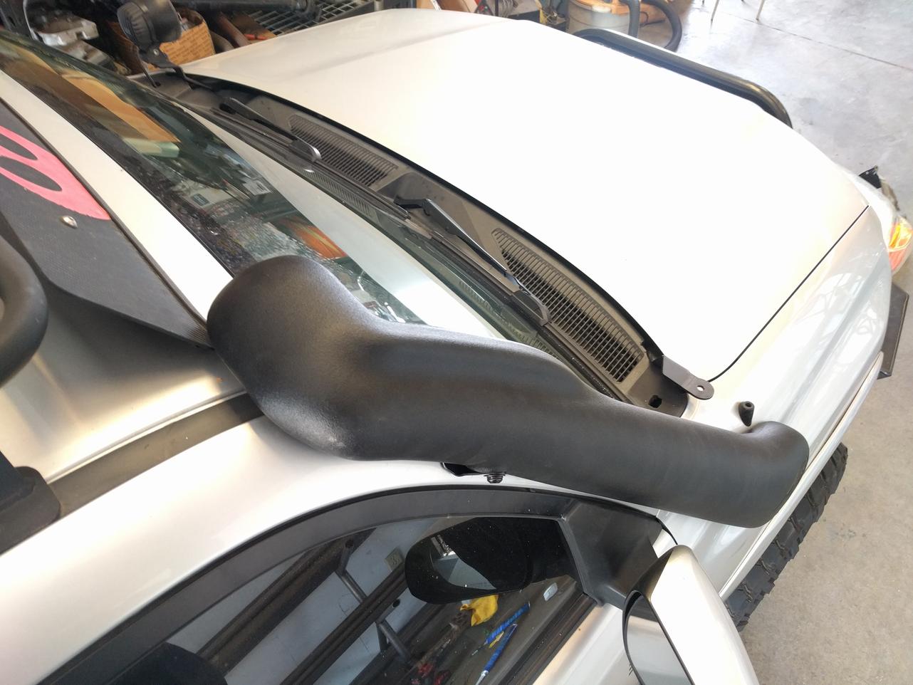

I’m gonna try to post up the shitty pics I have but it’s hard to do since my 4runner doesn’t get outside the garage if it’s over 68F.
I’ll try to explain in words:

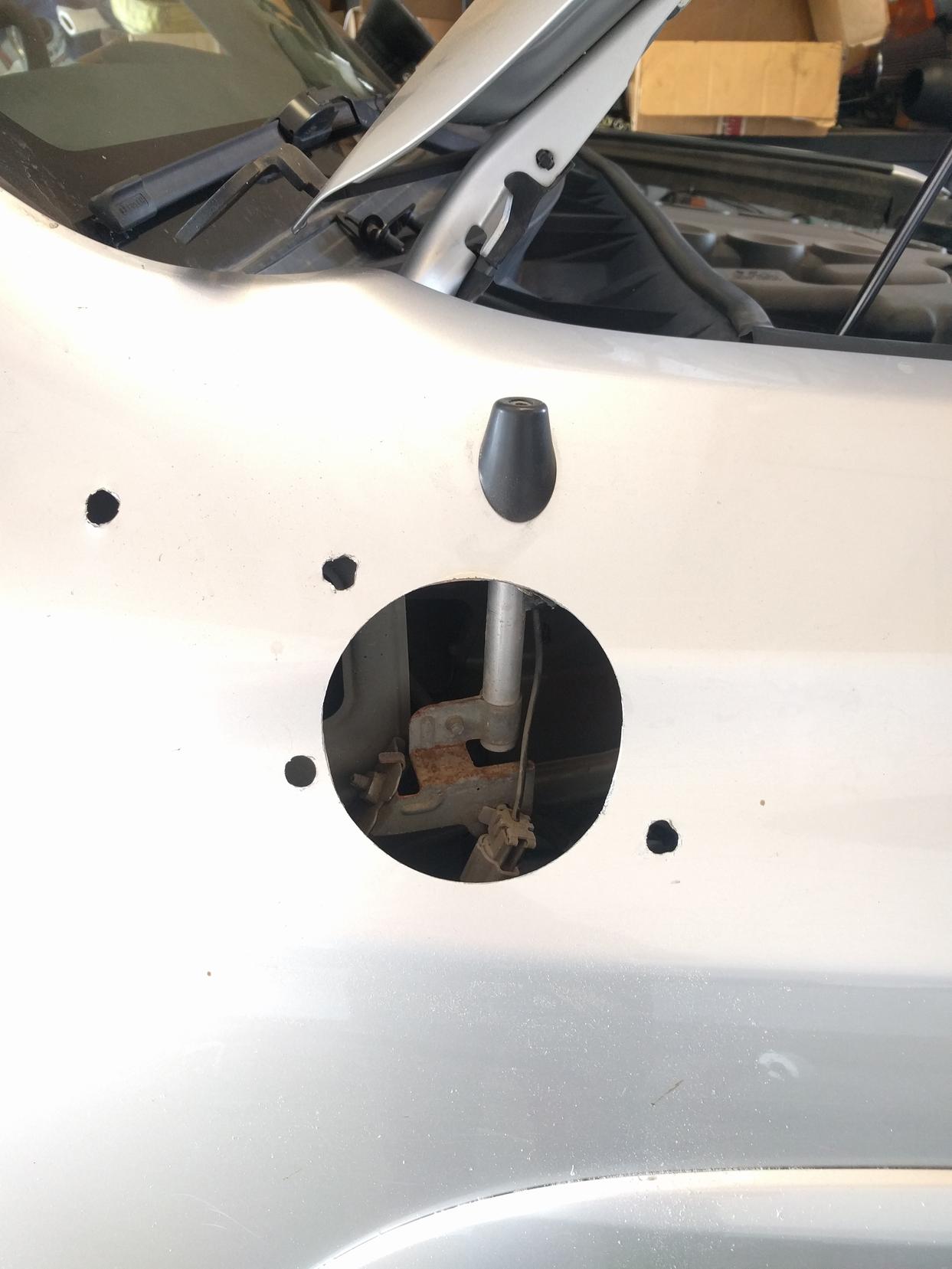

Snorkel goes thru fender.
Attaches into intermediate tube and is secured with a large hoez clamp.
The lower part of the stock airbox goes into the intermediate tube and there is no visible difference when looking at the airbox assembly thru the engine compartment.
Like I said, I’m keeping my rig bone stock and this low profile snorkel really helps.
If anyone wants they can borrow my 4.5” hole saw as long as they return it and pay for shipping . I didn’t end up using it cause it didn’t want to cut holes in my fender so it’s mounted on with magnets and double sided tape.

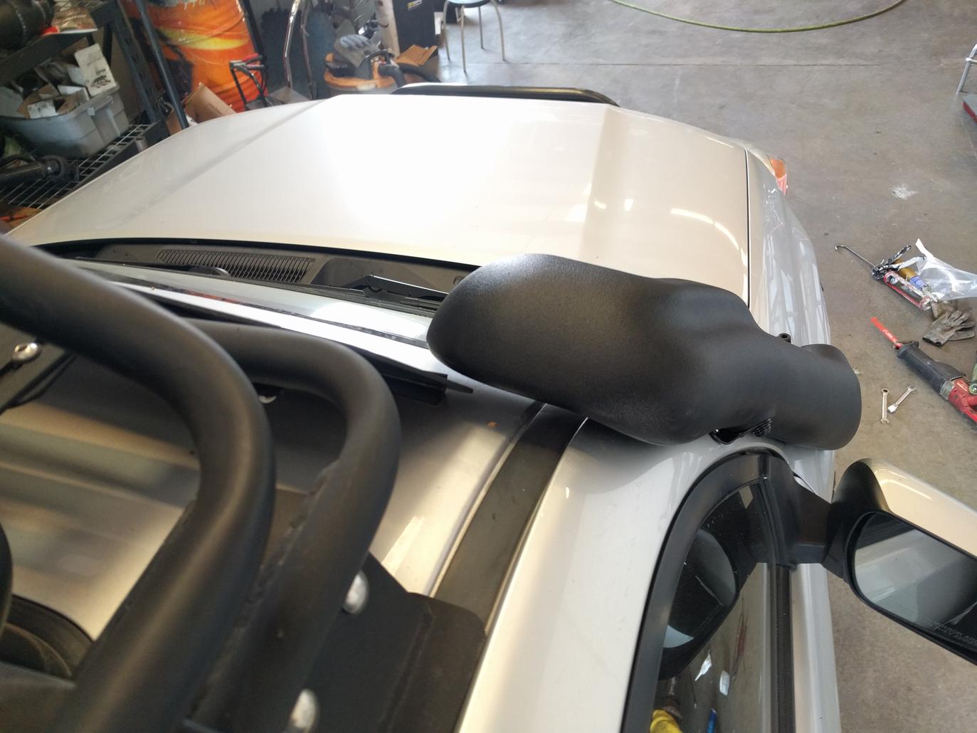

Fit to the contour of the fender is pretty amazing. Worst part is removing the fender liner and clips.
I wanted a clean look and install that would give me peace of mind, happy with this option.

I would argue that my safari snorkel has much cleaner fender fitment than that. Could just be the pics tho.

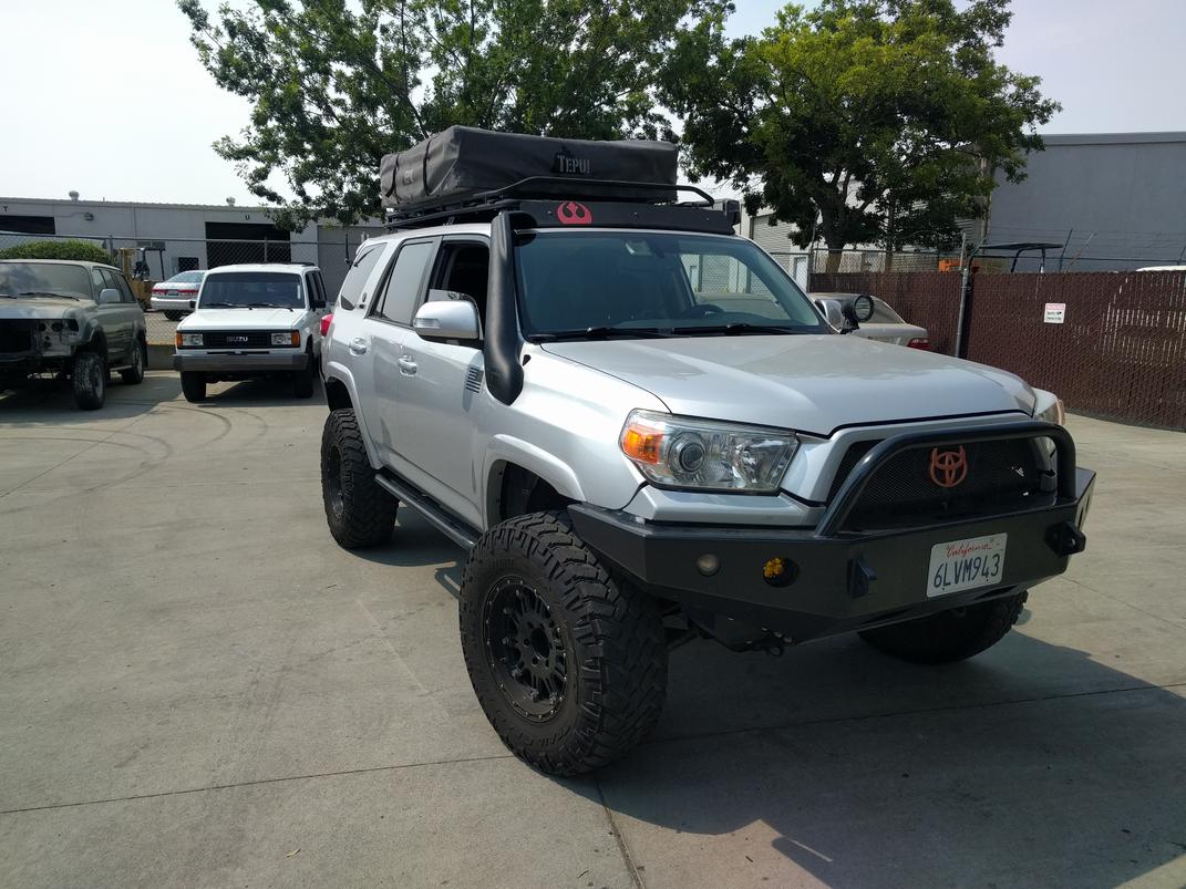

Getting my TJM snorkel installed currently. It has been verified for us pre refresh guys you WILL loose your antenna. No a big deal for me (too late to go back) just use the iPod like I always have.
Guys at [MENTION=245329]CaTunedOffRoad[/MENTION] have been great. Pictures to follow.

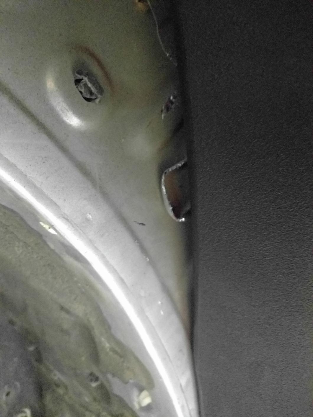

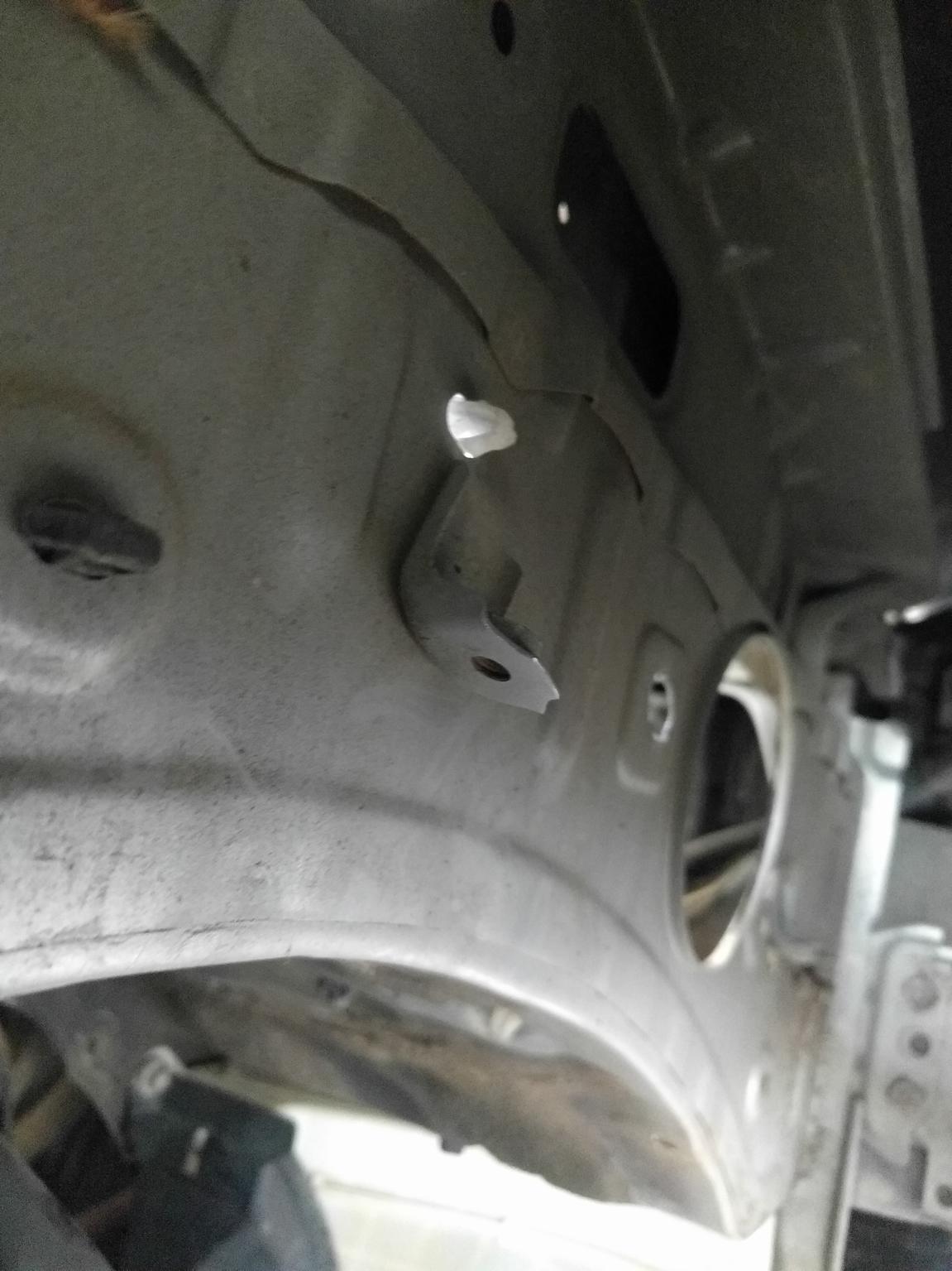

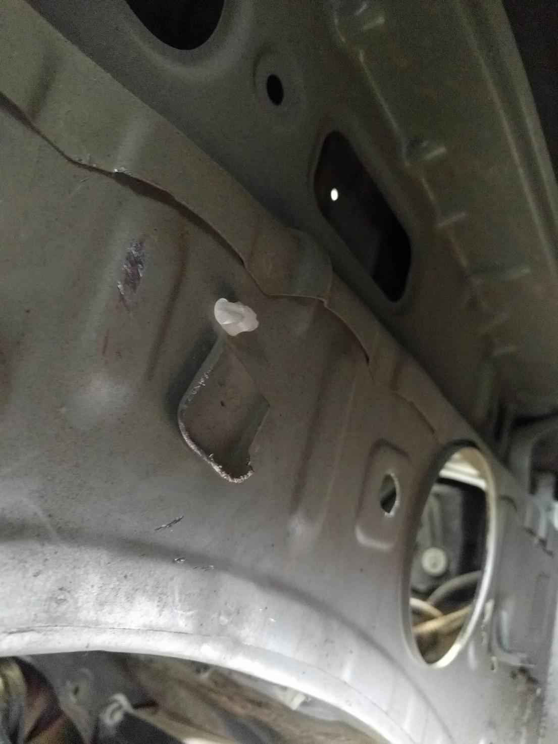

Hello everyone, we just wrapped up an install for [MENTION=49966]mikey's2010SR5[/MENTION]
and we'd like to share what the install process generally looks like. Unfortunately the antenna has to go, but only the AM Radio seems to be affected. I've included pictures of a fender liner tab that will need to be cut off in order to seat the intermediate tube inside the fender.
