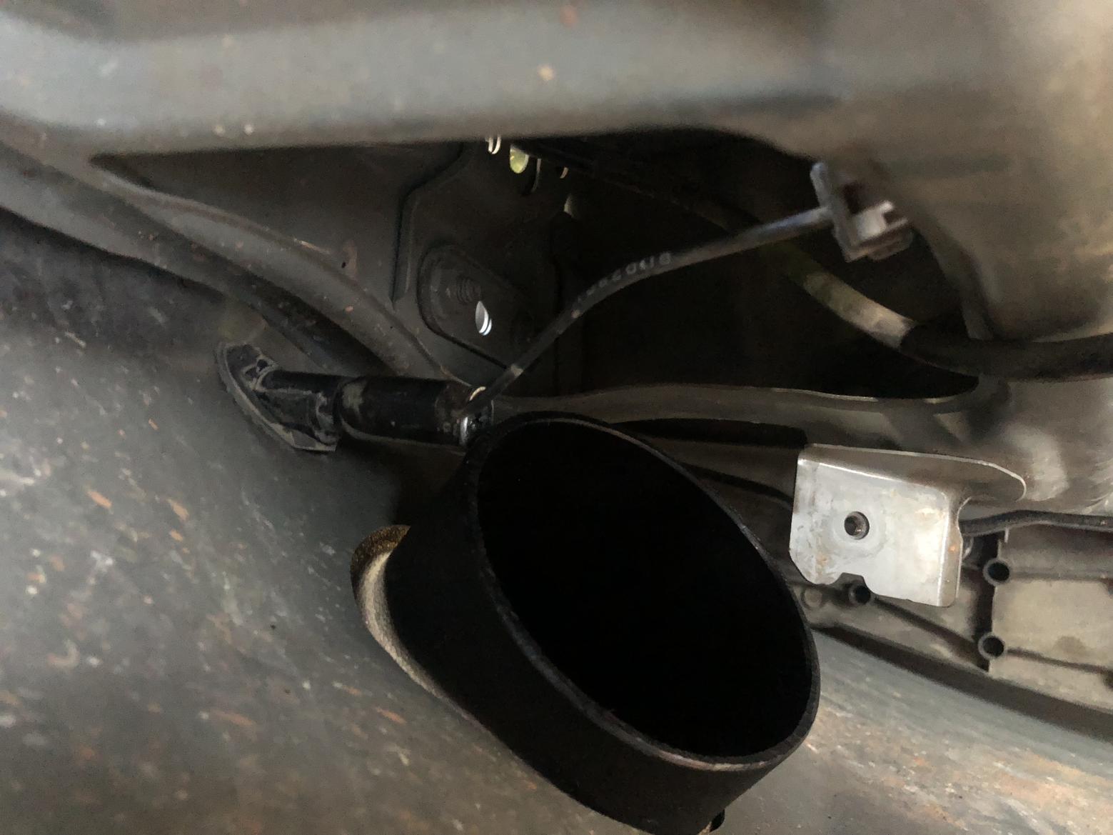

and we'd like to share what the install process generally looks like. Unfortunately the antenna has to go, but only the AM Radio seems to be affected. I've included pictures of a fender liner tab that will need to be cut off in order to seat the intermediate tube inside the fender.

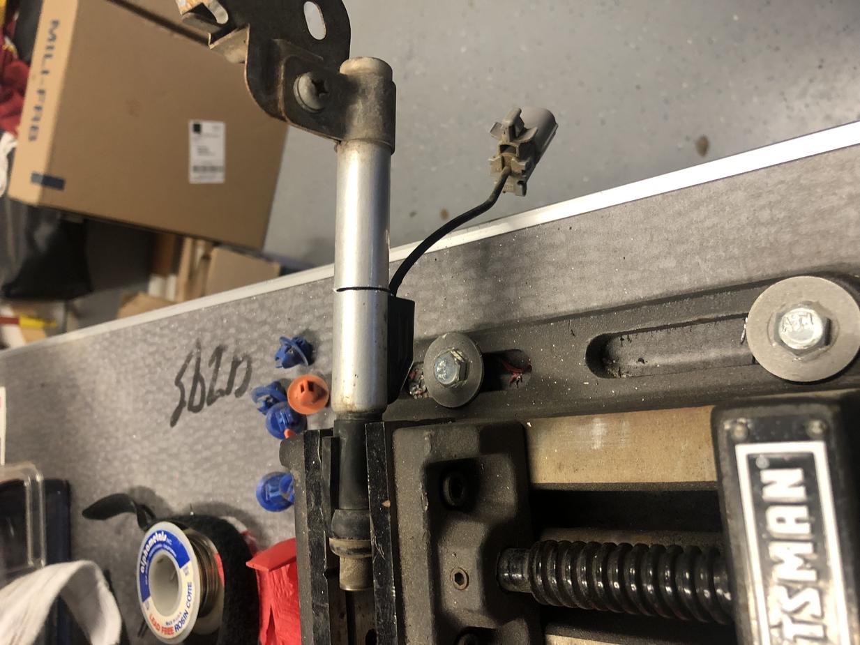

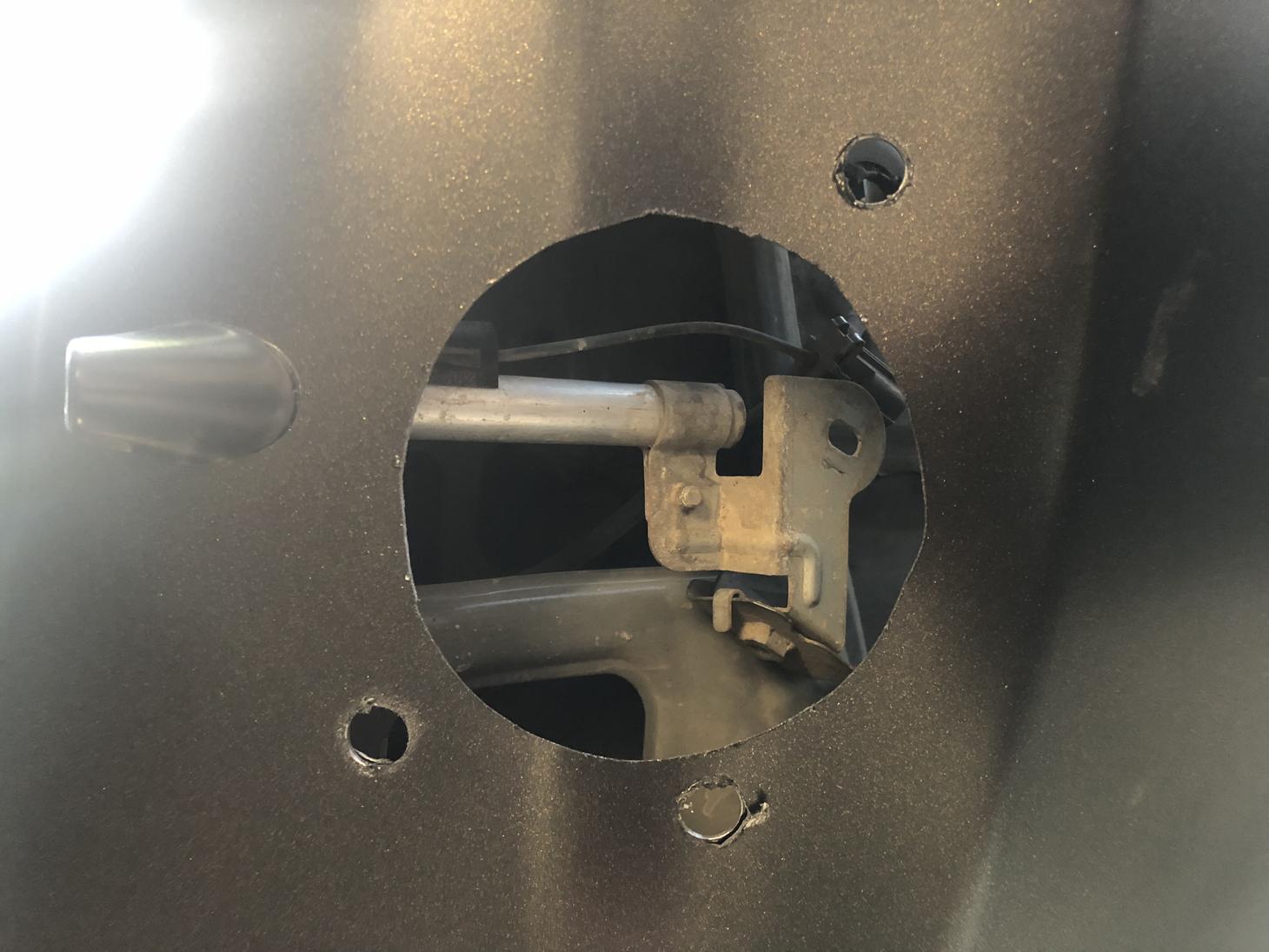

So there is a way to maintain the stock antenna. It’s a slight mod and the inner air tube will fit with no problems.
[MENTION=245329]CaTunedOffRoad[/MENTION] I’d be happy to chat and share for your future installs. But in short, you cut the antenna base and reinstall without the bottom mount. I ended up using silicone to hold the base up by ultimately, the tube will hold the antenna up. To help with seating it, I used an appropriate sized washer on the antenna side to help “hold” the base in while the silicone seals.

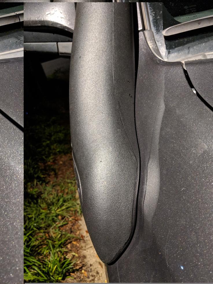

I would argue that my safari snorkel has much cleaner fender fitment than that. Could just be the pics tho.
Nah, its just the pics. It fits the fender the 5th 4R, Prado or otherwise.
Have driven through multiple hard rain storms. No water in the air box.
