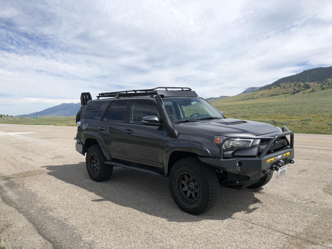

I installed one of these last weekend on a Limited. I was impressed with the fitment and how easy it went on. A quality kit for the price. My 4R is to the left with the ARB for comparison.
