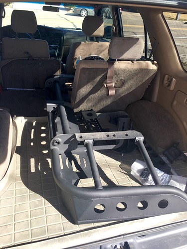

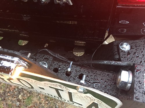

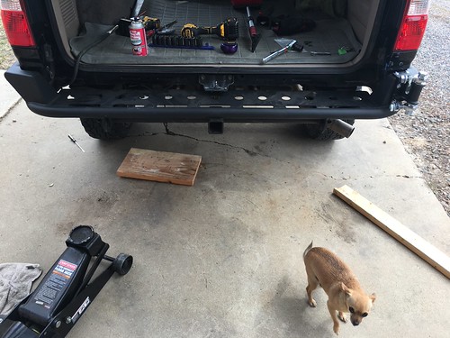

Bumper and carrier were powder coated at Custom Coatings up in Berthoud, CO. They do really nice with a pretty quick turn around.

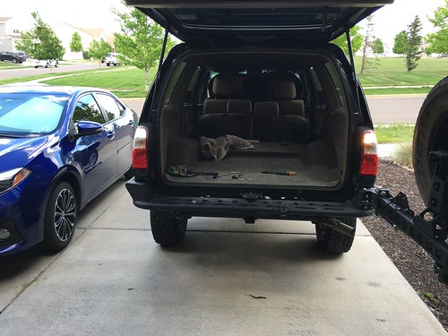

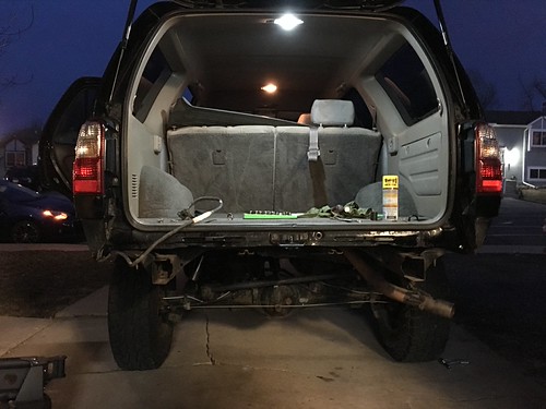

Some shots from the bumper install.

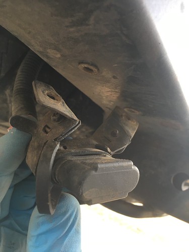

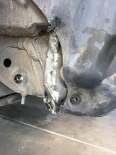

First things first, remove the trailer light wire from the bumper!

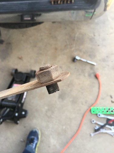

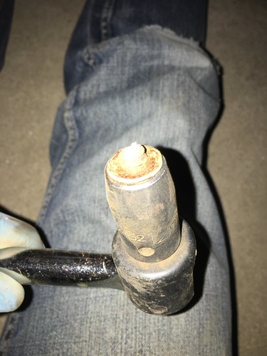

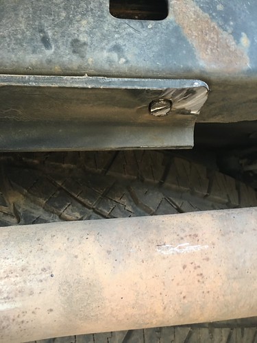

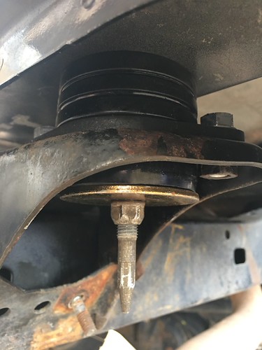

This bolt wasn't going for it so.....

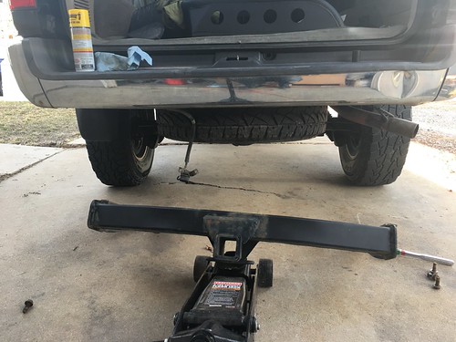

Dropped the old hitch. It's pretty heavy so used the jack to hold it in until I removed all the bolts.

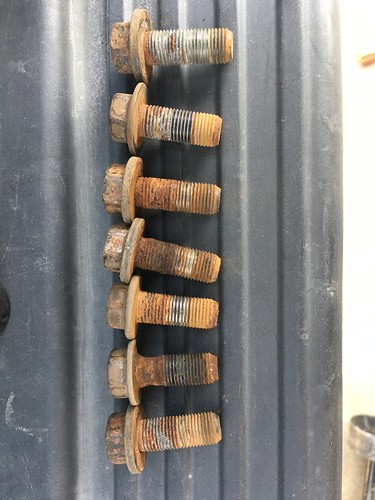

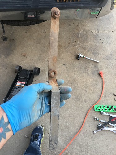

More pics... Those 21 year old bolts looking rough.

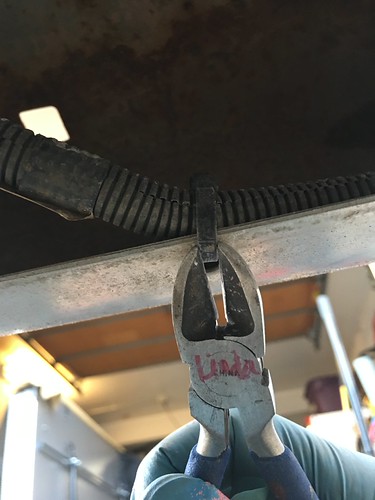

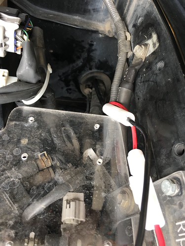

Don't forget this wire loom on the bumper before dropping it.
Another casualty :
It's pretty straight forward to take the rear bumper off. PB Blaster is your best friend!! Soak everything overnight and even then, its a good ideal to have an angle grinder on hand... if you don't have one use this an excuse to add it to your tool collection!
Next challenge :

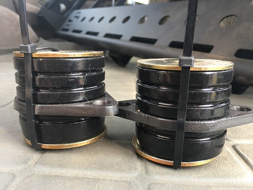

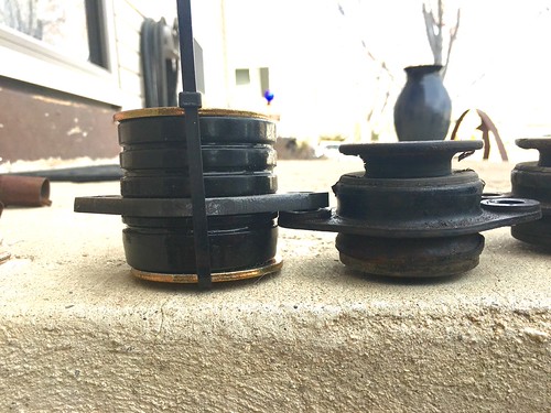

Sonoran Steel Poly Body Mount vs Stock:
I had to use shorter bolts to fit in that tight space. Ace hardware for the win.
Bumper mounts up so easy. Not a single issue!
Zip tide the license plate wire to the tire carrier with enough slack to fully open.

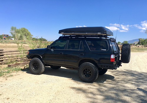

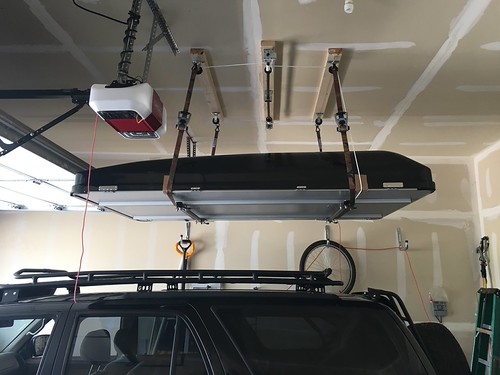

Also, after a fair amount of research, I too put the iKamper atop my list. I plan to haul it on a utility/camping trailer instead though. Kudos on the pulley set-up! Nice. I was envisioning something just like that, but for a carport that I still need to construct as my garage door opening will be too low...

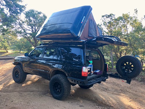

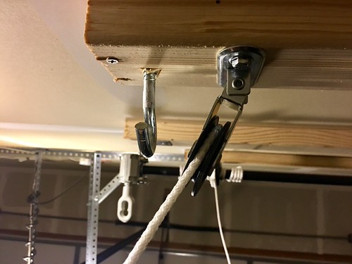

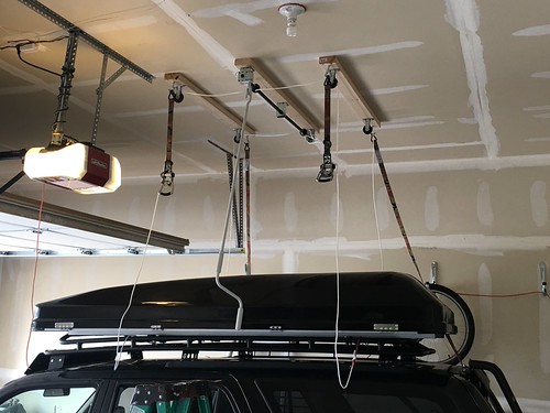

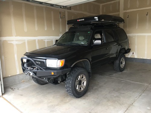

I jumped on the iKamper via Kickstarter... it took forever to get it but I'm glad I did it. It wouldn't fit in my old garage so sat on its side all winter. Then it lived on the runner for a few months until I moved and bought a new house in March that had a bug garage.
The pulley system is awesome. Needed to add some length to the stock rope and off course some huge heavy weight straps to hold the weight up there.
I added an Exped megamat Duo 10 for sleeping and it is awesome... unfortunately can't close the lid with it full of air... but I've got air on board so not biggie.

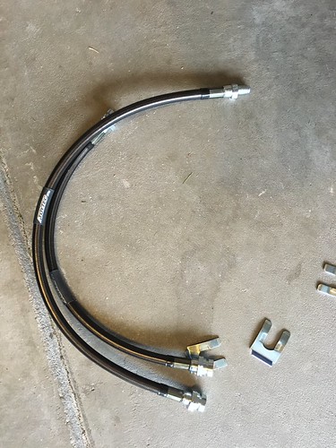

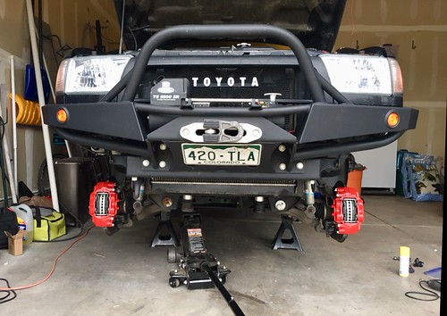

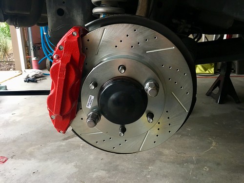

TBU - pedal isn't 100% where I want it. Bled several times, did the haul ass and stop the brakes to engage the anti skid... still not quite there. Stops no problem but the pedal still bothers me a little.. It feels different.
Extended rear lines (Toytec)

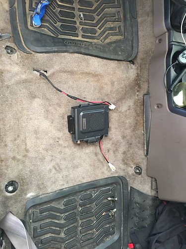

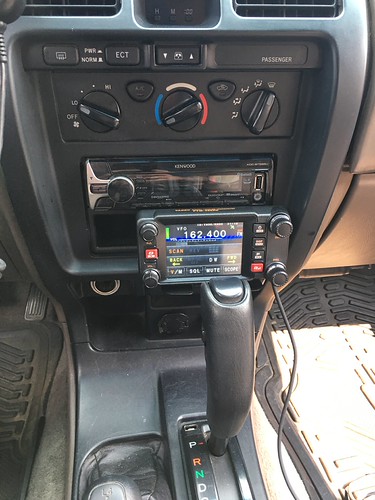

HAM
YAESU FTM-400XDR
Made a tiny little hole in the firewall grommet and fished this thru:

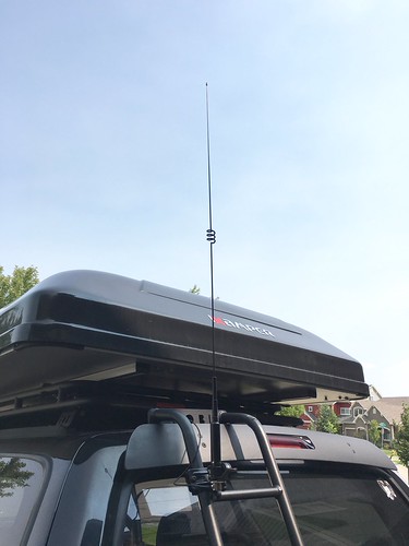

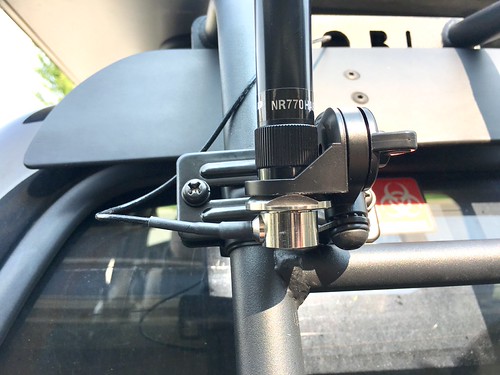

Ladder mount :
Antennae folds and swivels so I can open the hatch with the kamper on and back into the garage.

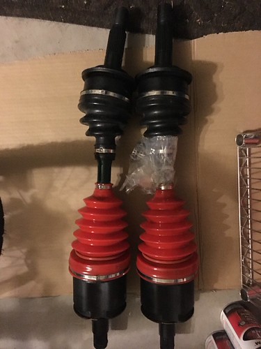

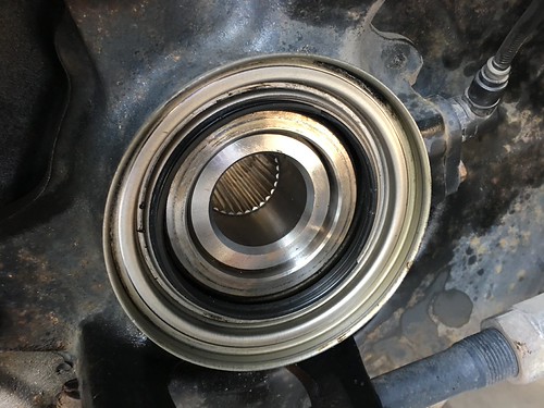

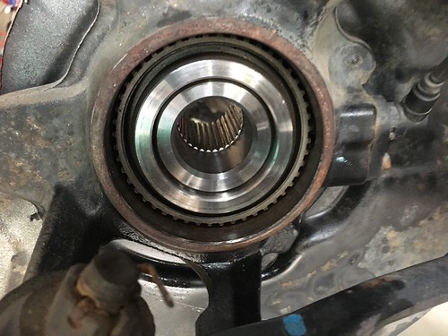

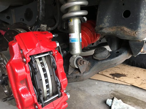

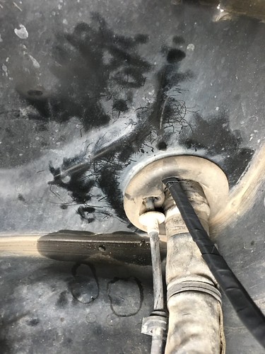

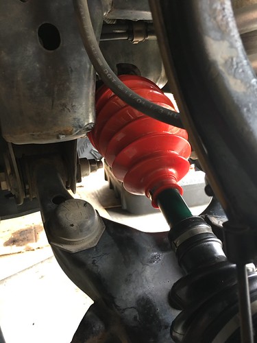

Leaking seal on the hub so replaced it and also went with long boot CVJ CV axles.
Was a bit tough to get the seal out. Here it is all cleaned up :
CV's
Pop this out with a crow bar:
Installed
