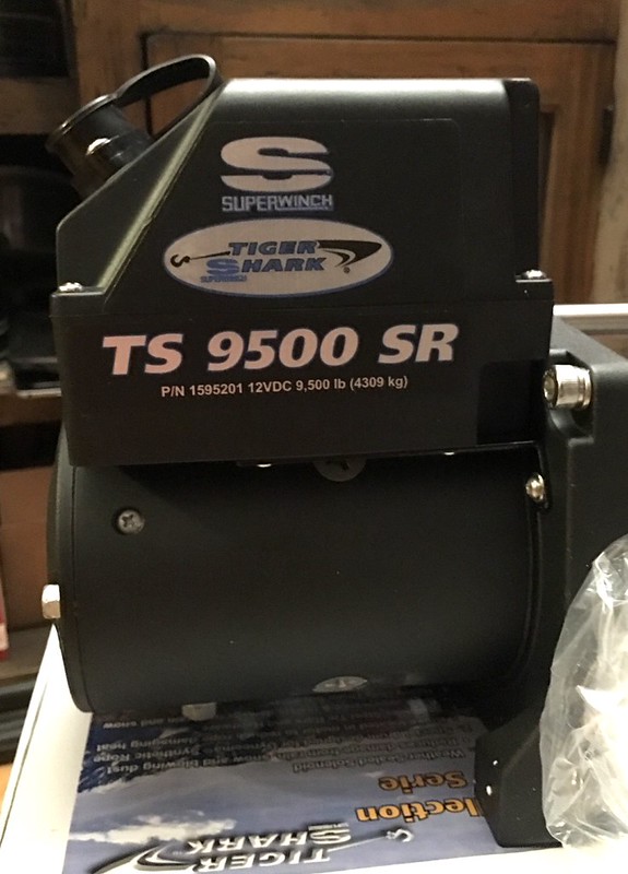

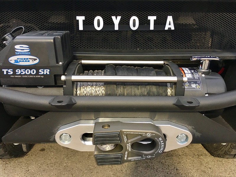

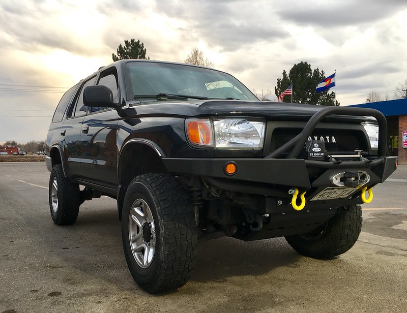

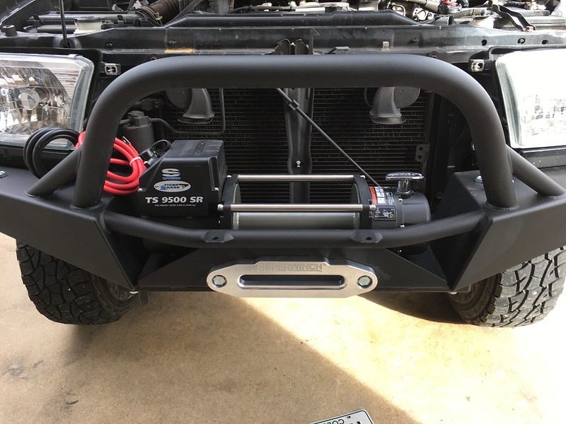

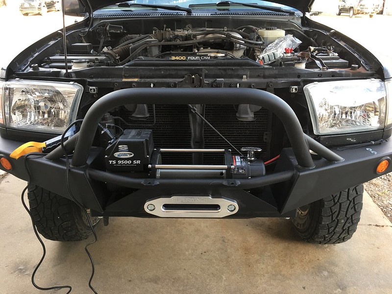

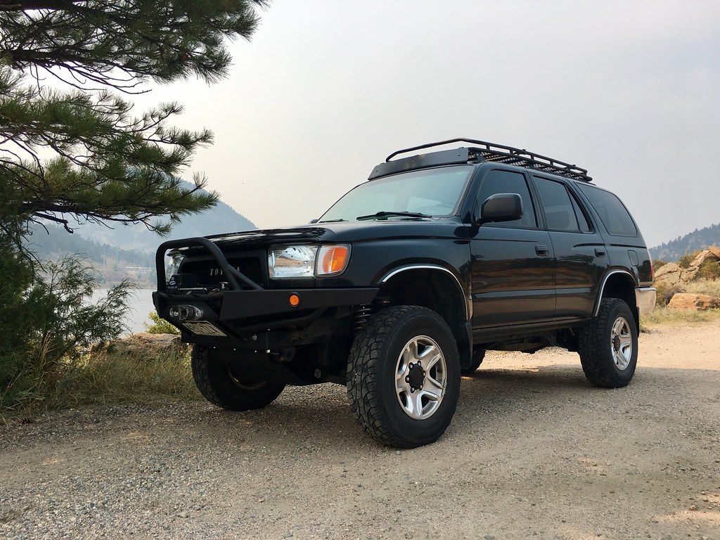

The replacement Tigershark has arrived along with a little friend
https://flic.kr/p/XNa73vhttps://www.flickr.com/photos/152444593@N06/
https://flic.kr/p/YLJEpmhttps://www.flickr.com/photos/152444593@N06/
I had to get shorter bolts for the fairlead so that the winch would fit. Stock Superwinch bolts were too long to work with the AOR space provided.
https://flic.kr/p/XJBrBU https://www.flickr.com/photos/152444593@N06/

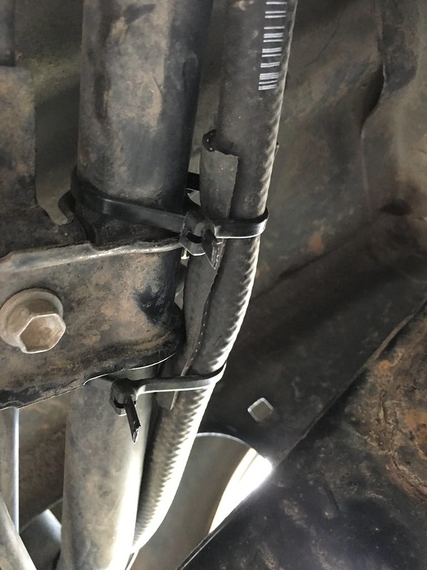

Cables nicely routed and ready to go wind on this line with proper tension...
https://flic.kr/p/XJBrEj https://www.flickr.com/photos/152444593@N06/
There is a car wash by me with a huge parking lot and some heavy duty lights in big concrete pillars so I rigged up on that, spooled out, put on the parking break and slowly winched the line in under steady consistent tension. It's nice and even on the drum.
https://flic.kr/p/YqJgxh https://www.flickr.com/photos/152444593@N06/

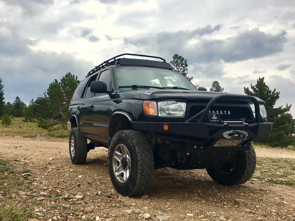

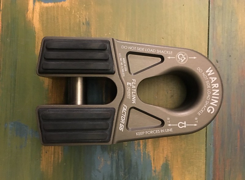

Got a sweet deal on a TJM recovery kit.... hence the yellow bow shackles.. only on for the photo op, I just carry them in the bag.
https://flic.kr/p/YLJQyE https://www.flickr.com/photos/152444593@N06/
and replacing the body ground with a 0 gauge (overkill, if I do the rest of the big 3 I'll use high quality 2 gauge)

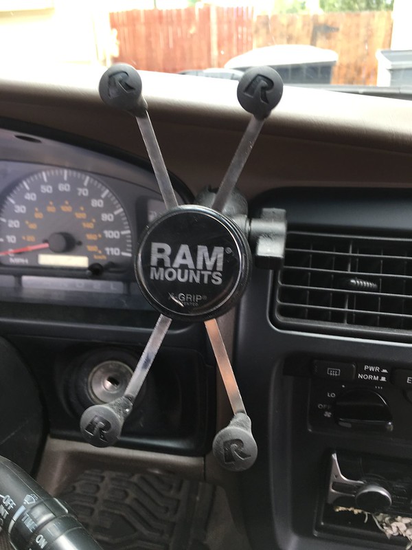

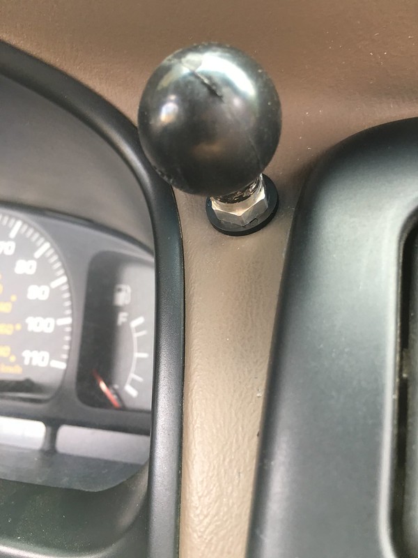

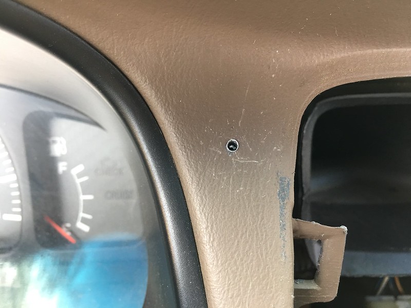

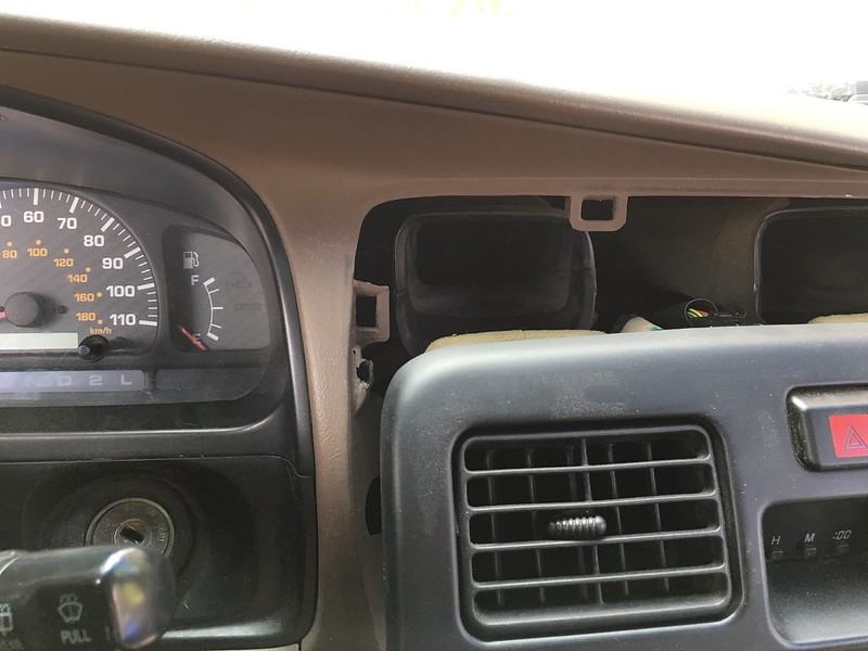

Ram Mount Dash Install & Strong-arm upgrade

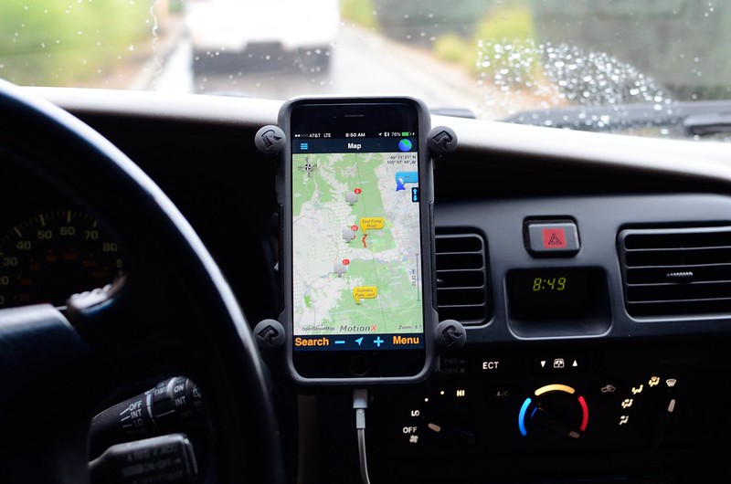

Read this on here somewhere and decided to go ahead and give it a shot so I could mount my iPhone 6S somewhere usable without obstructing view. I use Maps & MotionX-GPS for offline for navigating in the back country.
I took a map class once and would like to start getting familiar with maps and compass again... maybe in the spring.
https://flic.kr/p/YK1xKU https://www.flickr.com/photos/152444593@N06/
Pilot hole... I forget what size I actually drilled this out to
https://flic.kr/p/YK1xMh https://www.flickr.com/photos/152444593@N06/
https://flic.kr/p/YK1xR5https://www.flickr.com/photos/152444593@N06/
Doesn't move at all on the street. Moves a bit offroad as to be expected but no way is it ever coming off of that mount! Phone is held in super tight!
https://flic.kr/p/YK1xPm https://www.flickr.com/photos/152444593@N06/
Ram Mount in action

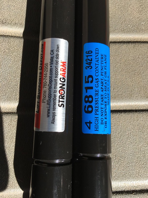

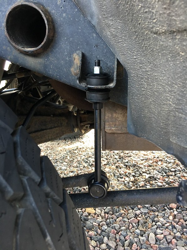

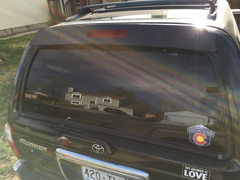

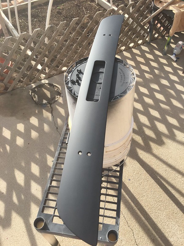

Rear lift gate, Strongarm with extra opening power upgrade - totally happy with these. They lift the Gobi ladder no problem.
https://flic.kr/p/YK1xVd https://www.flickr.com/photos/152444593@N06/

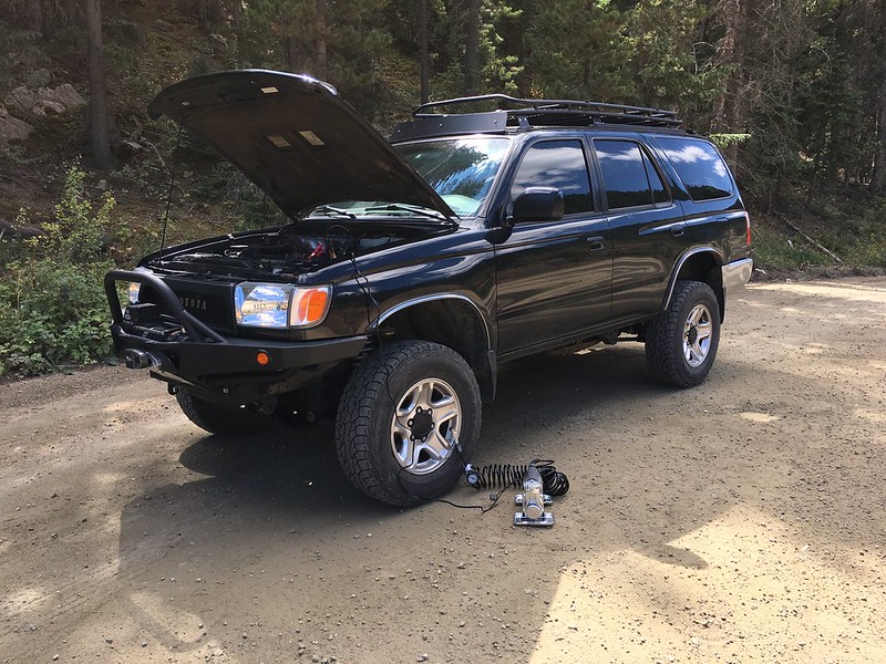

Airing down for Mammoth Gulch ascent
https://flic.kr/p/Zz5PGC https://www.flickr.com/photos/152444593@N06/
