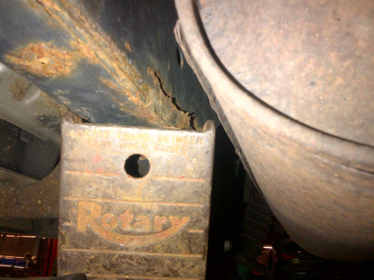

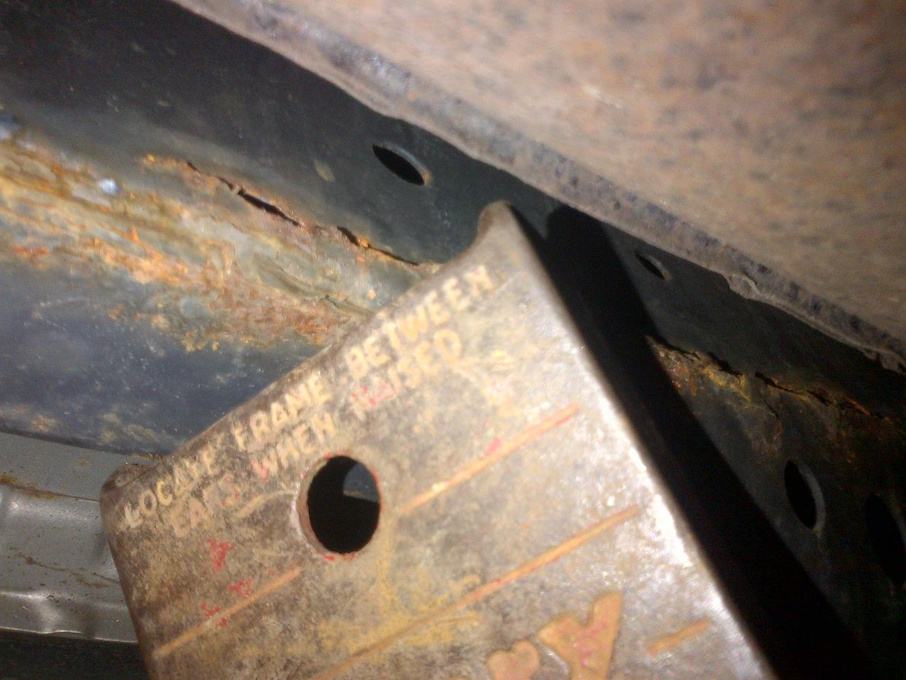

Just thought I'd put my pictures up.
I bought my Runner almost 2 years ago from original owner from Westchester County NY. Body is mint and frame didn't look bad.
When I did all the maintenance I was doing to it, I put it on the lift here at work and scraped and wire wheeled the frame, and finally painted with first a rust treatment, then top coated that with some chassis frame paint from "Eastwood".
Drove thru winter cleaning it any chance I could. (once a week or more) Payed close attention to the holes in the frame to spray water in them to clean the inside out the most. I had a Taco buyback so I was aware to clean the hell out of this one.
Cleaned the hell out of it in the spring before I put it away for the summer.
Took it out this fall and put it back on the lift at work to check things out before winter and it looked like i never even touched it last year.
Plus I found these nice presents (pictures).
Looks like the frame is rusting just like my Taco did, from the inside!!
Am I pissed off at Toyota, no. I will be buying another Toyota someday. I'm just a little saddened at the whole situation. In the coming weeks I will be welding a nice plate on my frame so it's good for as long as I own the Runner
