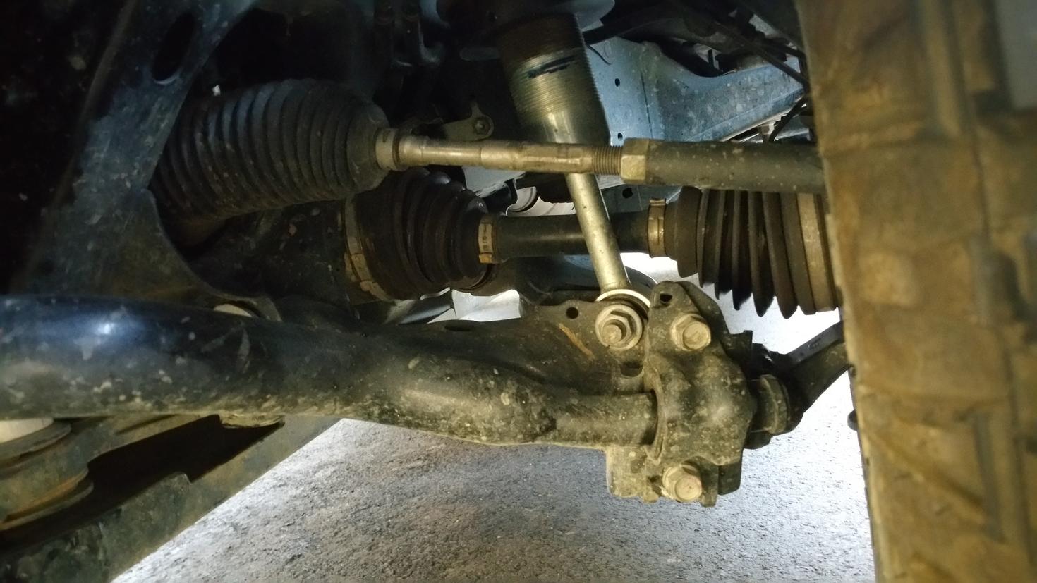

Been running my lift for almost 5 years with no drop and not one CV broken or boot torn.
I run a diff drop..Have been in all my lifts I've done. When I installed my Shrockworks underbody armor we ran into a problem and i had to add spacers for my skid plate. I know I can run it without, but I am happier with it. Here's a picture of my CV angle.
