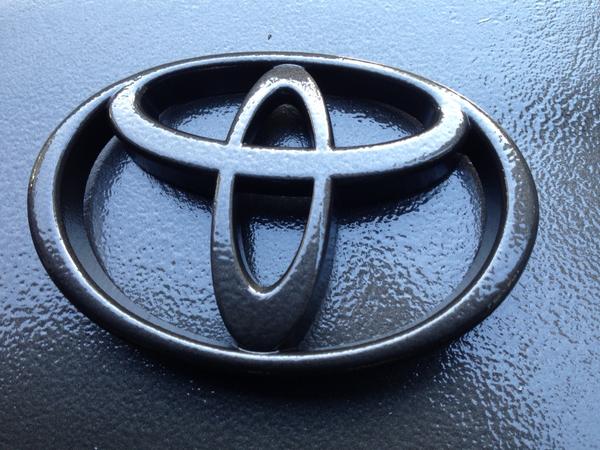

And before I put the grille back on, I decided to paint the Toyota emblem with some extra black hammered paint.

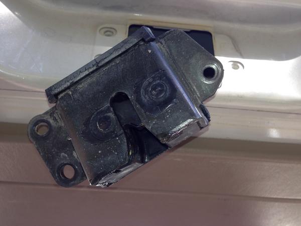

I'll close with some futility though. That dang rear cargo light... I thought I had fixed it, so much so that I even added it to my completed list earlier in the day. There is something in this catch, or very nearby, that is not operating properly.
I first shot some brake cleaner in there and quite a bit of crud came out. While do so, the light came-on. I was on a roll! The kids who were sitting in the back were excited too. Opened and closed a few times, and it worked flawlessly. I then decided to check an hour or so later, and it wasn't working again. :ybrick:
I wonder now if I'll need to remove the back interior panel to see what's going-on. If anyone has input, please do share.

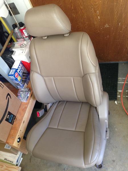

Four 14mm bolts and a wire connector later, and I removed the driver seat.
The seat as you see it, 50 pounds, almost exactly. I will need to remove the seat belt receptacle to use with the Corbeau, so call it 49 lbs...
The weight delta, a nice side benefit, should be decent, at about 15-20 pounds per seat.
The carpet is quite clean, but I'll do some cleaning before installing the replacements, which should both be here by next week. It seems that I'll install the driver one first as the passenger bracket will need a few more days...

The stock seats are in great shape. The electric adjustments work just fine. I even made two short videos of them operating, as I plan to sell them. Any idea as to what these sell for?
