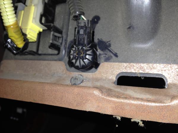

On that glove box bulb, I decided it best to simply remove a few screws to get better access to the bulb. Much easier to pop-out the bulb housing from above:
From no light, to quite a bit...
Geez, more rust here than on the underside?!
2 screws to remove the glove box and my world was a better place when it came to swapping that bulb out.

Sounds like I might have removed more screws than necessary. The top piece of the glove box is separate from the walls and door. The top piece being out is useful here...
The rust bothers me though, so I will take it back off and use some steel wool, possibly followed with a light coat of spray paint.
