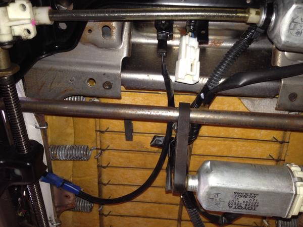

Just follow the wiring back. There should be a pressure sensor attached to it somewhere. You'll need both the pressure sensor and seat belt wires re-installed to keep the light off. I'm sure there's a way to remove the pressure sensor but you'd have to test it's resistance then get the correct resistor wired into it. I've never looked at the 3rd gen system so I'm curious what you find. Post some pics later.
Took a few pictures, but this is the only one not over-exposed.
The top of the photo is the leading edge of seat....
The sheathing with blue tape, on the left, contains the wires connected to the seat belt receiver. That goes to a small black connector.

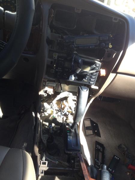

While I should have time for some updates this evening, a quick question for now...
On the auto climate control, I forgot, but are those those three buttons supposed to be lit (OUT/T, MODE and OFF)?
The green NEO4s are working the display wonderfully, but I can't tell or remember exactly the role of the NEO3s, other than it being for buttons in general... I got white on those, but green were installed.
Thanks.

Just confirmed those buttons do indeed light up; and white is not the way to go with those... So, just ordered two NEO3 greens.
Before I got to the unit, I guess I was rushing too much...
I don't see this for sale, at least at Camelback. Damn. Maybe a salvage yard item... Kicking myself over this one.

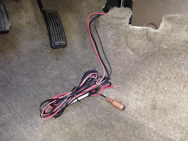

Oh, I was able to get the backup camera lines run back to behind the rear seats for now, ready to be connected to the new head unit.

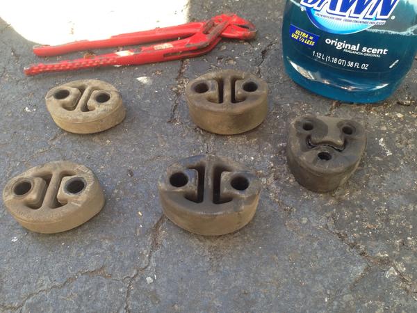

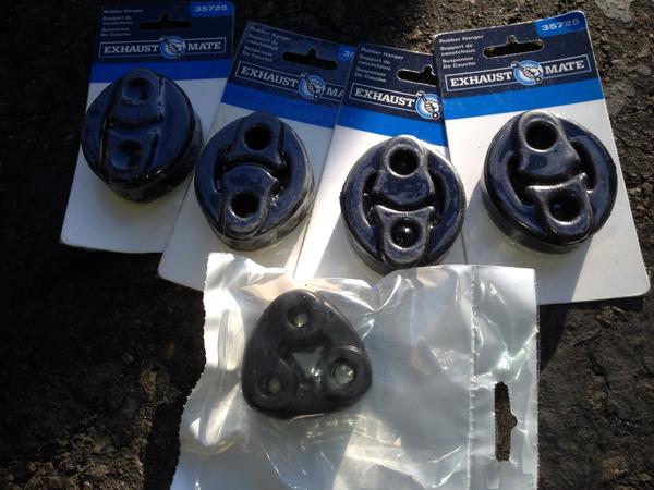

Got the factory muffler insulators out and replaced, of course one-at-a-time. While in the middle of doing so, on a dang cold morning, at least by CA standards (on driveway, no jack stands), my phone rings. I answer it under the truck and it's a local muffler shop (A-1 Muffler in Morgan Hill). I had left a voicemail asking if they were open this week. John there said "yes" and that he has a slot at 11 am. He said that he would have put the new insulators on for me, but I was already almost done...
Of note, the insulators for the muffler are thicker than those for the cat. Same dimensions otherwise, but for those ordering, it's three different types. Here's a photo of the five factory ones removed, in order (for cats, muffler and tailpipe):
The ones behind the muffler were the most difficult, but not all that bad. I'll likely replace those with the proper larger ones later...
I won't be in much of a rush to do so because the Borla muffler is about half as light as the OEM one. Weighed at the shop, a little over 24 pounds. The Borla is tad less than 10 lbs out of the box. With small sections of pipe added, and hangers, call it about 12 lbs.
