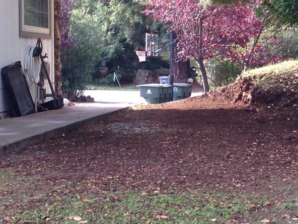

A little more excavating, then I can park the Runner back there. I don't want the sun pounding on the new seats and rear seat cover...

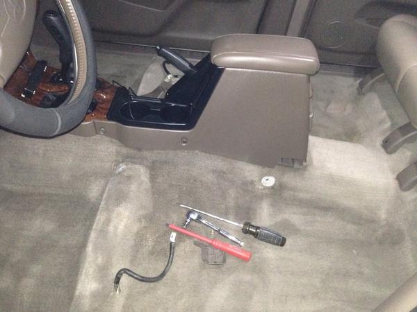

Oh, today, besides the excavation work on the side of the house and cleaning the carpets, I did the "grey" wire mode, or more accurately, the blue/red wire mod that permits the factory rear locker to work in all modes, not just 4 low.
I didn't try it though. I have no seats installed! I grounded the blue/red wire coming-out of the white connector that plugs into the black box. Seems to be the right one...

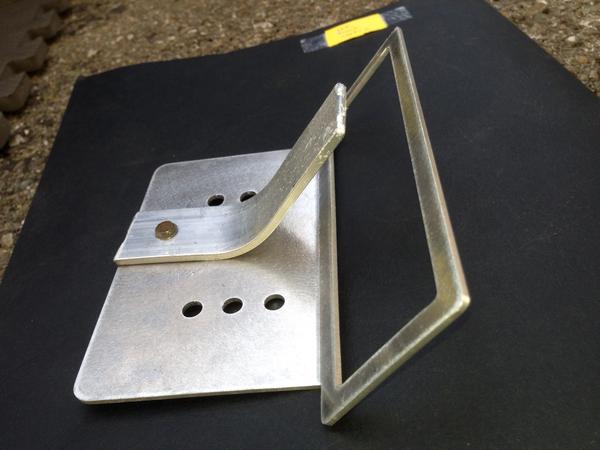

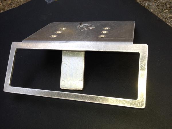

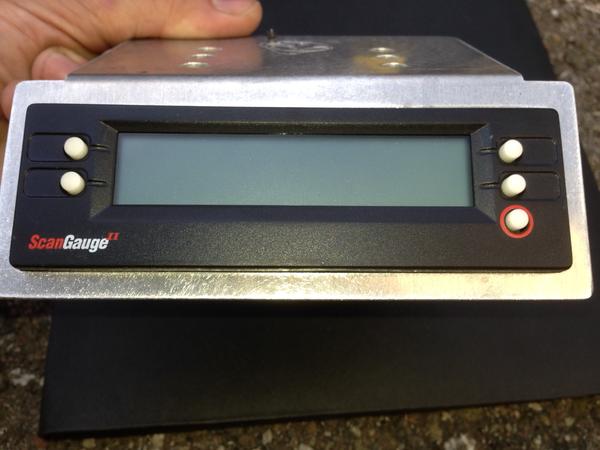

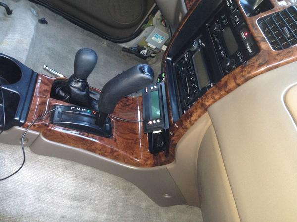

As I might have mentioned earlier, I got the Paranoid Fabrications ScanGauge II ashtray mount. I added an aluminum strip in the back, bent to the correct angle. JB Welded together...
With that backstop in place, the SC2 sits like this:

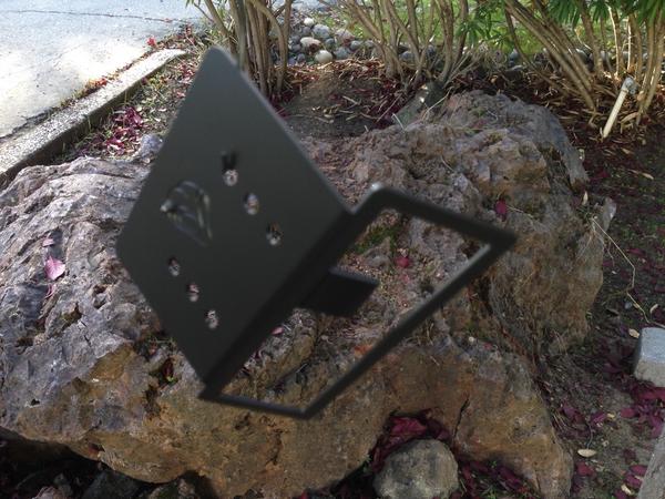

Once I got it the way I wanted, I suspended it and painted it a flat black...

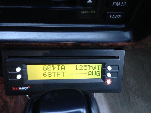

It's angled upward quite nicely:
I didn't know we have a light in the ashtray area! Couldn't figure-out what was keeping me from removing the dang thing. I put an LED bulb (#74) in there, and boom - light. Bright white though. I imagine there might be a green sleeve, or other colors to go over such a bulb. Open to suggestions...

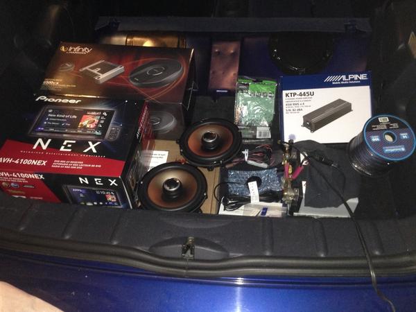

I've been keeping this stuff in the back of my MINI. I must admit, I feel a bit intimidated with this install...
What all is there?
Head unit - Pioneer AVH-4100NEX
Wiring harness connector - Metra 70-1761
Amp - Alpine KTP-445U 4-channel Power Pack, under dash in factory amp location
Front speakers - Infinity Reference 6500CX, component
Rear speakers - Polk Audio DB651, coaxial
Sound-deadening material - Noice 80 mil butyl
Speaker wire - 14 AWG
Backup camera - Pioneer ND-BC8
Not in the photo, various wiring connectors, heat shrink, etc...

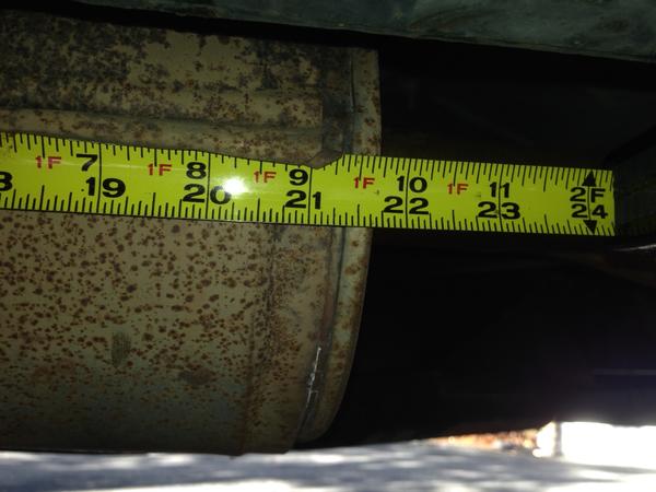

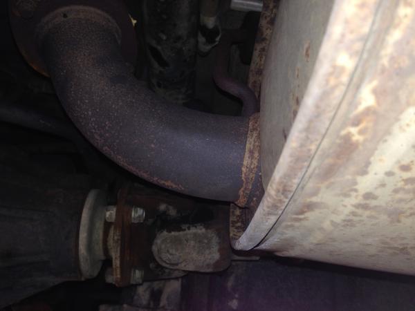

As seen in that thread [MENTION=115347]gamefreakgc[/MENTION] had some really good info about the length of the muffler needed, and the offset. Here is the measurement of the stock muffler case or body, about 21 3/4":
Practically no straight pipe at the exit of the muffler:
I'll be replacing all five of the rubber hangers or insulators. This thread helped me quite a bit - http://www.toyota-4runner.org/3rd-gen-t4rs/248389-factory-rubber-exhaust-hanger-insulators.html.
I was going to cut this myself, but given the close cut needed at the rear of the stock muffler I'll get it done at a local shop...

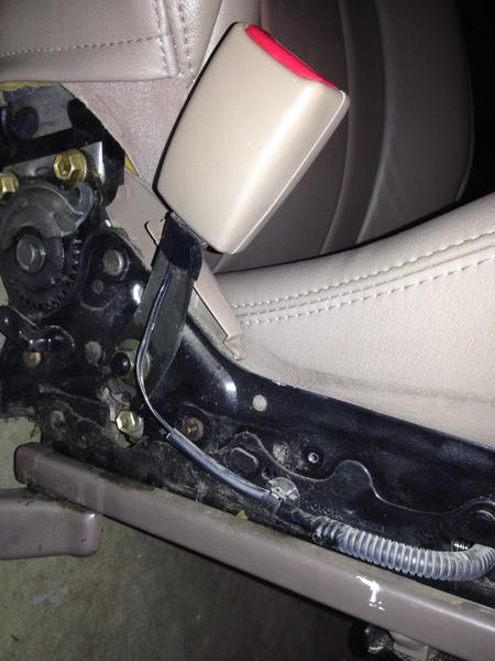

Just remembered that I need to remove the seat belt receptacles...
They are of course wired. Anyone know exactly what I need to remove with respect to the wiring? I want to avoid any related lights, like one reflecting that the belt is not buckled, when it is...
They are of course wired. Anyone know exactly what I need to remove with respect to the wiring? I want to avoid any related lights, like one reflecting that the belt is not buckled, when it is...]
Just follow the wiring back. There should be a pressure sensor attached to it somewhere. You'll need both the pressure sensor and seat belt wires re-installed to keep the light off. I'm sure there's a way to remove the pressure sensor but you'd have to test it's resistance then get the correct resistor wired into it. I've never looked at the 3rd gen system so I'm curious what you find. Post some pics later.
Will get one of the seats out of the garage into the sunlight tomorrow for a good inspection. I'll snap some photos too.
I'll search here for what others have done with aftermkt seats as that I had not done yet...
On my 99 the driver buckle is standalone, just a single wire connection to wire under the seat. The passenger buckle integrates with the in-seat (occupancy) passenger sensor. My driver seat has no occ sensor.
You can migrate the sensor from the/a stock passenger seat to your new seat if you want to, otherwise you need to do something regarding the passenger seat/buckle wiring as it might be tied into the passenger side air bag - I'm not 100% sure but I read there might be a tie-in there.

Is there a sound byte of that exact muffler on a 3rd gen 4runner floating around out there?
EDIT: found a few revving but they are Borla 40664 https://www.youtube.com/watch?v=wmf0heg4-cU and https://www.youtube.com/watch?v=iI39tF-0bvU
Regarding install, my local muffler guy will weld a new one in for $75 in about 20 mins. That's almost worth it to me not trying to weld it in lying under the car

I've had a couple Borlas before, including the current one in my SCd MINI. I'm reasonably confident I'll be fine with the loudness. The deeper sound I will like...
Mike, I was going to cut mine out in the driveway, but decided against that too. I have one of those pipe cutter tools that has always worked well for me, almost exactly like this one:
https://smile.amazon.com/gp/product...sfl_title_2?ie=UTF8&psc=1&smid=A2W86Q8280F2Q3
Much easier on an old system than a jarring reciprocating saw. A very nice cut too...
But, with that rear cut needing to be so close to the backside of the factory muffler, that is not a good tool for such...
Checking to see if a local shop will be open this Friday. If so, I'll likely re-install the factory driver's seat to get down there, unless I got the seat belt wiring figured-out for the Corbeau...
A rep at Borla I spoke with knows the 3rd gens pretty well. He said our factory muffler is a tank, likely well-over 20 pounds. This Borla shipped is 13, and actually a little less than 10 pounds.
