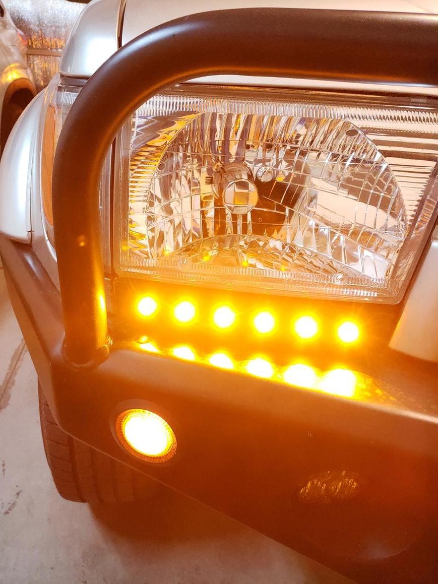

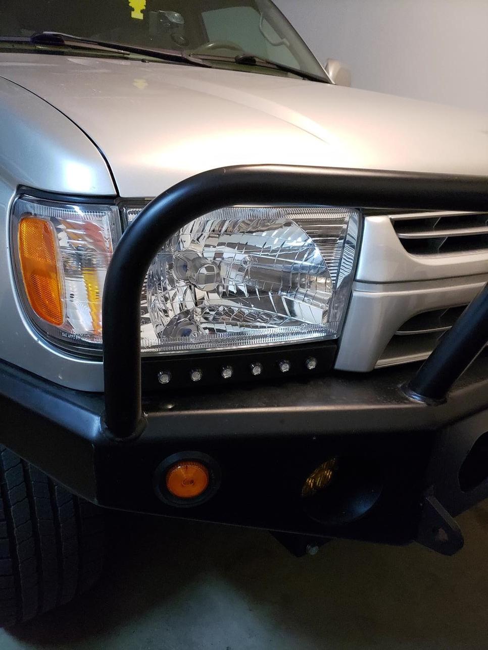

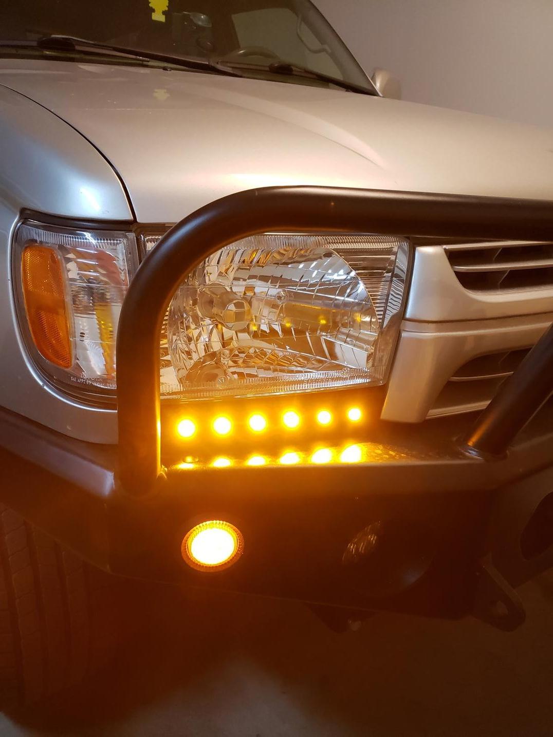

I bought that same thing and I had them wire it so it syncs with the LED circle lights that came with my 4xinnovations front bumper.
I think all the switch back does is it'll show white light if the turn signal is not being used... So extra light in addition to the headlights.
Here's a couple pics of mine.
edit: rotated images, apparently they uploaded sideways if I do it via mobile

The terminology used can be confusing, and gets only worse when others misuse these, which I've seen in various accounts on the web.
Visibility works two ways: seeing and being seen. I will likely go with two turn signal indicators on each side.
Bingo. I run headlights/foglights with good beam patterns and cutoffs, set correctly (for seeing) - and (at least on the 4Runner) run bright marker lights and extra turn signals for being seen (controlled amount of light outside the normal headlight beams).
