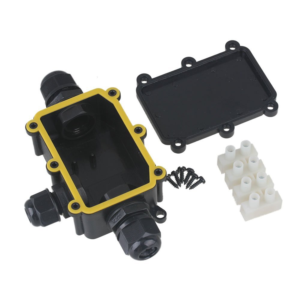

Sorry, I have a bit more time now and will try to be more clear.
As examples, our corner running/parking lights are two wires and our turn signals are two wires (+ and -). If I were to let's say snip the two wires going to the turn signal light, is there a connector that I could then attach those two wires, allowing me to have two pairs coming out, each to its own turn signal?

You got the gist of it. But unlike a crimp, I want the ability to disco, so some kind release mechanism, or as in the j box provided earlier, pop it open and remove what I want. I've taken that approach on home wiring projects...
I'm currently thinking of such a box for running/parking lights, and one for turn signals. As an example, if I want to add another turn signal, just loosen two screw insert, and tighten...

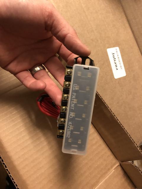

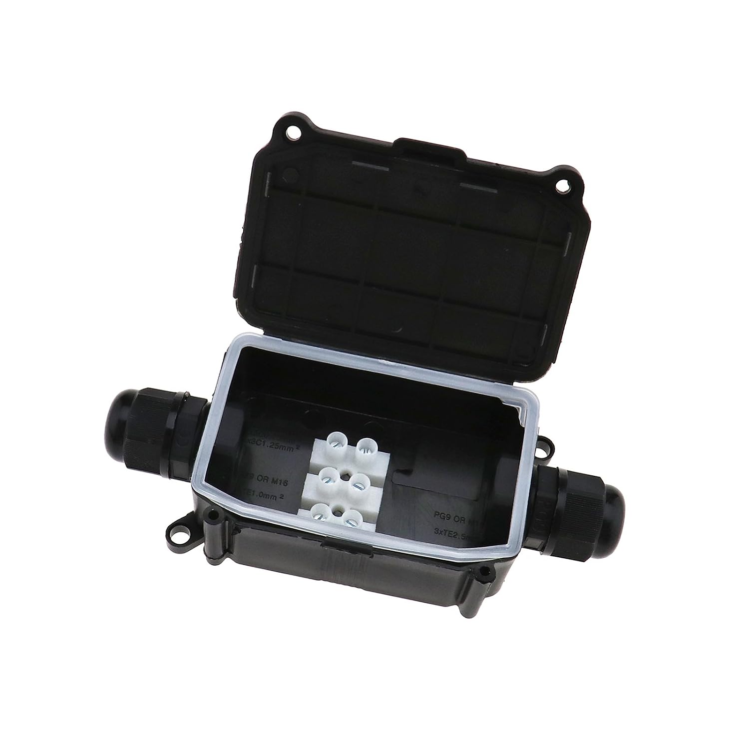

You got it.
With this one, I'd need one box for each side of the truck. It's small, about 2x3"....
https://smile.amazon.com/CNBTR-Wate...JHH7NQH6FYDF&refRID=FRXFJQKQJHH7NQH6FYDF&th=1
Hot and ground for each, running lights and turn signals. I'd feed those four input wires through one of the three ports. Of the two other ports, one will output running light pairs, and the other port, turn signal pairs.
You got it.

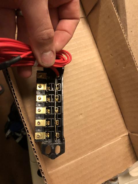

After looking more closely I guess it is just a small fuse block. Might actually be a good idea to do it like this anyway that way if something on one line gets messed up you’ll know which line it is by the fuses. All the grounds have ring connectors and just go to a bolt.

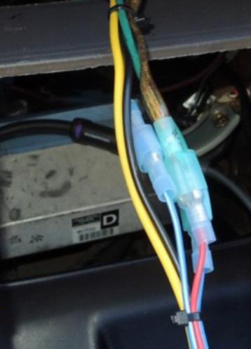

You could also use connector spades from AutoZone, NAPA or similar. You can easily combine simple 12 or 14 gauge electrical wire with a crimping pipe connector to merge 2 or 3 wires and then on end of each wire attach a spade connector. Do this to create a 'Y' splitting cable, one for (+) and one for (-). This is removable and you can simply seal with electrical tape or wire weather sealing sleeves making it simple and clean.
If I understand this correct you want to light up two left lights when turning left instead or one light? Then yes a parallel split should work. The downside of that fuse block is it is 1000x overkill for this purpose vs a custom Y wire. I say this because there is so little current going through the turn signal and corner lights. You can tell this by looking at just how small the factory +/- wires are. Toyota designed them based on current flow and it is a circuit that only powers a light bulb, plus if you use LED then the current will probably be 1/10 of stock flowing through that wire anyways. Just a few thoughts to consider.

What I provided earlier is more of a terminal block than a fuse block, but same branching concept.
After reading the reviews, it seems that these are not ideal for stranded wire. Damn. I won't get it.
I hear ya Brian on the overkill. I do like the idea of all those relevant connections in one tidy box, free of the elements and that I can label.
I have a pretty good assortment of spade connectors and unless I find an ideal box, that's the route I'll likely go. The spades will be removable, but if let's say I wanted to add a 3rd parking/running light, I'd need to snip-off that connector that has two and crimp another spade to get the 3rd one connected. No biggie. The appeal with having a post is that lights can added and removed with the nut or screw...
