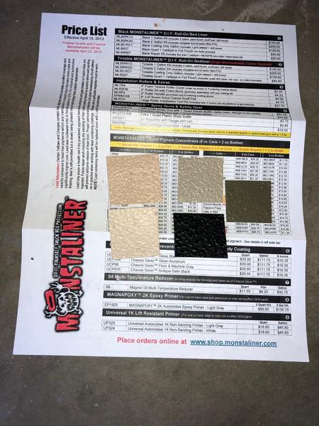

This is just my opinion but I strongly suggest you consider (if you haven't already) spending the $150-ish to get the front bumper powder coated. My front bumper ARB powder coat has held up 10 years now and my rear Savage powder coat has held up about 9 so far. You won't get that kind of last out of any rattle can. Perhaps a professional paint mix yes but rattle can no. I assume you are considering the DIY paint job. I painted my rock sliders with rattle can primer and paint them after about 2 years they looked like crap AND I live in San Diego.
Understood and appreciated Brian. Had powder coating before on a different vehicle, and while it was clearly much tougher than spray can paint, it too needed touch-up. I always have a can or two of that spray paint on hand for any touch-up.
Also, since I plan to go the MonstaLiner route at some point, I might then consider to do the bumpers as well, and sliders.

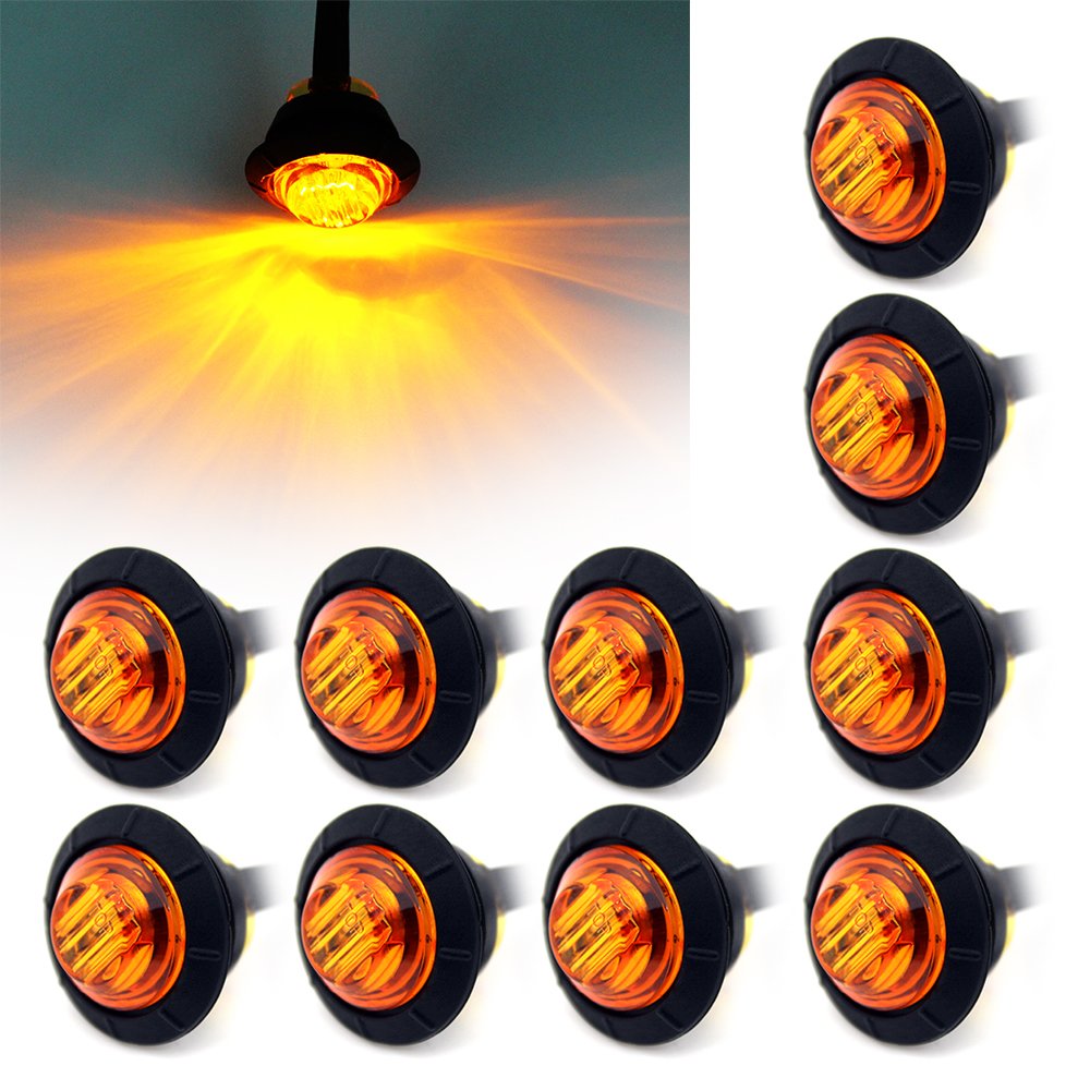

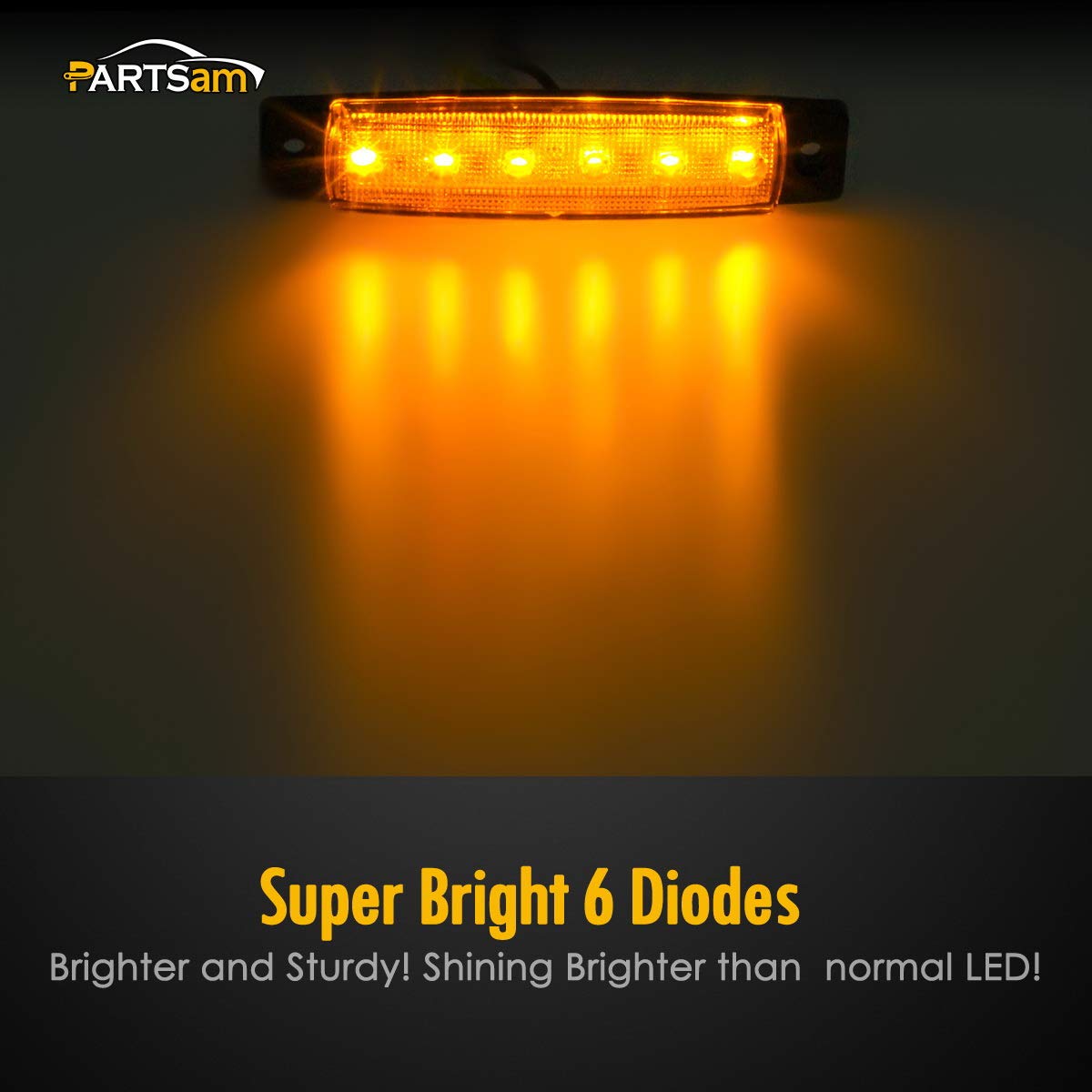

With the grille off, I thought I'd look into addtional turn signal options, making use of that space below the headlights.
I realize of course SRQ Fabrications has a very neat offering. With a 2+ week wait, 100 or so bucks, I'm thinking something like this for 10 bucks or less...
10 pack:
https://smile.amazon.com/gp/product...c_title_dp_4?ie=UTF8&smid=A1B2SF9J2WBIQS&th=1
I imagine the SRQ product uses something like these.
https://smile.amazon.com/gp/product...c_title_dp_6?ie=UTF8&psc=1&smid=A9B93WR44O7HV
More holes to drill, wires to consolidate and connect...
The first light choice is rated IP67, easier to install and replace when needed, so that is the lean. I'd have eight extra, for the 4Runner or trailer...
