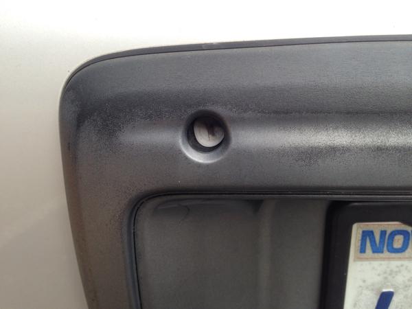

When I attempted to insert the key into this keyhole, it was not fixed and moved backwards and down quite a bit. Easy fix?
The rear turn signal LEDs are too long! Need to be almost 1/2" shorter. Drat. The other two bulbs in there are the same length, but the turn signal cavity is much more shallow...
Nope, key drop is a PITA, but once you remove the bezel, epoxying it should be a permanent fix.
Lot's of threads on the subject - I've done two of them so far... bezel fixes, not threads Lol
Not what I wanted to hear, but doesn't sound all that bad. Some J-Weld to the rescue, likely overkill though... I will paint the bezel anyways, along with the flares and cladding, probably next spring.

I used a 5-min, 2-part epoxy. The trick to removing the bezel is lowering the rear window about 2" at one point during the uninstall to make access to the nuts easier. Painting the bezel is easy, whether you paint the rubber gasket around the outside is up to you - removing it and gluing it back on is a PITA

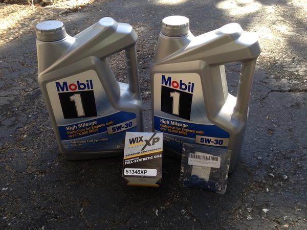

First oil change, finally. The oil from the dipstick looked decent, but after Seafoam for about 50 miles, it was quite filthy.
All new for me of course, but realized pretty quickly that I needed to remove the the skid plate, at least the front portion. Looks to be seven bolts, but I had six. Add that to the list of stuff to pick-up....

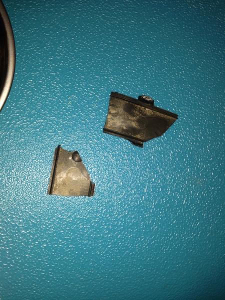

Oh, when I lowered the skid plate I found these plastic bits. Any ideas?
Plastic bits look like seat rail trim covers that have seen better days lol

I let the oil drain overnight. A little over 5.5 quarts...

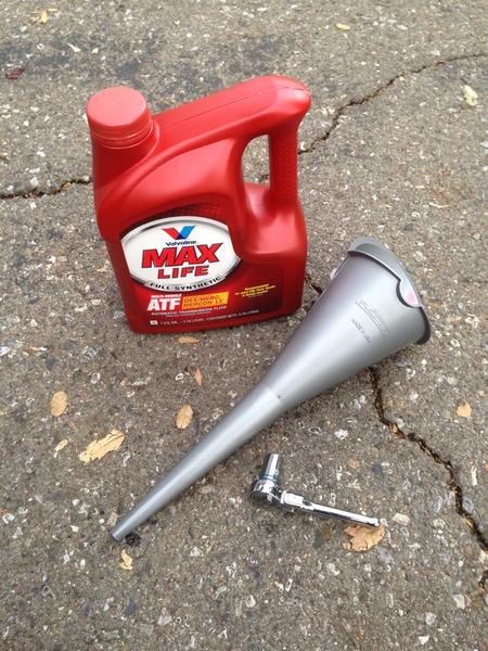

Drain and fill...
Got about 5 quarts, which I guess is pretty normal for these, the autos at least...
