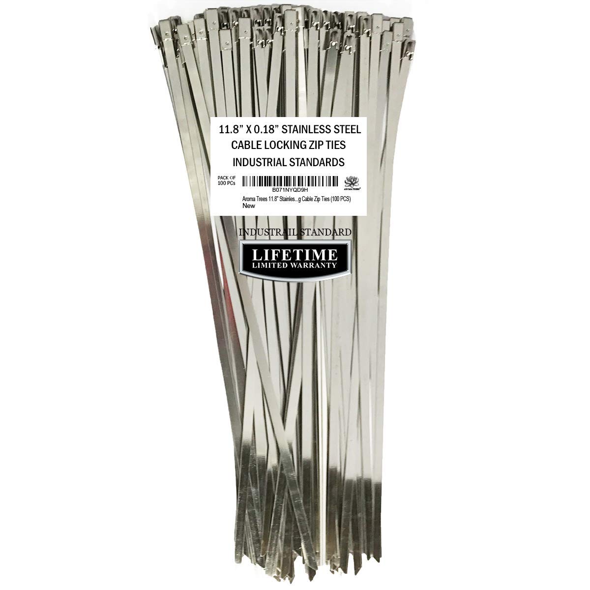

As mentioned earlier, I'm not so keen on plastic zip ties. I just ordered these.
https://smile.amazon.com/gp/product/B071NYQD9H/ref=ppx_yo_dt_b_asin_title_o00__o00_s00?ie=UTF8&psc=1
