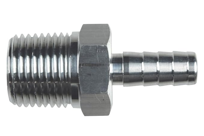

Couple things you could do, IMO best option is to get a 3/8”x1/2” barbed reducer. Easiest option though would be to get some electrical tape or other good quality tape and put a few rounds on the hard lines until it’s the correct outside diameter to fit in the hose. I’ve had to do that a few times in my years of plumbing lol.
Thanks.
Exactly what I ordered - 1/2 NPT male to 3/8" barb male. However, since the unit is aluminum, should this piece also be aluminum? I had ordered a set in stainless steel, but just canceled those, thinking I should get aluminum instead...
https://smile.amazon.com/gp/product...wc_img_oth_1?ie=UTF8&psc=1&smid=A1TNMI4LHV0ZX
Thanks.
Perfect that’s exactly what you want. Is the trans cooler aluminum? I’d think brass, stainless or aluminum would all be fine. Brass and aluminum parts are pretty common on coolant systems..
Yes, all aluminum. I'm inclined to get a soft metal to thread into it, like aluminum or even brass. That said, there are many applications on autos where steel is threaded into aluminum, like heads. Not sure the best option here...

I’d just get brass, could probably find it at Home Depot. Relocating that line I don’t think is worth the hassle, at the minimum you’d have to remove the refrigerant and then recharge when your done..
Was thinking the same. It actually looks possible to reshape or contour it a little...
Truth-be-told, I've done AC deletes on other rides, for various reasons. With the wife and kids in this one, no way.
Brass is fine, use teflon tape on the threads to get a nice seal and prevent dissimilar metal to metal reaction/corrosion.

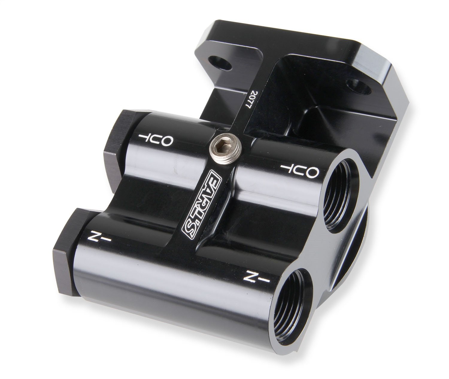

Optionally, you could put an inline filter, like the kind used for power steering or oil, that has a frame-mount bracket.
Many of these have dual port locations allowing you to use the port that works best for your application, just like the pic above. You can use one of the unused ports for your aux cooler thermostatic fan probe - if you're still looking at doing that.

You are overthinking the fittings. They'll be fine. The only real risk is over tightening the fitting and cracking the cooler body. Remember, the inside of your trans is FULL of regular steel parts and aluminum in direct contact with each other.
-Charlie
-Charlie
Thanks Charlie. Another example of dissimilar metals living in harmony. While I feel better about using stainless steel now, with positioning the cooler on the driver side, angled fittings might be the way to go routing-wise. Something I still need to scope-out... I can't tell how Matt oriented his cooler and ran his lines. It appears that his ports might be facing downward, but I can't tell.
The dissimilar metal issue can be a problem in two ways:
- Electrolysis. Requires and electrolyte! Water is often ionic (in some small amount, especially when moving) which can cause corrosion between dissimilar metals. This shouldn't be an issue with good (clean) transmission fluid.
- Galling. This is often an issue when installing aluminum and steel (and especially stainless steel). You will have thread sealant or teflon tape in there, so that also won't be an issue. Always use something in the threads of a aluminum to stainless threaded joint to avoid galling unless you are only going hand tight. Once again though, not an issue for this case.

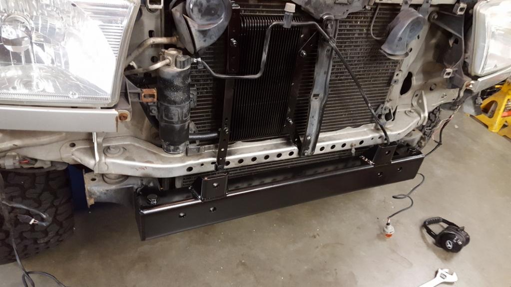

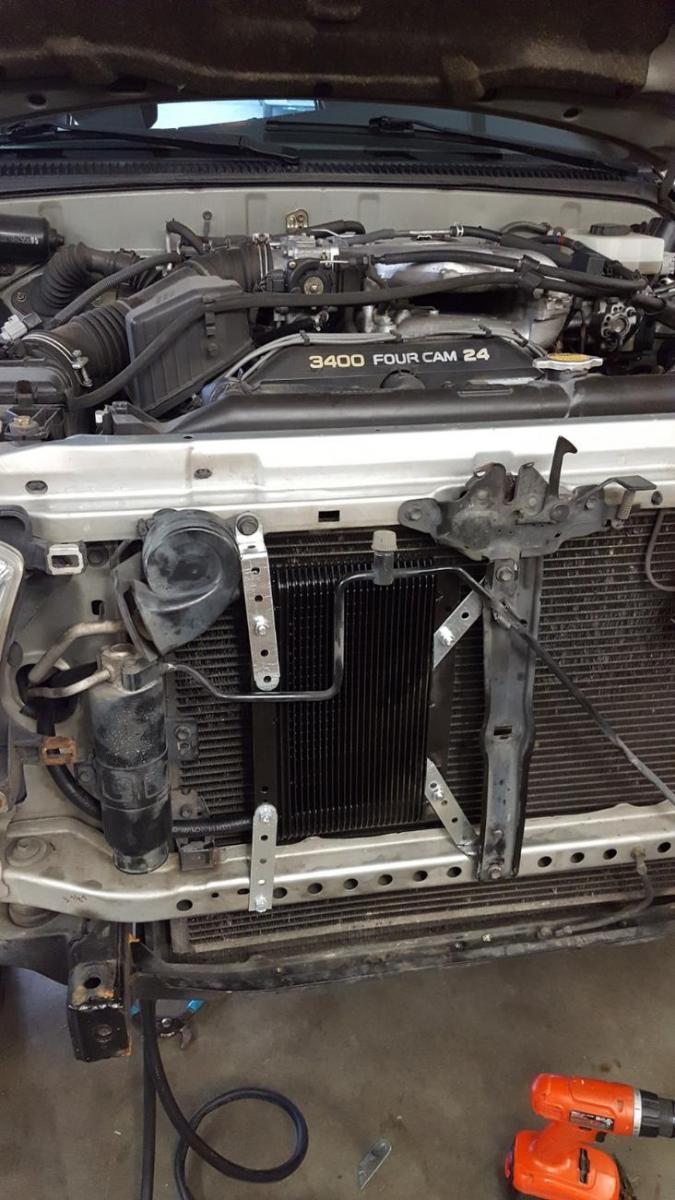

Did have a few minutes to play around with tranny cooler fitment possibilities.
There is less space on the driver side.
The passenger side looks to be the way to go, with this unit at least. That 7" fan, which is closer to 8" overall, would seemingly fit well.
In that photo, I have the cooler flipped such that the mounting plate holes are forward, not up against the condenser. Not sure what way will prove to be better at the moment. I will need at least 1 90 3/8" barb fitting, maybe both... Oh, the AC line is pretty bendable.
I am running a different size, but the concept is the same. I think you are on the right track with the mounting plate holes forward, and mounted on the passenger side. This is what I ended up with. The concept should be the same. I didn't want to run the zip tie mounts so it just came down to finding good mounting positions with the hardware.

RB, thanks for the encouragement and photos. I will indeed mount it on the passenger side, pretty much in the same location I showed, and where you positioned yours. Looks like the hard AC line that crosses our condensers is somewhat different on the various years.
This cooler is not a kit, so no added supplies in mine. I think I have sufficient scrap metal stock and various pieces to figure something out... Maybe next week I'll have some time to get on it again.
