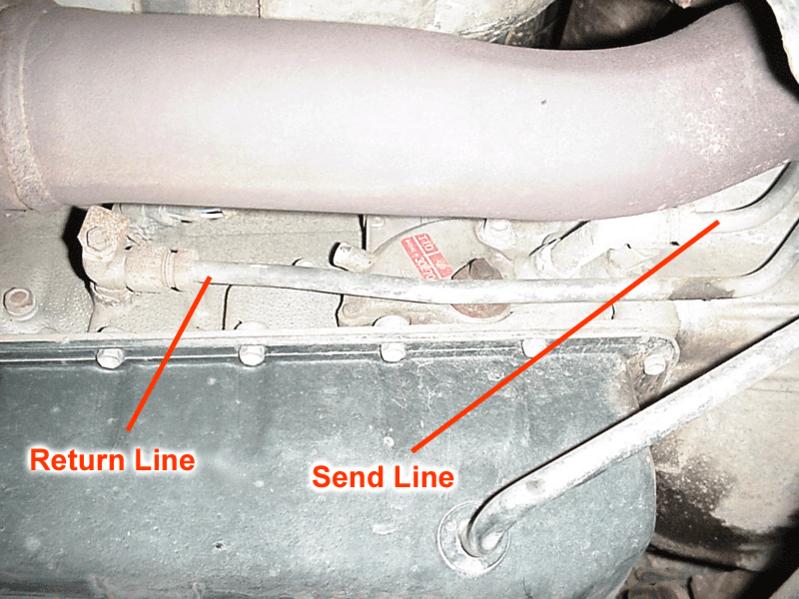

This thing has 0.5" ports. Would 0.5" line be too big to fit snugly on the send and return hard lines?
133140d1413044617-b-m-70268-supercooler-transmission-cooler-install-3rd-gen-tranny-full-jpg
Couple things you could do, IMO best option is to get a 3/8”x1/2” barbed reducer. Easiest option though would be to get some electrical tape or other good quality tape and put a few rounds on the hard lines until it’s the correct outside diameter to fit in the hose. I’ve had to do that a few times in my years of plumbing lol.
