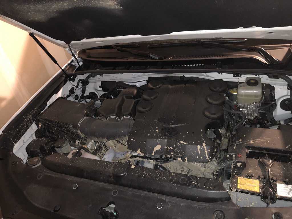

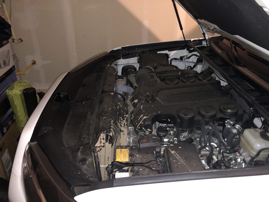

took my car to the local off-road park for some playing around in the mud and got muddy water all up in my engine bay. It isn't mud, just muddy water that has dried.
Does anyone have experience with the best way to clean the muddy water from the engine bay and to prevent long term damage, rust, etc? Picture

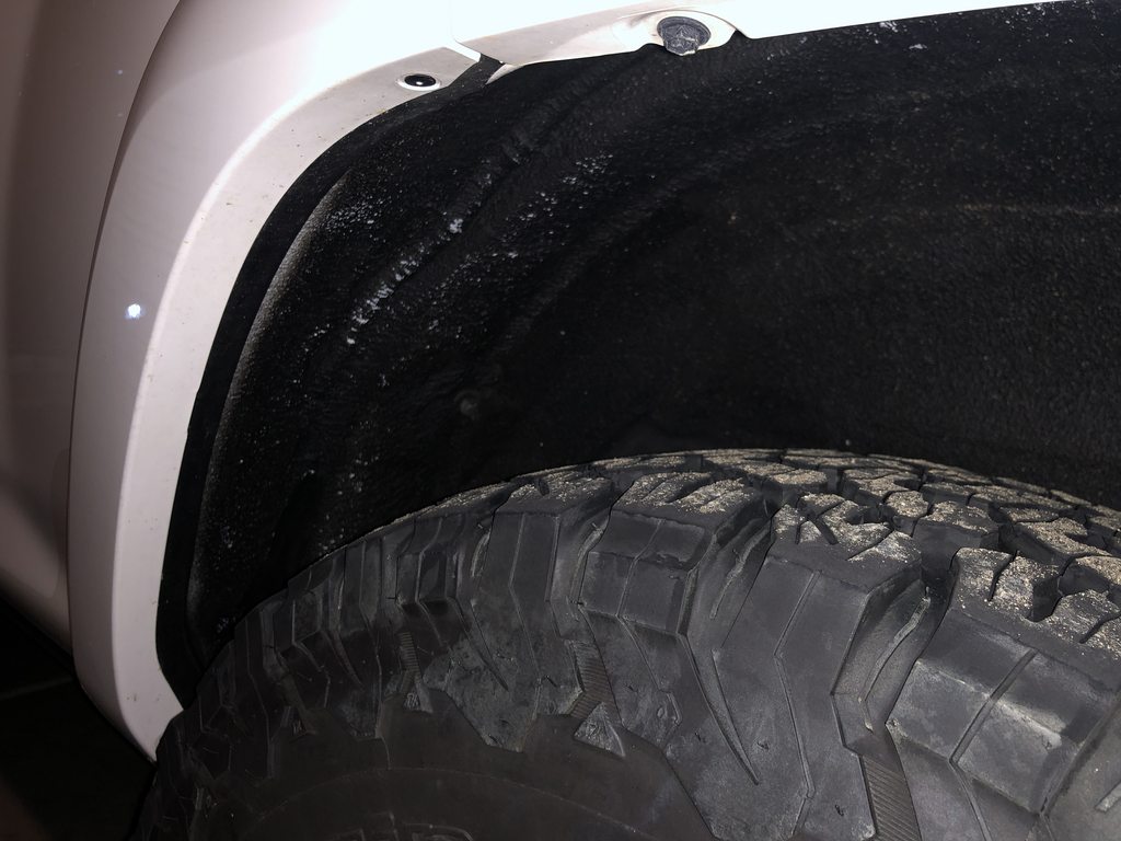

Also, i took the car to a local car wash and used the pressure washer to remove mud from the wheel areas and noticed that for the rear inside wheel liner area, it removed some of that black rubbery material, see picture
Does anyone know what this material is and if I can put more on?

I second using Simple Green. I have been using a various forms of their automotive oriented formula, currently called Pro Series Max Automotive Cleaner and Degreaser, for literal decades.
For your wheel well, hit the area with a rubberized undercoating, such as the stuff Rustoleum has in a spray can.

Powerwash it off of course not putting the wand too close. I did that for many years on my 1992 Toyota Pickup which I sold with 410k. Mechanics always told me that was the cleanest engine they ever saw for a truck like mine. Spay water on it and let it soak a while before you powerwash to make it easier. I also used de-greaser to get any oil or other grime off.
I used Purple Power. Sprayed, sit for about 2 minutes, and rinse. No pressure washer, just a garden hose with a medium width spray.
Wash only when the vehicle has cooled off. Spraying cleaning detergent on a hot metal may discolor.

No not really. All electrical connections are sealed plugs. Engine compartments are not completely sealed are designed to be able to take a light amount of water
I detail vehicles on the side and I cover up exposed intakes and cover the alternator with a cheap plastic shopping bag, but I believe you can also get the alternator wet without causing much issues.
I wouldn’t use a pressure washer up close or anything, just a light spray setting with a garden hose after a little cleaner and some agitation.
I also use a leaf blower or compressed air to remove excess water. Then use a spray wax as I dry it with a towel.

To me a dirty engine is better than potentially damaging expensive electronics such as the ABS computer or PCM. I try to clean by hand when possible. I don't offroad though so it's just dust and grime.
Yeah, no pressure washer.
Mist the entire engine until it's wet, spray Simple green (keep it off your paint, fenders/bumper, etc)and use a brush and a microfiber towel to wipe it all down.
Then lightly mist all the simple green off and start it up, push the hood down so the heat stays in the engine bay. After most is dry you can turn off the engine and wipe down any spots you missed with something like Quick Detailer.

The coating looks like undercoating they use in snow areas. Did you purchase new?
I wouldn't recommend using Simple Green in your engine compartment. What we in the aviation community discovered years ago is that Simple Green corrodes aluminum. Not a good thing in aircraft. There's lots of aluminum in the engine compartment, so probably not a good thing there either.
Maybe the different grade of aluminum in the aircraft? I've been using Simple Green for years on different road vehicles and haven't had issues. I even spray it into the radiator and AC condenser.

Newer vehicles are pretty well protected against water intrusion, so you shouldn't have to worry about ruining any electrical components, air cleaners, etc. You shouldn't have issues, but you do need to use some common sense when cleaning an engine bay. Bag exposed electrical if needed, and don't use a power washer. However, you can use the pressure coming out of a garden hose without any concern. With the 4Runner, I don't worry about bagging anything, everything is pretty well sealed off.
Steps for Engine Bay Cleaning:
1) Prep sensitive components with plastic bag covers if needed.
2) Rinse entire engine bay down with water.
3) Spray all purpose cleaner.
4) Use a mitt or brushes to agitate dirt.
5) Rinse engine bay.
6) Dry with compressed air or electric leaf blower, finish with towels.
7) Apply your favorite dressing to the plastics.

For your (otherwise clean) engine.
Wash the dirt out of the radiator/hoses/whatever. (Garden hose/sprayer.)
Use WD-40 and a rag to do the rest. If you want your rubber/plastics to last
and look new, use Pledge on 'em and wipe off.
Don't use armor-all... after a while it will turn your black hoses... er... grey.
Underneath ? Pressure wash.
If you want to do it er... 'nice' then WD-40 and rags.
Finish with Pledge and rags on the plastic/rubber stuff.
I'd avoid Simple Green. No reason to use it on a clean (non-oily) engine.
It will corrode aluminum... and it might take a while to do damage if it gets
into the electrical contacts.
Dirty/greasy engine ? Use a spray can of engine de-greaser,
then a rag and WD-40.
