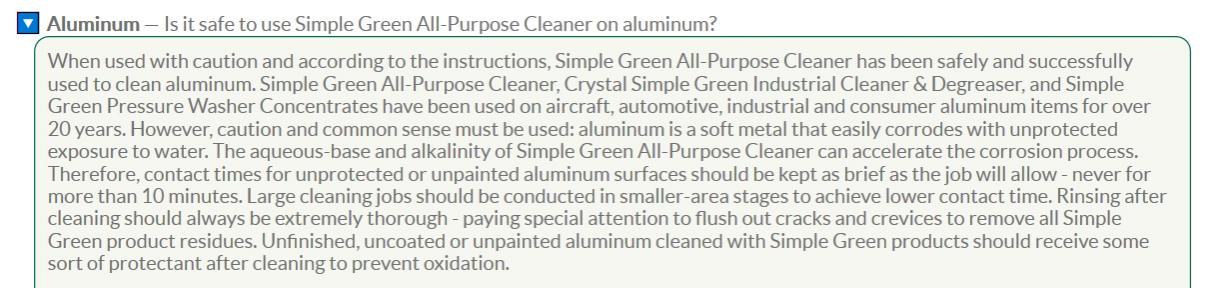

Maybe the different grade of aluminum in the aircraft? I've been using Simple Green for years on different road vehicles and haven't had issues. I even spray it into the radiator and AC condenser.
From the Simple Green website's FAQs.
When I read cautions like that I generally don’t use the product. Some will read that and feel that it’s perfectly OK to use. I get from it that it does corrode aluminum and the longer you leave it not totally rinsed, the more corroding it’s going to do. But that’s just me.
Been using Simply Green and a Hose since 2006 on two 4Runners great results and without drama.
