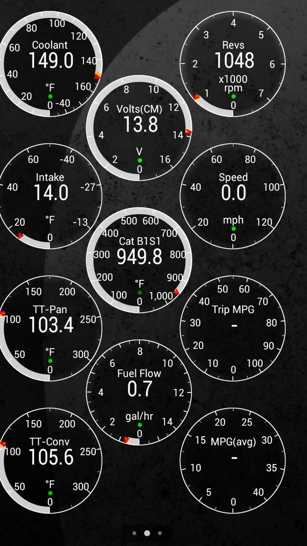

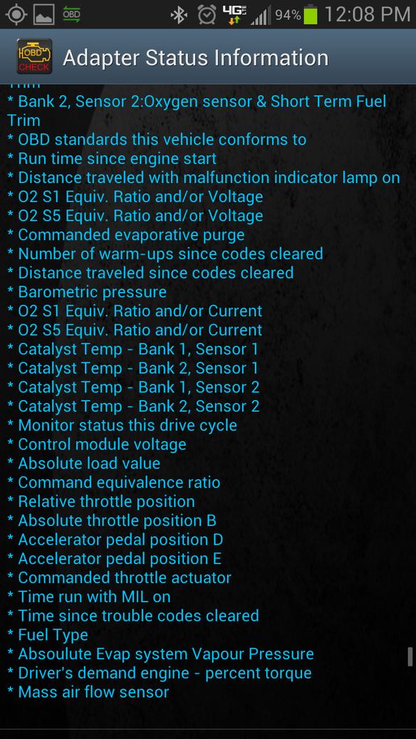

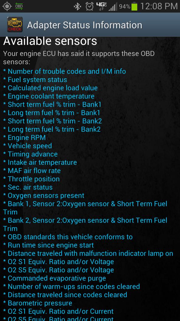

Just hooked up my bt adapter to my 2014 4 runner and all my settings for the 2012 Tacoma transmission pids carried over and work to read the transmission pan and converter temps.
Screenshots attached of what the odb-ii reader can see to read and of the app running.

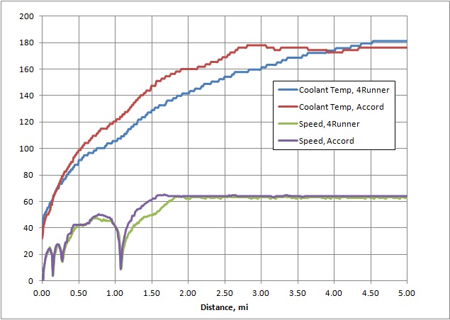

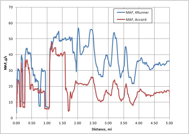

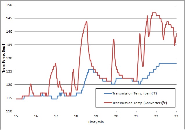

One of the features I like about Torque is the ability to set warnings and the ability to log data. Fox example, you can setup a Transmission temp warning at 250 degrees, and Torque will alert you when that threshold is reached. That way, you don't necessarily have to keep and eagle eye on it during towing or trail runs.
Logging data is also nice to nerd out to. I logged my trip yesterday to see family in the 4Runner. Logged my trip to work today in my Accord. First 5 miles is the exact same.
Last chart is just the 4runner and shows the the torque converter temp compared to the pan temp when it unlocks on 2 lane roads mixed with traffic.

dang the accord TT is all over the place. opps, didnt read the chart correctly. its pan temp and converter outlet temp.
Wasn't written too clearly! Edited the post to make it cleaner.
The '06 Accord doesn't have any extended PIDs, so I don't get any of the 'good' PIDs like trans temp, ABS wheel speed, etc. Also, the protocol it uses is quite slow. ~6-8 PID/sec.
The 4Runner (at least 2010+) is much faster. I get ~65 PID/sec on my OBD MX tool. ~25 PID/sec or so on my OBDlink adapter.
