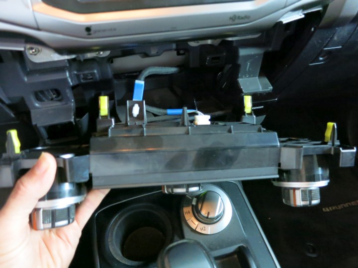

1a. Remove the left and right vertical trim pieces that surround the left and right climate knobs. They attach with clips, so just grab it with your hands and pull straight back.
1b. Remove the climate control panel with the 3 knobs. It also attaches with clips, so just pull straight back. Again, there was enough to grab onto that I didn’t need trim removal tools. Don’t pull too far, as there is a connector. I unplugged the connector and detached the strain relief with needle-nosed pliers.

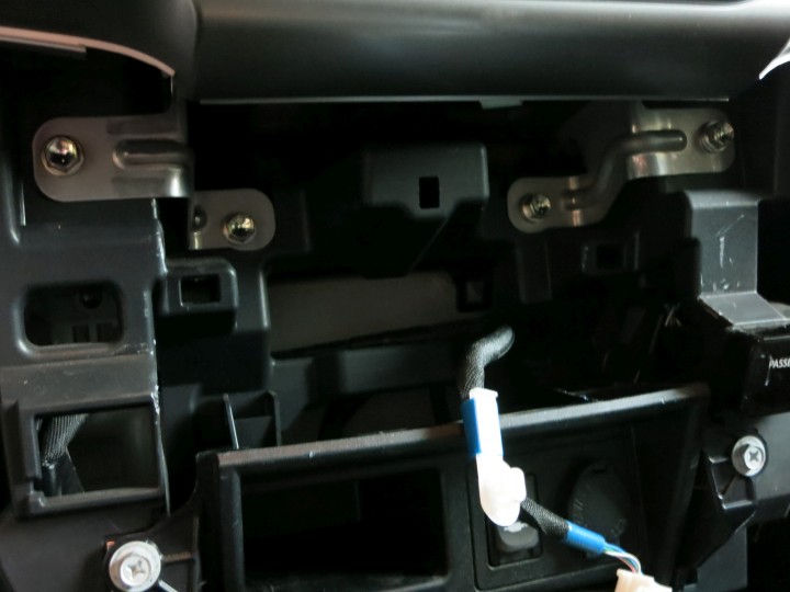

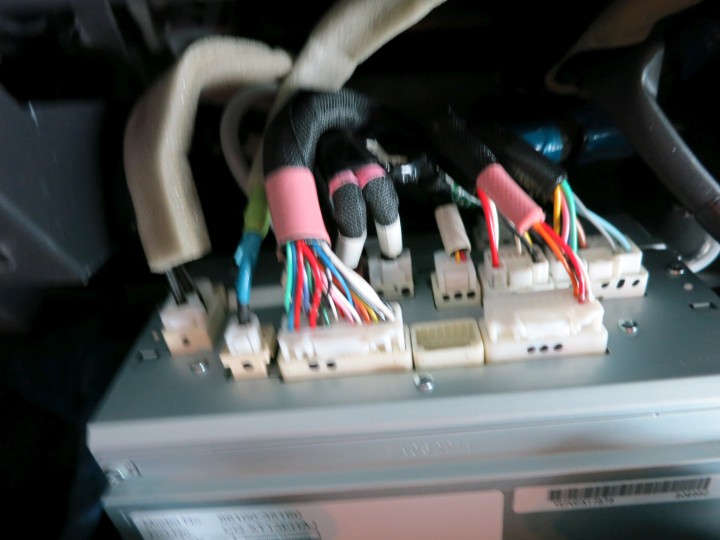

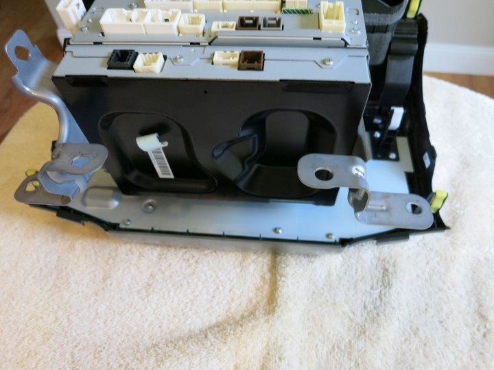

1c. Remove the head unit, which includes the upper air vents. Remove the 4 10mm bolts in the upper part of the image. There are also clips, so pull straight back, not too far, as there are many connectors. As I unplugged the connectors, I used a sharpie to add a unique dot pattern to both the female and male ends. This is probably not necessary, but I was trying to be careful. Some of the connectors connect to the dashboard and must be unplugged. Some of the connectors connect just the 2 boxes of the head unit so don’t need to be unplugged to remove the unit, but they all need to be unplugged eventually, so I unplugged them all now, including the strain relief connection.
2. Remove the radio and navigation boxes

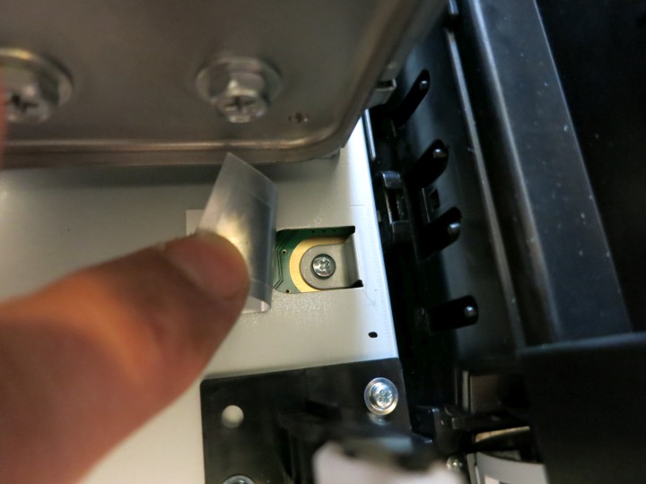

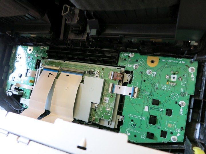

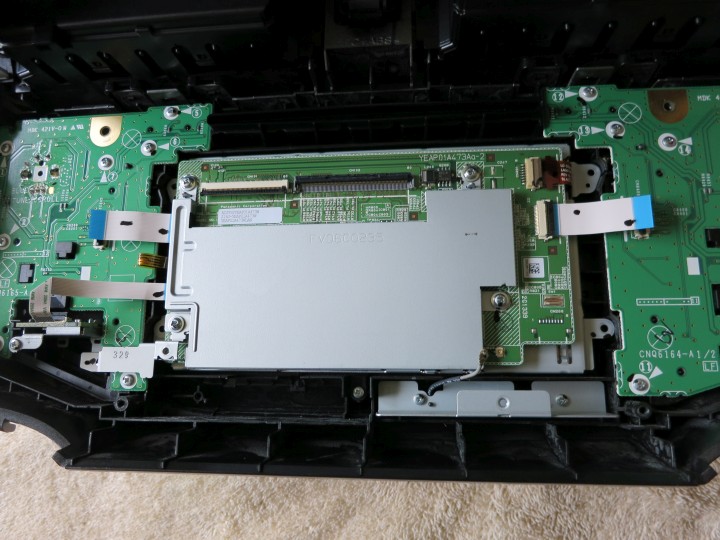

2a. Remove the 2 boxes, frame, and metal plate to expose the screen assembly. There are 6 screws, 2 on the bottom that go into plastic, 2 on the bottom that go into metal, and 2 on top that are hidden beneath silver tape. The bottom screws are partially blocked by the bottom box, so I removed its 4 8mm bolts and removed it from the frame. The 2 black plastic tabs that screw to the metal plate do not need to be removed. The hazard switch connector needs unplugging. Gently pull the metal frame and plate away from the screen and dashboard – there are clips that need releasing. Do not pull far, as there are 2 ribbon connectors.
2b. Remove the 2 ribbon connectors. Flip the connector tabs up with your fingernail. This separates the frame and plate from the dashboard front and screen.

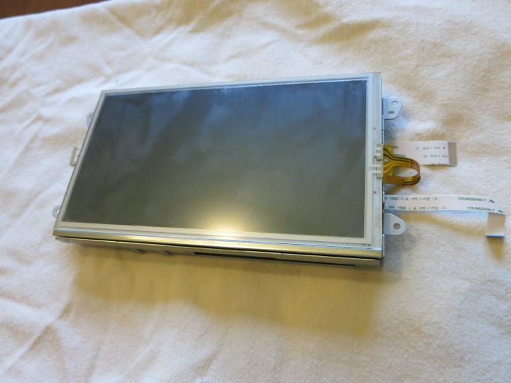

3. Remove the screen and digitizer. Unclip the 3 white ribbon cables on the dashboard end – it is easier to leave the ribbon cables attached to the center screen assembly. Unplug the mcx gps connector – black wire on the bottom right. Remove the 4 screws holding the assembly to the dashboard front (the screws are removed in the picture). There is no need to remove the 4 screws holding the back plate to the screen assembly. Now lift out the screen assembly. The clear digitizer should be attached to the assembly, but my digitizer was unattached, so it needed lifting along with the whole assembly.
4. Replace the digitizer. It’s the clear front piece that attaches to the screen assembly with a gold ribbon cable. First, remove the old digitizer. Flip up the cable connector tab and pull out the cable. The old digitizer had 1/16” strips of double-sided tape along the edge as backing between the front of the screen and the back of the digitizer, which should secure the digitizer to the screen (my old one didn't stick). The new digitizer did not have any double-sided tape, so I got some at a phone repair place. It's made for screens and needs to be heated to set. Carefully center the digitizer with the screen. If you don’t center the digitizer properly, you may have edge buttons on the touch screen that won’t activate (don’t ask me how I know this). One the digitizer is attached, plug the digitizer ribbon cable into the connector all the way and flip down the tab.
