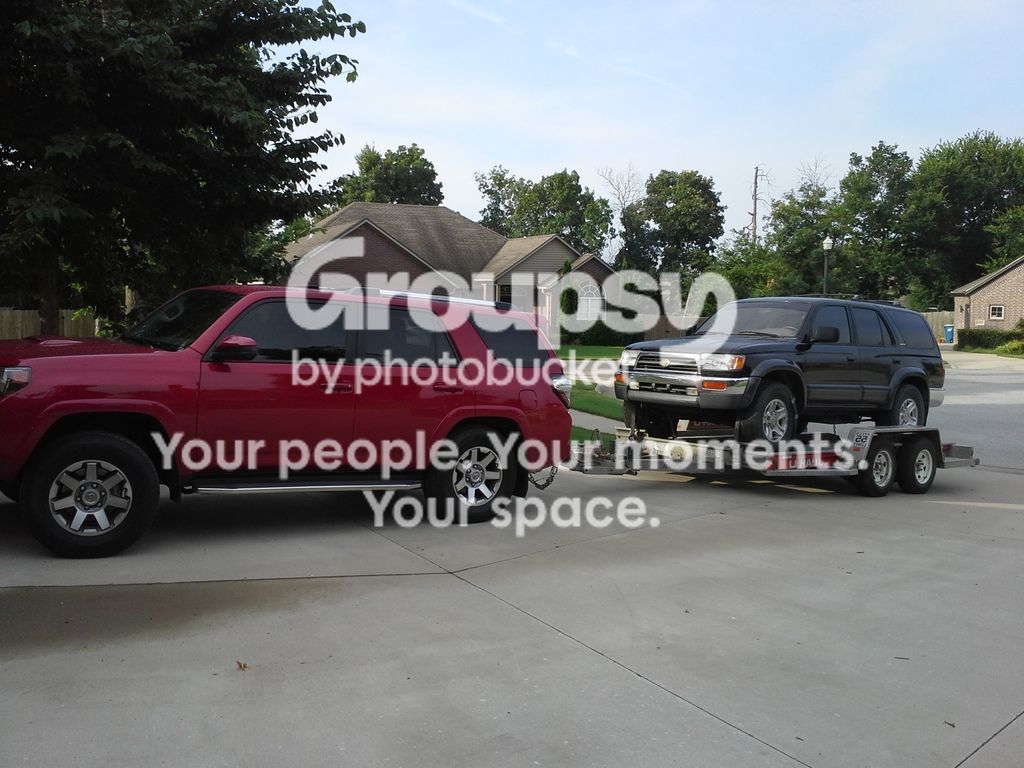

This was fine between Bentonville, AR and Olathe, KS. Got 14 MPG average, kept the speeds reasonable. Could have maintained 75 MPH the whole way, these trucks have more than enough power for that. But it's not so much about power/speed as it is handling/braking when you're towing.

If you have the opportunity to get a brake controller, I'd strongly suggest it. I drove my 5th gen for a year with an array of trailers behind it and once i added the brake controller I gained a ton of confidence (especially on the highway where people like to dive in front me).
