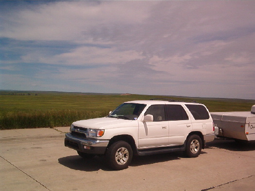

I just got back from a trip out west and I towed a pop-up camper. Only 2,000 pounds. After 6,000 miles I averaged 17.6 MPG, that includes about 1,000 miles without towing. I figure I can get over 20 MPG without a trailer and with the trailer I get 16-ish or so.
That trailer is really nice, I wouldn't mind getting something that big rig & with a new 4Runner with a V8, but that 8 MPG really hurts.
