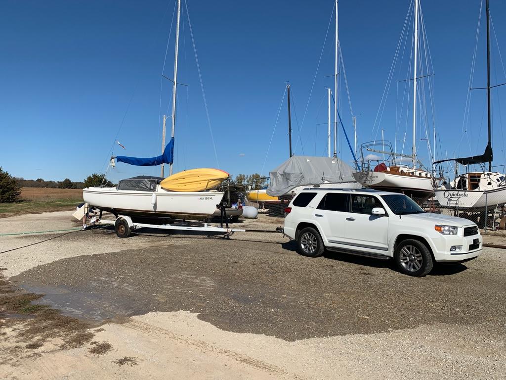

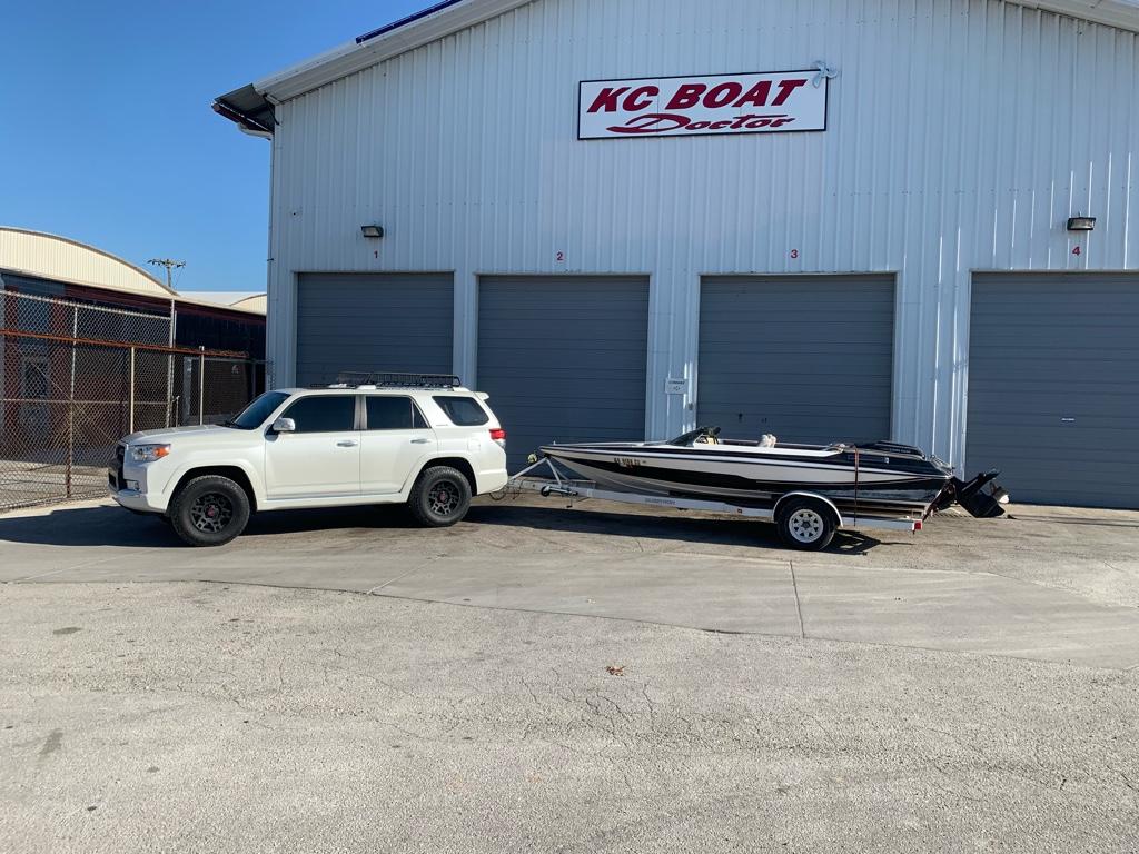

Late to the game but I regularly tow my 19” ski boat with no problems, in addition to a 22” sailboat and 18” glastron (not at the same time) Lol.

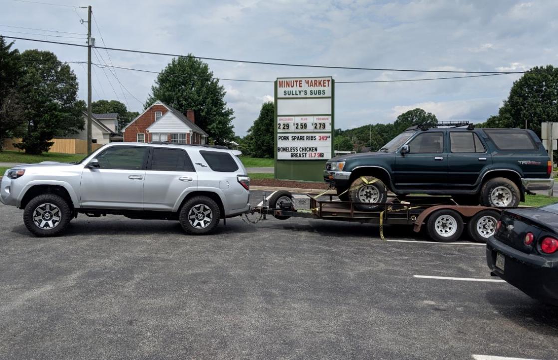

I'm sure I was way over the limit, but we made the 4 hour trip successfully...

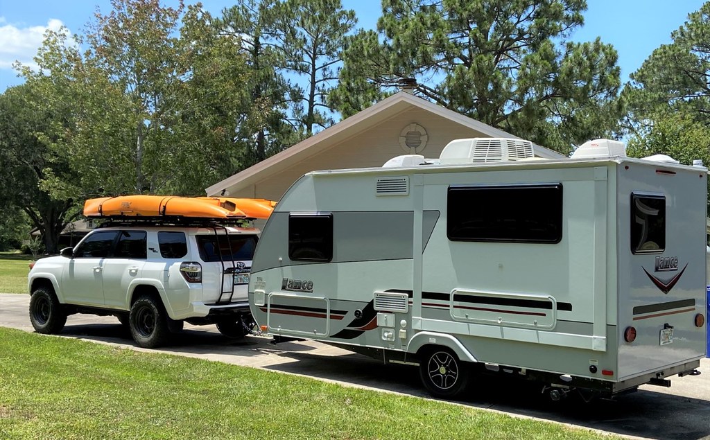

Agree with everything just said. I just bought a 2021 Ibex at 3700 pounds dry. Use a WDH and brake controller. Was is S3 or S4 going over the Siskiyou pass, highest point on I-5 between Canada and Mexico, and was at 40-45 mph the whole time going up.
I’d like to run air bags but I don’t have the time or tools or garage space to install them and no one local really wants to mess with it. Possibly might swap out my dobinson springs back to my 3” Icon overland springs with a heavy weight rating.
Either way it only sags a little bit more than I’d like and tows fine, just wish it was a little more level.
GVWR on the trailer is 3700#
Gobi rack + Hobie Kayaks is probably another 330lbs. on the roof.
Redarc brake controller
Andersen WDH
275/70/17 K02 tires
Tow in S4
I'm OK with the towing performance of the 4runner. It's not great but gets the job done. Brakes & sway control work great, no issues feeling unsafe with the weight. My only gripe is the downshifting at even the slightest grades if using cruise control (so I don't). My previous truck was a Chevy 2500HD Duramax pickup that I'd tow a 13,000# center console boat with. 4runner feels about the same towing this little trailer lol.
The photo above was loaded up for a ~600 mile round trip to the panhandle & back. Flat drive on I-10 kept speeds <70mph. Very surprised when I hand calculated 11.7 mpg when we got back, I didn't think it would be that good. We've had the trailer about a year and a half now and have a couple thousand miles of towing on it. If we were full time RV'rs I'd want a more capable tow rig but as weekend warriors the day to day use of the 4Runner + offroad capability wins for me.
