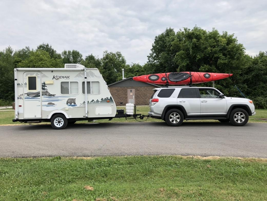

2013 Toyota 4Runner SR5 towing a 2005 Kodiak 160. The trailer is 2,680 lbs dry I think.
This is with a weight distribution hitch. Without it the rear end is too low.

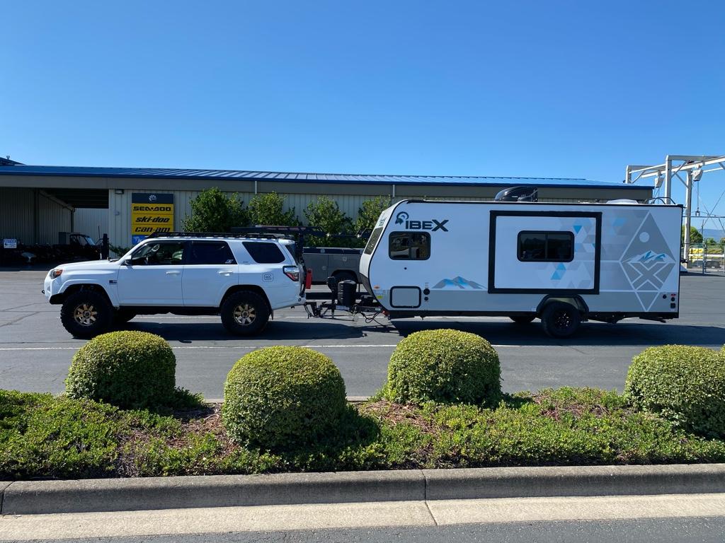

Agree with everything just said. I just bought a 2021 Ibex at 3700 pounds dry. Use a WDH and brake controller. Was is S3 or S4 going over the Siskiyou pass, highest point on I-5 between Canada and Mexico, and was at 40-45 mph the whole time going up.

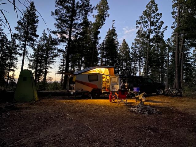

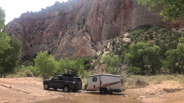

Just did another ~1,000 mile trip through Utah, Wyoming, Idaho, and Montana with the little teardrop. Really have no idea how much it weighs. But the towing is not great no matter what.
I really need to move up a size. Considering a pop top aussie style camper. But even then I'm realistically looking at moving up to a bigger vehicle with more power. Not super excited about any of the options at this point. Wish the 4R could pull a bit better.
Bright side - no tour buses in Yellowstone this year! And half the campgrounds are closed so it was great! Probably go back at least one more week this summer.

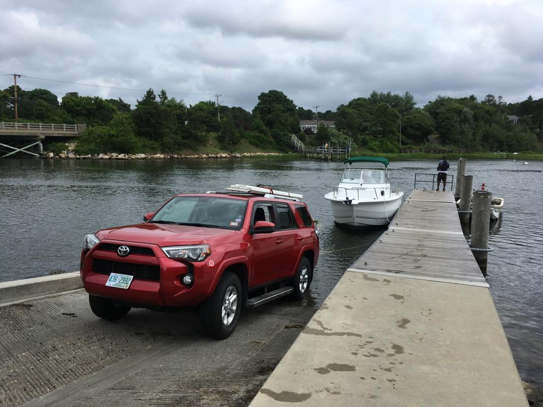

2015 4Runner. I tow a Sea Pro 22’ boat and dual axel trailer for 5400 lbs. No problem at all. I tow it 200 miles round trip a couple of times a year. Only modification was I added an oil cooler to it.
