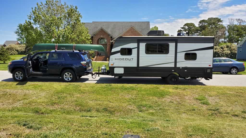

I did invest in a tongue scale (etrailer Tongue Weight Scale e99044). It was really interesting. After I picked up the camper from an Outdoorsy host, I took it home and weighed the tongue. It was right at 500lbs. I packed our gear on or behind the axle and brought the tongue down to about 420 lbs. I estimate that I added about 300 or 400 lbs. to the dry camper weight of 3700 lbs. The 4runner pulled it really well with a canoe on top and 3 kids and a dog in back. I did not notice any sway on the way there with no winds and very little sway on the way back in 15-20 mph winds. I would say that I stayed between 55 and 60 the whole way and took my time. The RedArc trailer brake controller was fantastic and I was able to quickly dial in the trailer brakes to where I wanted them. I kept it in S4 the whole way. Really pleased with the 4Runner towing performance.
Also, I found a B&W hitch that I really like. It fits up snug and does not stick out a mile. I think I love this Tow & Stow Hitch! : 4Runner

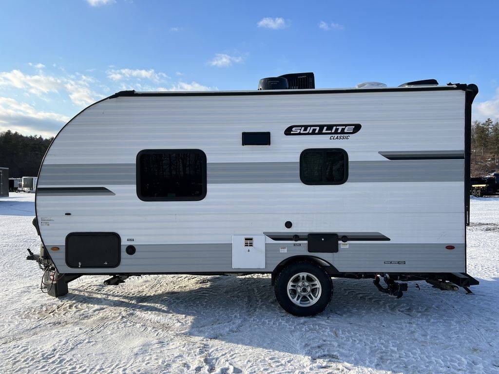

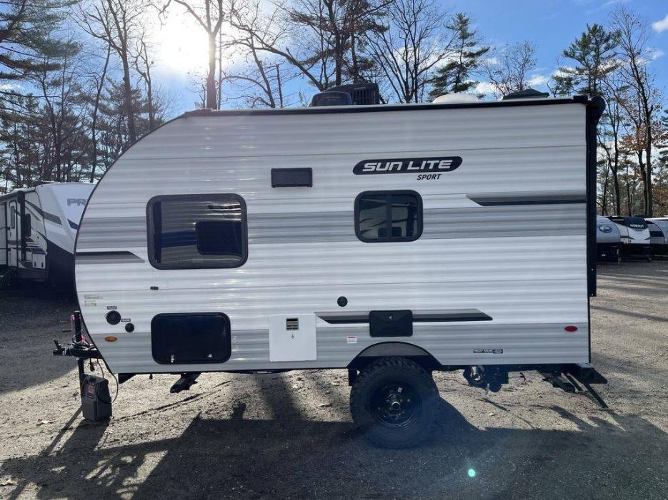

I've narrowed down to these 2 trailers and wonder if I'd really feel the difference in 500 lbs or the extra 2-1/2' of length. The Murphy bed in the larger one is really appealing, while all other features are identical.
Sun Lite 16bh:
16-1/2' long
7'-6" wide
about 100" to the roof, not AC, w/out lift
2500 dry
3500 max
Sun Lite 18rd:
19' long
7'-6" wide
3000 dry
4000 max
Stock suspension, with 265/75-17 BFG KO2's Load C getting mounted on FJ steelies. I'll get SumoSprings or airbags for the rear. Sumos were awesome on my last Class A RV, much better than the airbags that kept blowing a line at 50 psi.
It doesn't sound like I'll need a WD hitch for the smaller size - nor does it seem to be recommended for the factory hitch. The jury must be still out on fitting a 4th Gen hitch WITH spare tire, because none of the threads I found say yes.
Pics for visual reference, unfortunately I can't find any with a T4R. Some models are available with flipped axle and more clearance.
Get the shorter one, or go for the bigger one and suck it up?
Sun Lite 16bh:
16-1/2' long
7'-6" wide
2500 dry
3500 max
Sun Lite 18rd:
19' long
7'-6" wide
3000 dry
4000 max
I'll get SumoSprings or airbags for the rear, and it doesn't sound like I'll need a WD hitch for the size - nor does it seem to be recommended for the factory hitch. The jury seems to be out on fitting a 4th Gen hitch WITH spare tire.
