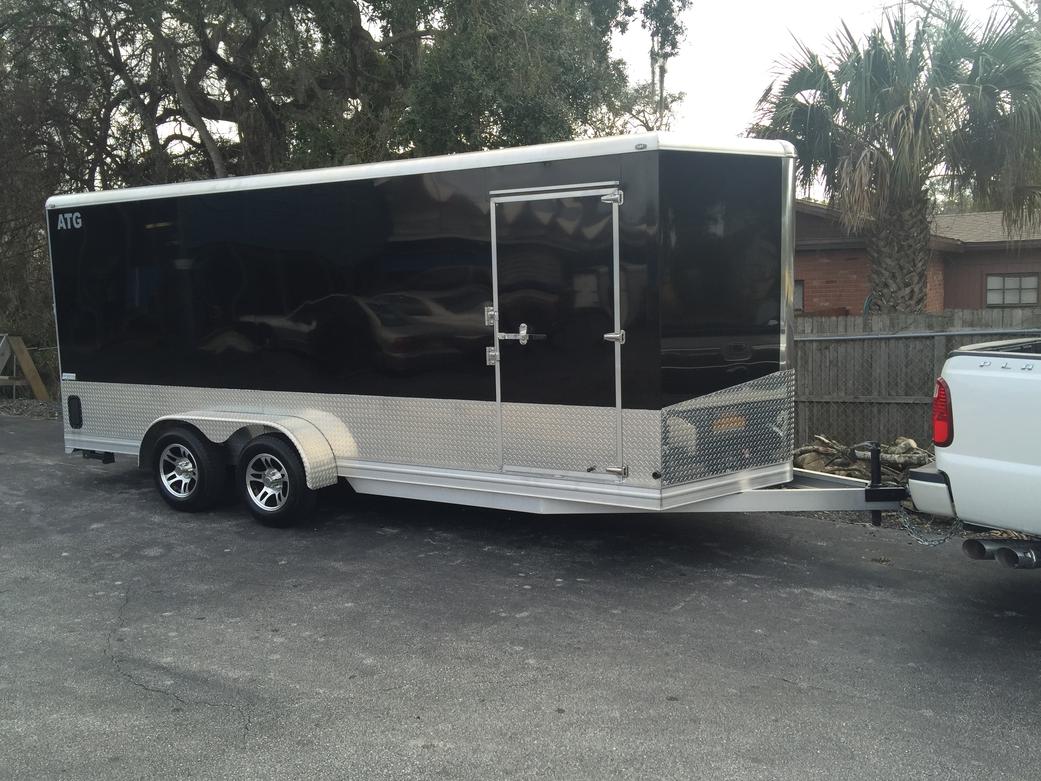

Update. So finally got a picture of trailer along with weight. It's 2200 lbs empty. Seems pretty big, more than expected. Again if I figure 3 bikes max. Might be slightly lighter let's say 600lbs each that makes 4K lbs so not bad. Plus helps trailer is much more narrow than my other trailer. 7' wide is better than the 10' wide deck over I did last time but. Let me know input again. Worse case I take trip with my buddies f250 but I much rather just run my own vehicle.
And I'm sure once I attach picture it will be upside down. No clue why pisses me off every time. Sorry in advance.
a 10' wide trailer would be 120" requiring a wide load permit.
you should be fine but your weight on the bikes have gone from 700 lbs to 600.
you are probably gonna be closer to 4500lbs with luggage.

Yea sorry. I ment for my sled trailer. Fits two sleds side by side so more like 8-8.5' wide. But the bikes I'm towing is changin I may not have any but if I do there older. Which isn't light due to ACTUAL steel in builds but Deff not as heavy as a new bike loaded w electronics and fairings. I'm rounding a bit. And I know one I'm towing is a custom Panhead which is Deff only 500 lbs at most.
