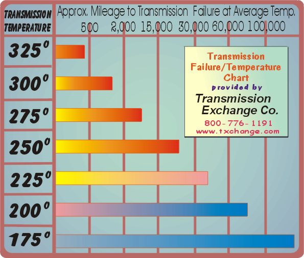

Does anyone know what the max temp rating is for the transmission before it starts melting o-rings? I'm not interested in guesses, so if you don't know the answer please don't throw out a guess.

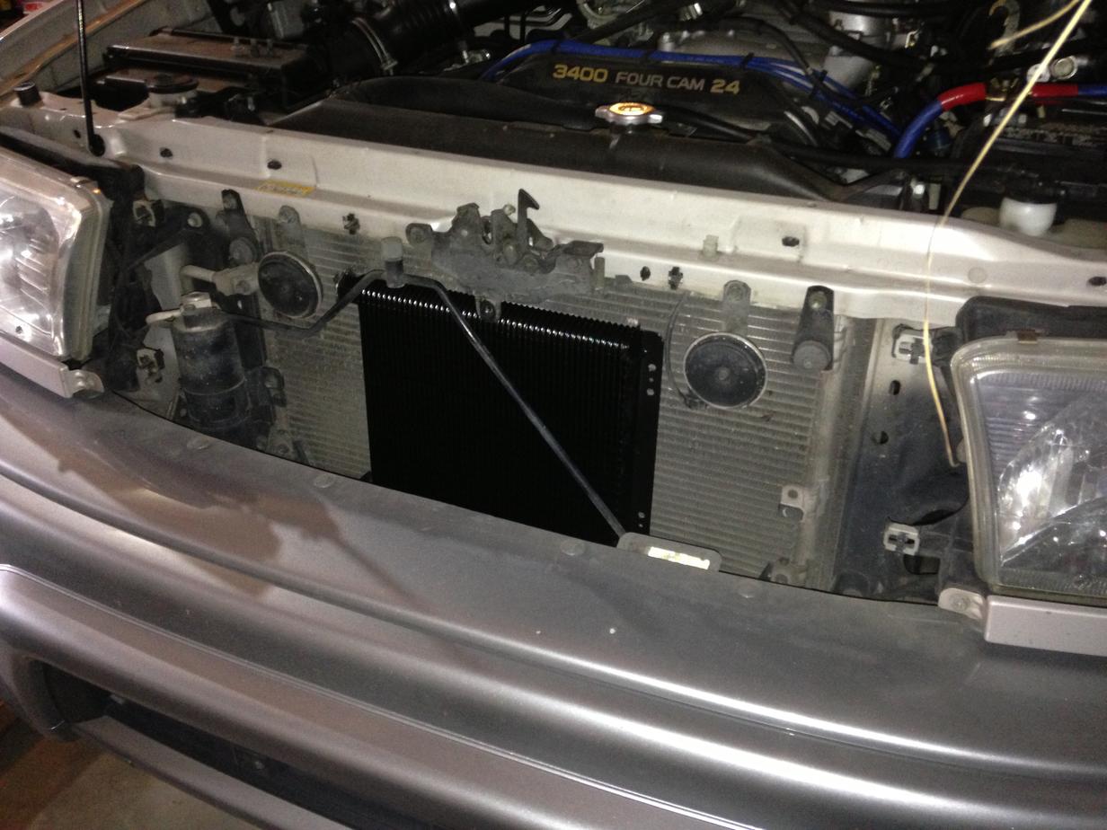

I am running a B&M 70274 rated at 29,200 btu and it keeps my 4Runner cool. I'm towing about 2500 pounds so much lighter load but it's in 105+ degree heat, 4lo, dragging my trailer through deep sand moving around 10 mph or slower and my 4Runner is on 285's. I will sometimes see temps up to 200 and one time I got stuck it went up to 210, but not for more than a couple minutes before it came back down. Even pulling hills in AZ on freeway in 2wd and 112+ degree heat I'd never get over 190. Biggest difference between us is weight. Here's a link to the cooler I have and pics of my trans cooler set up.
*notes: I had to remove black center bar that runs vertically and attaches to the core support. This bar is also where the center clip of the grill attaches. This also means I had to ditch the center clip on my grill and this has made zero difference for me.
Actual Cooler core measurements: 11.25x11.5x1.5 its as thick as you can go and still get your grill to attach properly

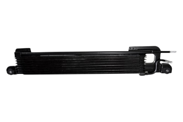

Try ford escape transmission cooler: about 18 inches long and 5-6 inches wide.
This should fit at the lower valence opening
