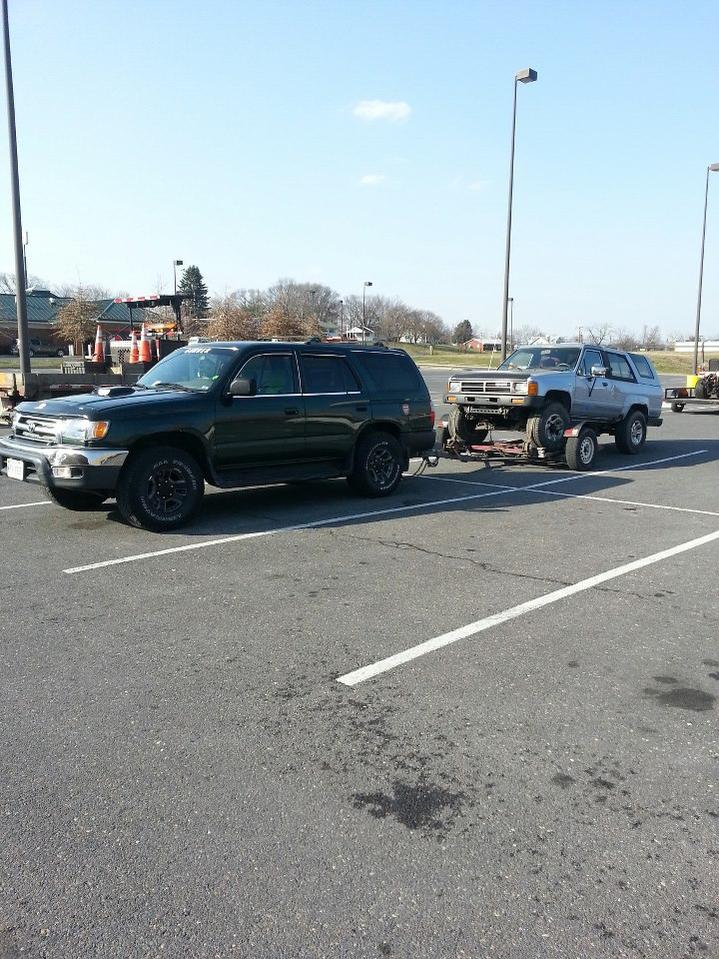

Its a toyota man! these trucks can do anything. I towed a 1st generation runner with my stock 4 cylinder 3rd generation well over 60 miles and it had no problems at all, and you got a V6 with a trans cooler. You'll be fine man.
