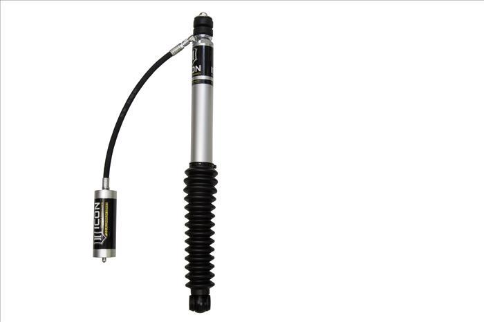

ICON 2.0, w/Res - Part #56505R
Use Part Number '56505-Upgrade' on Stage 2 Kit to Include Rear Shocks w/Reservoir
