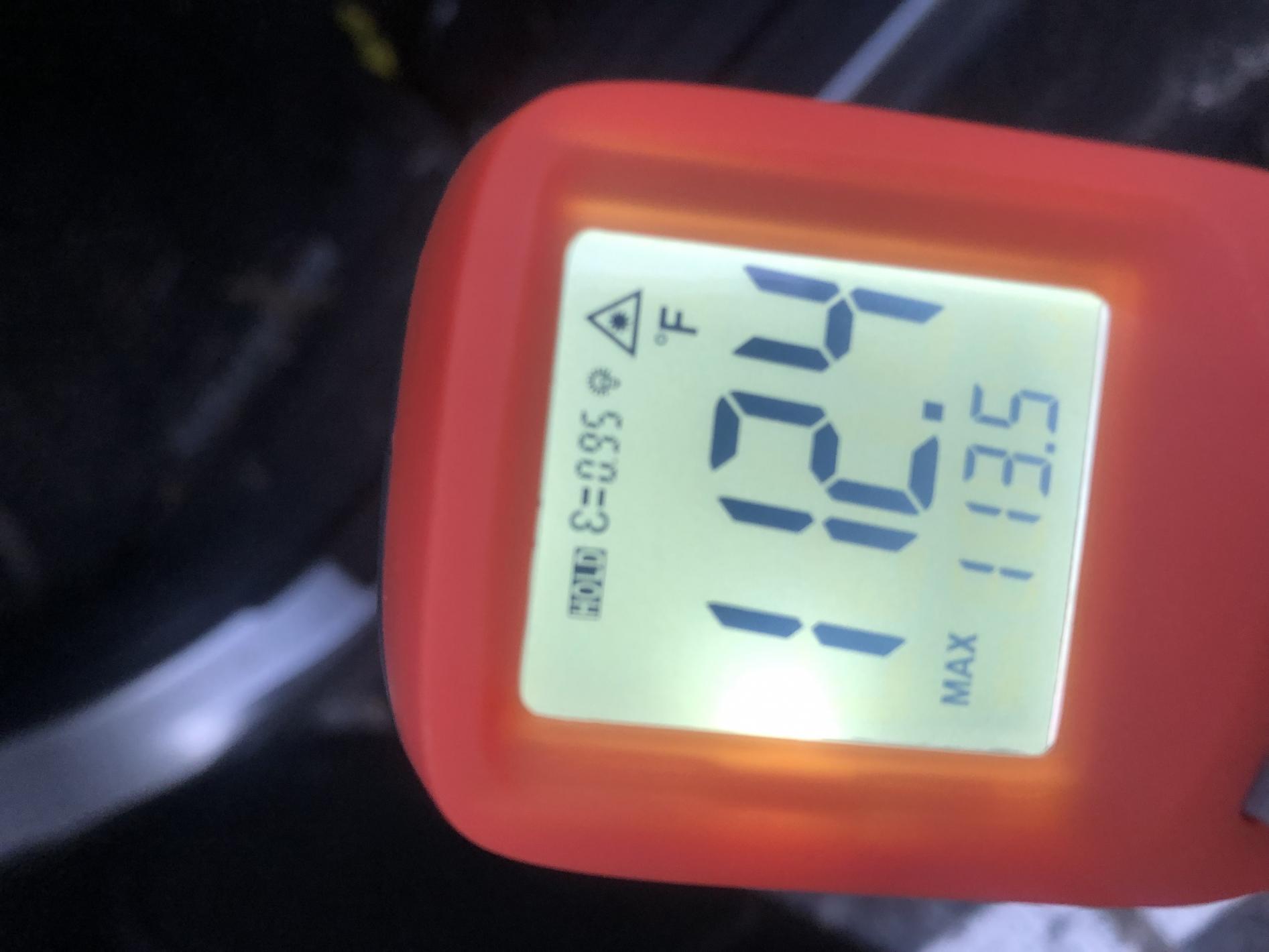

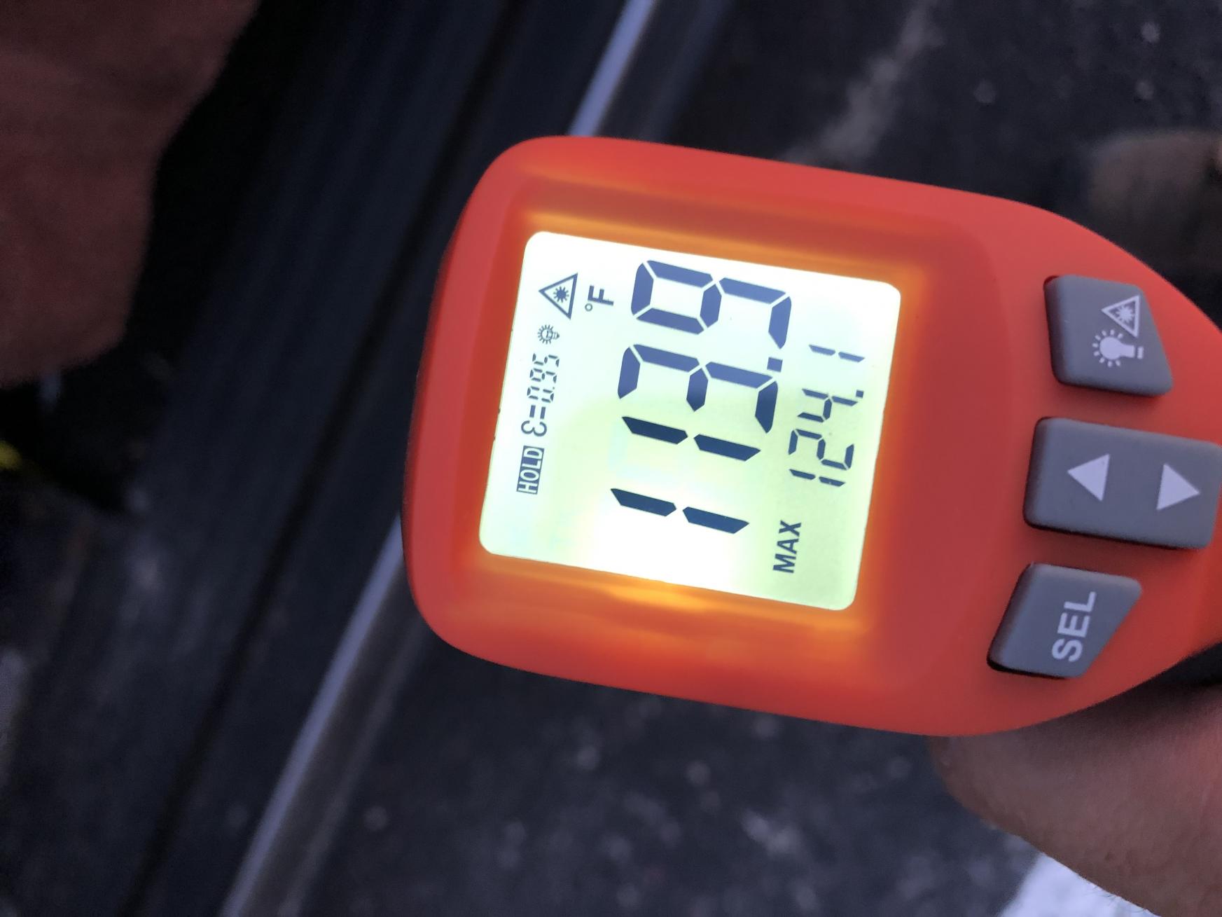

I ran Amsoil 75w90 GL-5 for 22k+ miles and had no issues; I personally think the TC operates better with a thicker fluid. Then I decided to change to a GL-4 fluid and Redline is what I decided to go with.
Ran the Redline MT-LV 75w GL-4 for two weeks, and then bumped back up to a thicker fluid and am currently running Redline MT-85 75w85 GL-4 that is double the operating thickness over the MT-LV.
The photos attached are the difference in temperature between the two fluids; the MT-85 being much thicker had No affect on temperature. Same miles driven, same air temperature.
