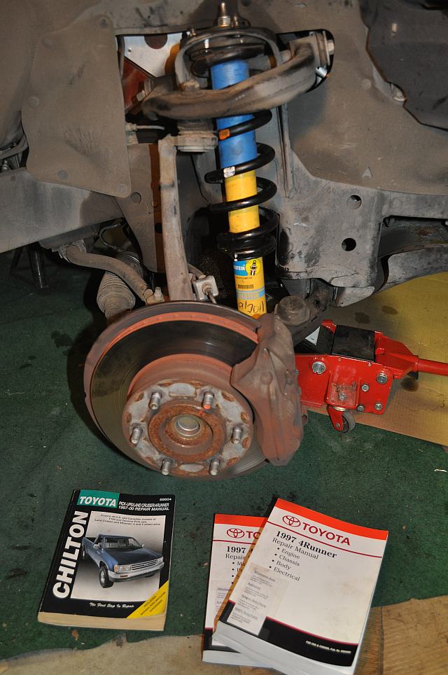

This is merely a question (and resolution) about the precise meaning of stabilizing and lowering the suspension in the Toyota & Chilton shop manuals.
If the next 2WD strut newbie better understands the FSM instructions by reading this thread ... then we will have accomplished a worthy goal.

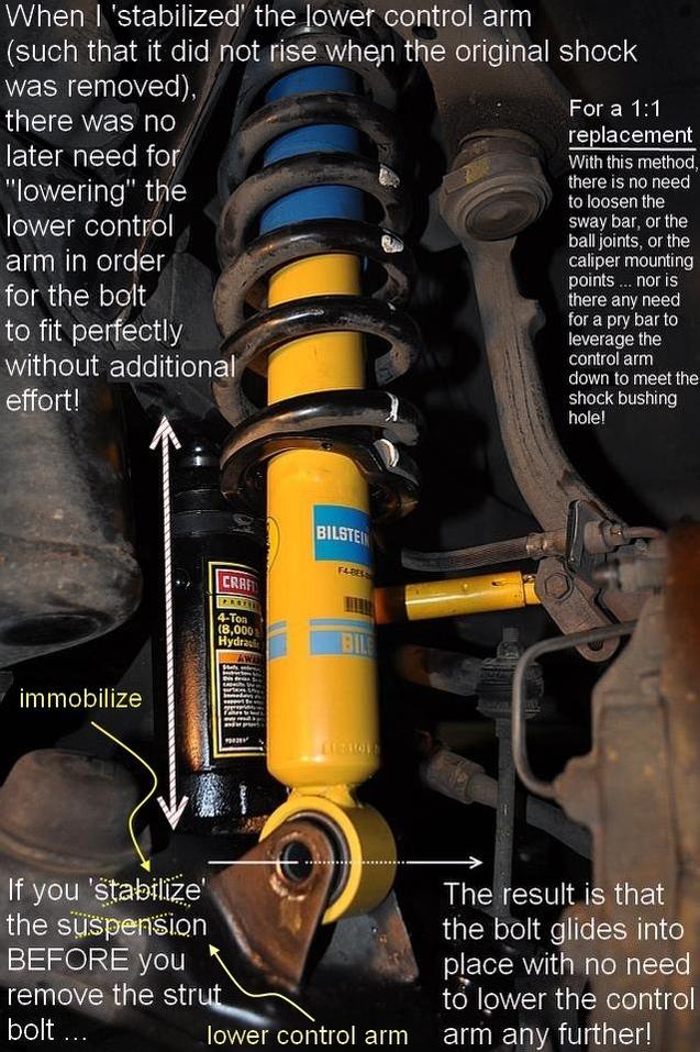

A simple summary of the trick that worked, for me (so that others may benefit)
I'm not sure why there are a few people here who seem to display decidedly non-adult behavior when a newbie outlines a trick which worked well for them; but I'll ignore any non-technical content to simply post, for those who wish to learn, particularly newbies, a well-annotated easy to understand picture summary of a key strut-replacement step I learned in this endeavor:

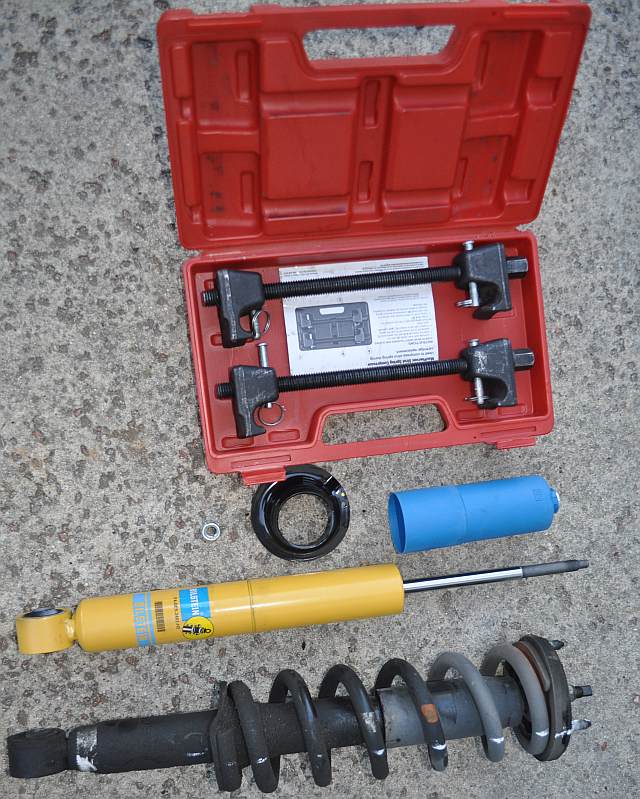

For other newbies to further benefit, there are many styles of spring compressors available.
See, for example, this thread:
- Which style of spring compressor do you recommend using for a 3rd-generation 4Runner?
The picture below shows the Autozone spring compressor; notice it doesn't look anything like the spring compressor described in the factory shop manual; but it worked fine, for me, without any problems whatsoever.
