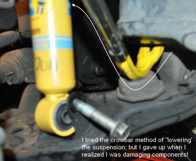

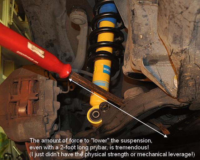

no 'stabilization' was required. Just pop in the strut, adjust slightly with a 2' prybar, and done.
My first time, since I didn't know what stabilization meant, I skipped that step.
Then I found out why I shouldn't have skipped that step! :)
The control arm popped up, after the shock was removed (because I didn't 'stabilize' it).
To "lower the suspension", (translation: lower the control arm hole to meet up with the shock bushing hole), I practically stood on a 2-foot prybar & also a very long crowbar (see photo below).
I failed. Miserably. You must have the strength of an ox! I don't. :(
Piece of cake, other than the spring compression, which I gave up on (I had cheapie NAPA compressors) and took to a mech with a wall machine.
I agree, the job is a piece of cake, once you get past the 'stabilizing' and 'lowering' of the suspension.
Code:
[I]Translation:[/I] [B]Stabilizing[/B] ==> I infer that means to keep the control arm where it was, both before & after you remove the strut!
[B]Translation:[/B] [B]Lowering[/B] ==> If you don't stabilize well enough, the control arm moves up when you remove the shock ... so you now need to mechanically lower the control arm to meet up again with the shock bushing.
Note: Most people "lower" but I found if you properly "stabilize", there is little need to lower! <=== that's the trick!
It's just one 19mm bolt on the bottom and three 14mm bolts on top. Nothing to it. While the first took hours, my third one took about 20 minutes even with snapping of pictures (I had to re-do the first one because I accidentally left a washer out).

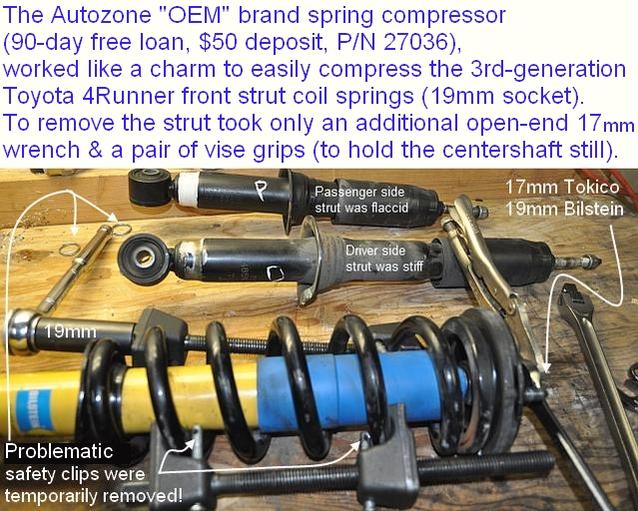

Spring compression was way way way easier than everyone intimated it could be. (People said they bend, and break but these were solid as a rock.) Three times the compressed the springs and three times it worked just fine with no drama.
I highly recommend that Autozone free loaner tool ($50 deposit, 90 day loan):
  • OEM brand, MacPherson Strut Spring Compressor #27036
  • OEM Customer Service: 866-458-2472 (Mineola, NY)

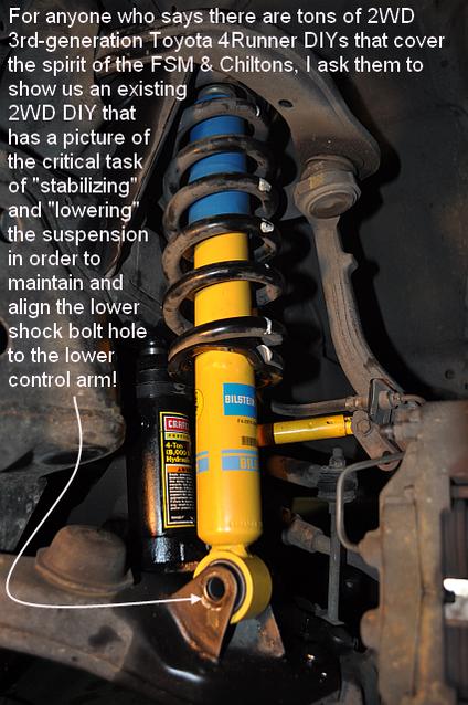

If the DIY skips the 'stabilization' stage, then you're stuck with a more difficult 'lowering' stage.
However, if the DIY shows you how to stabilize - you entirely don't need to lower! <=== that's the trick!
Once you know the 'trick', this front strut R&R is almost trivial (I give it a 3 out of 10, simply because of the danger of the spring); otherwise, it would be a 1 out of ten (it's just 5 nuts, in total!).
There should be no reason for a DIY to say "stabilize" the suspension, when a person who has never done the task wouldn't have a clue what that means or why you are 'stabilizing' it.
Also, when the FSM says "lower the suspension", again, they could have mentioned why you're doing this and what suspension part you're actually lowering.
I wonder if BigFishAllDay has done his yet? He could do a write up that would make mom envious.
If I could have found a decent 2WD strut-only DIY that used the factory method, I would have followed it!
But, most DIYs don't (apparently) 'understand' how to stabilize. If you stabilize well, you have no need to lower - and most DIYs use all sorts of methods to lower but they don't have to! <=== that's the trick!

Key points:
1. While many people have trouble with the spring-compression step, it was the suspension-immobilization that took me a while to figure out.
2. The manuals tell you a key step is "stabilizing" the suspension BEFORE removing the strut.
Most DIYs apparently skip that step (perhaps out of misunderstanding); but (I learned) it was THE key step in my strut replacement!
3. The manuals also suggest "lowering" the suspension BEFORE re-installing the strut.
Most people are forced to perform this step! (I learned I could skip this step if I performed the stabilization well!)
5. Most DIYs, therefore, end up adding additional removal steps so that you 'can' raise the lower control arm to meet the shock bushing hole!
6. I searched extensively (and Nelson searched too!) and none of us can find a 2WD Toyota 4Runner DIY that shows those both steps.
7. Those who 'say' 2WD is the same as 4WD (or that all cars are the same) still have trouble finding even a 4WD DIY that doesn't skip the key step!
8. Those who say 2WD is the same as (Chevy, Ford, Mazda, etc.) don't come from it from the standpoint of a newbie.
My main lessons summarized:
  1. With a strong spring compression tool, the strut was easily disassembled sans drama (see photo below).
  2. When I stabilized (read "immobilized") the lower control arm before removing the strut, such that the LCA remained in position after the strut was removed ... it was quite easy to put the new strut back in ... since all the bolt holes lined up by default (i.e., there was absolutely no need to further lower the suspension LCA).
  3. Had there been a need to further lower the suspension lower control arm, this technique also allows for minute adjustments so that the lower control arm may be adjusted down (or up, if needed) to fit variously sized shocks (mine were 1:1 replacements).
