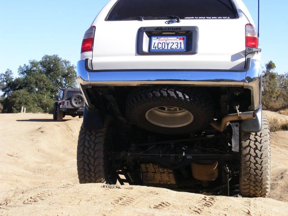

For my spare tire I did two things. I run a 255 (much narrower) and I had the spare tire elevator cut, raised 2" and re-welded for $60. Everything works just fine and the spare is tucked up there nicely. Zoom in on first pic and you can see its profile. Yes there are two schools of thought on; a 1/2" diameter spare tire difference (just don't 4X on dry pavement if rolling on it), and a hung spare (I have not drug mine yet).

You can lift up the rear bumper cover and lower it. I now just keep my spare in the back.
Yeah, I saw that when I removed my rear bumper. I will probably just do a small hole in the bumper cover to always have an easy acces. I want to leave the spare there to keep all the space in the truck.
Yeah I hate having my tire in the back. Thinking of putting it on the roof. With the body lift if you dont modify it the tire just bounces around because it does not pull it up against the body. So when wheeling its bouncing all over. People always would tell me about that was following me and had to explain it was the body lift. It also was getting hung up on the trail.
I never tough of the tire bouncing around but your right. I will have a look at it. Maybe with only a 1'' body lift its not that bad.
