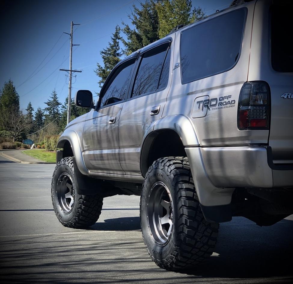

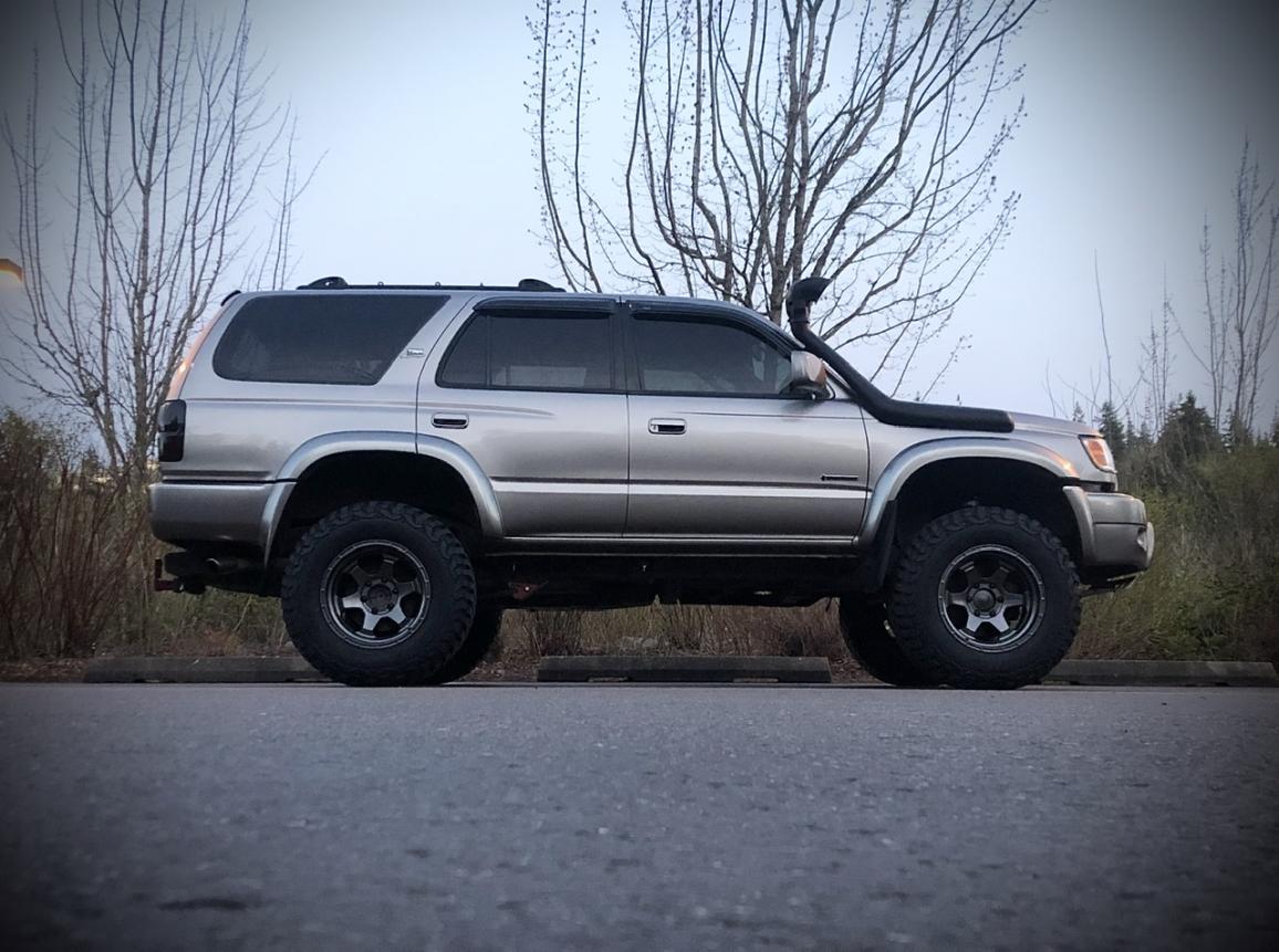

Pics below with 3” ultimate coilovers.
I have the 3” ultimate coilovers installed also but I felt an extra inch is needed if I decided to go with body armor.

What size tires are those?
