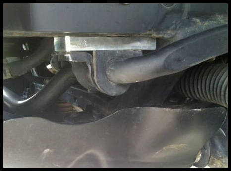

I took it into the dealer who did the install and they found out the sway bar was actually rubbing on the coil :frusty: I asked if it was because I had the caster bumped up to 2.9, and they said it shouldn't be the reason. I dont' think anyone with a SW bumper is running the Toytec Boss kit, so would it be because of the bumper?
They suggested to shave a little off the sway bar and I reluctantly agreed because I didn't want to lift it higher because I like the way my cv angles look, and I know guys even take off their sway bar with upgraded shocks and coils, so I assumed I should be ok if they shaved a little, if anything I could take them off? So they shaved a little off the sway bar and no more squeaks. I asked them to show me where it was rubbing and the sway bar is definitely very close to the coil, I couldn't even get my index finger in the space, I have big hands...for an Asian lol so basically average size hands for the American population.
It's a little too late to really do anything about the shaving part, but do you guys think it was plain stupid (after [MENTION=66316]1engineer[/MENTION] 's "stupid" rant, I'm afraid of what he has to say :) but I still welcome it) to shave a little off the sway bar? I know I am messing with the engineering of the factory 4R so that in itself is a caution. I plan on touching up the shaved area with some rust protection. But any other advice/insight would be much appreciated. Thanks!

Look for the silver bracket in the front of your wheel-well:
So the mechanics decided that the proper fix was to grind off a section of sway bar eh? Can you take a picture of where on the sway bar?

You should have got those spacers with the lift, but if not, contact Toytec and I'm sure they can send you some. You aren't far from them, so shipping should only be a day.
Make sure to paint whatever section of swaybar was ground off, as well as anything it rubbed paint off of on the coil.
Yea, you need the spacers. Night and day difference before and after I installed mine with the noise issue. I would also recommend getting longer links for the rear sway bar too if the rear is lifted.
Did you install spacers for the sway bar? IIRC, all of the front end lifts for non-KDSS have sway bar spacers.

No spacers installed. I called Toytec and they are sending out the parts this afternoon. They were kind and polite about it. No questions asked.
20140225_075747_zpsb1540865.jpg~original
Well, I am "that guy" with the stupid mistakes :doh: To my untrained eye, it looks like a little shaving, not compromising too much the integrity of the swaybar, correct?
I think at this point this is all I can really do. Will wait till the spacers arrive, then I'll paint over the exposed sections, and other rust areas while I'm down there. Thanks again.
