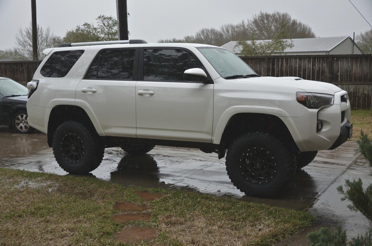

Im assuming your still running the stock wheels. you could gain some clearance with the aftermarket uniball style arms, But, Most people perfer the wider stance with either aftermarket wheels or the spacers as the truck usually looks much better. Ive had a number of people that didnt think they wanted it that wide until they saw it.
I'm running 285/70-17 but I think is the offset of the wheels. I went ahead and got the spacers. Thank you for all your help.
Here is a pick.
Thanks. It does sit pretty high I measure from the ground to the wheel well 41 1/4" in the rear and 39 1/2 up front, I really like it like that and I probably won't go any lower at front. I still have to do the 1" differential drop + the wheels spacers before I take it to get it align.
