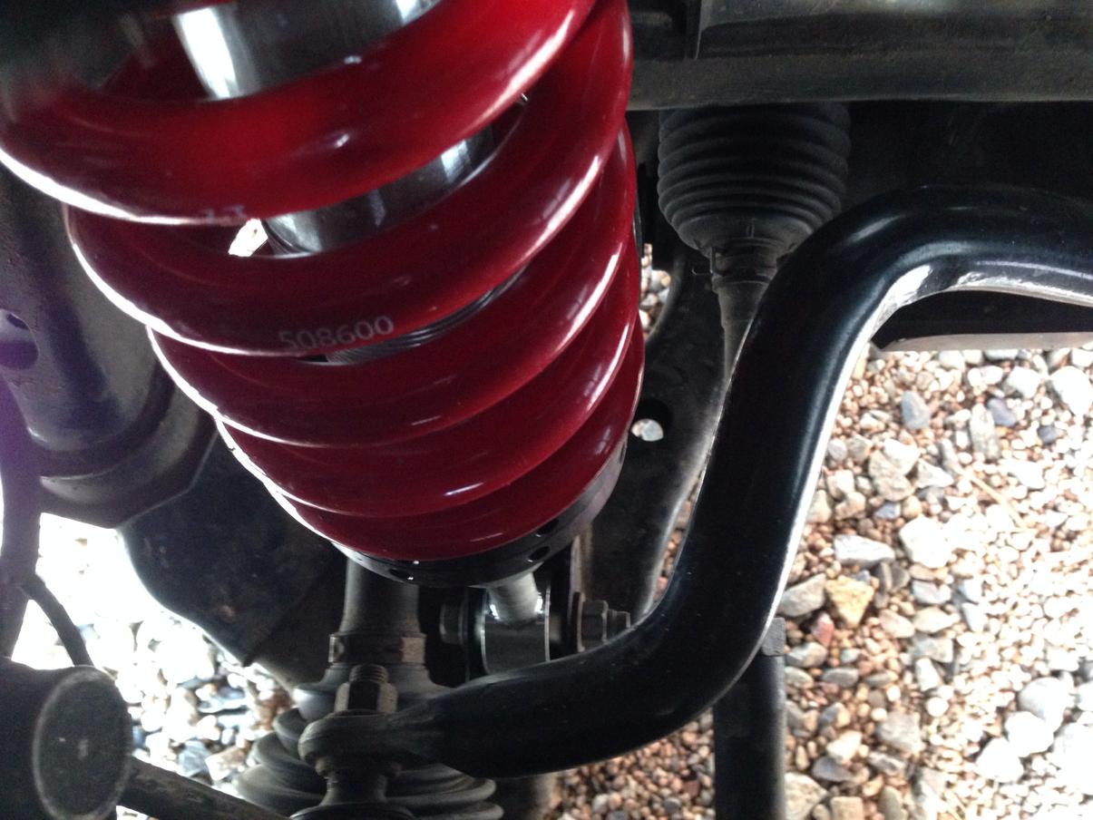

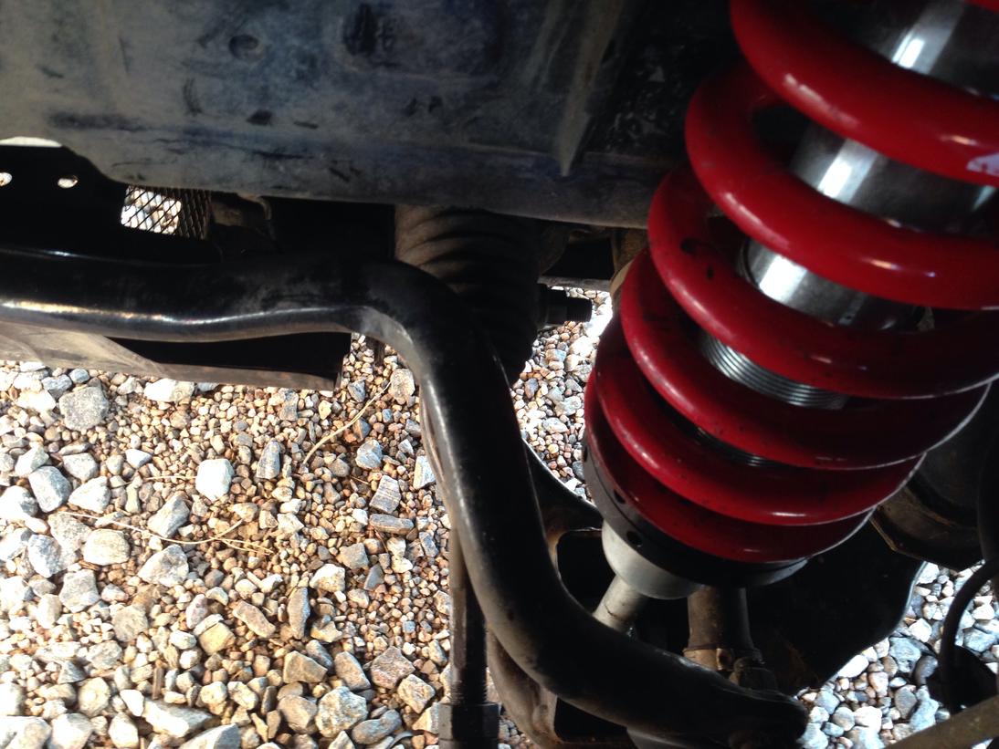

All kinds of room!
[MENTION=104688]Lenny33[/MENTION] What's ride quality like? How does it absorb things like pot holes and speed bumps at slow and fast speeds? I'm looking for a plush ride without spending $$$ on a King set up.

I'm kinda confused. Just to make sure I understand what you're saying, swaybar spacers = the black spacer around the swaybar (which is stock), and the frame brace spacers = the silver piece in KCcarguy's pic?
Also do you mean the bottom of the coilover that has the empty space should be faced towards the rear of the vehicle? And what do you mean when you say it should come with a thicker and thinner bushing? Should it be thick and thin at the same time, how's that possible?
I would build the ground down portion with bondo and wrap it with duct tape just to be safe!:pimp:
Ok, will do...wait...wtf?...oh yeah, it's [MENTION=81573]Stifler[/MENTION]...wait...is he serious? lol is he? :doh:
... other side.
Wow, I am really no where near that right now lol Thanks for the pics!
Hey man, sorry about the confusing post. First of all, I was assuming the Toytec Coilovers were similar to the Icons. After reviewing the Toytec install instructions(http://www.toyteclifts.com/images/stories/pdf_files/ul-fj3k_instructions.pdf) and looking at [MENTION=104688]Lenny33[/MENTION] 's pics above, I see they are different. On Icons, there is a short spacer and a long spacer at the bottom Coilover mount. On the Toytecs, the bottom mount is the same on both sides. So, disregard.
As far as the swaybar relocation, once again, it looks slightly different than the Icon kit. The install instructions above give pics and info on how to install the Toytec one. Disregard what I posted about the spacers for the frame braces.
Once again, I apologize for the confusion.:faint:
