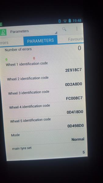

Here we work with the cub uni sensor , we use alternative sensors empty by cloning the original sensor codes.
However, these sensors are universal and can be erased and recorded in many ways.
Today I can clone them for a Volkswagen tomorrow for Opel.
Only the original ones and those already programmed for a particular car have codes.
Those that are universal are empty.
The difference is that if you put the programmed you just have to save them in the car's memory.
But if you buy empty you have to have a technique to clone them wirelessly.
This is also my problem I see the codes when I open the car's controller but I can not read them wirelessly.
The technique that I have bosch tpa200,texa axone s tps,cub sensor aid reads only on frequency 433mhz.
And yours is 315mhz.
And to be able to clone a sensor I have to read it first wirelessly.
