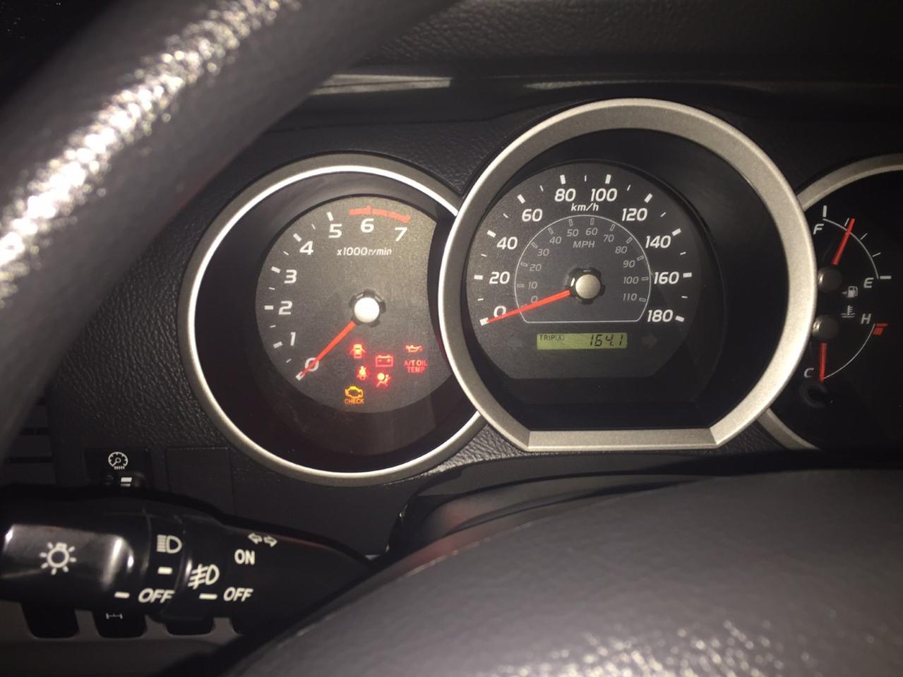

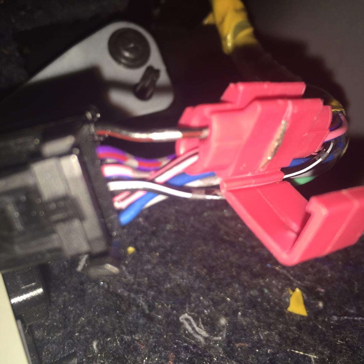

Just want to add, I decided against doing the bypass switch and opted to just do a bypass using a scotchlok-type connector. I wanted to add an important point......after some frustration I came across a post by a member who shared that the wiring appears to be different on the 09's Pretty sure it's also different for the 08's. Anyways on my 2009 SR5 the wires are NOT the pink/black with white/black. It IS the pink/black with MAROON/black. I had to remove the scotchlok from the incorrect wire, retape it, and then scotchlok the other two together. I also want to add that I used a 18-22 ga connector and it seemed to work fine after I squeezed the scotchlok really well. I will attach some pictures; One pic of the connection and one to prove the light is disabled .hope this helps some ppl. Cheers
