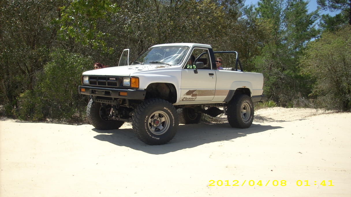

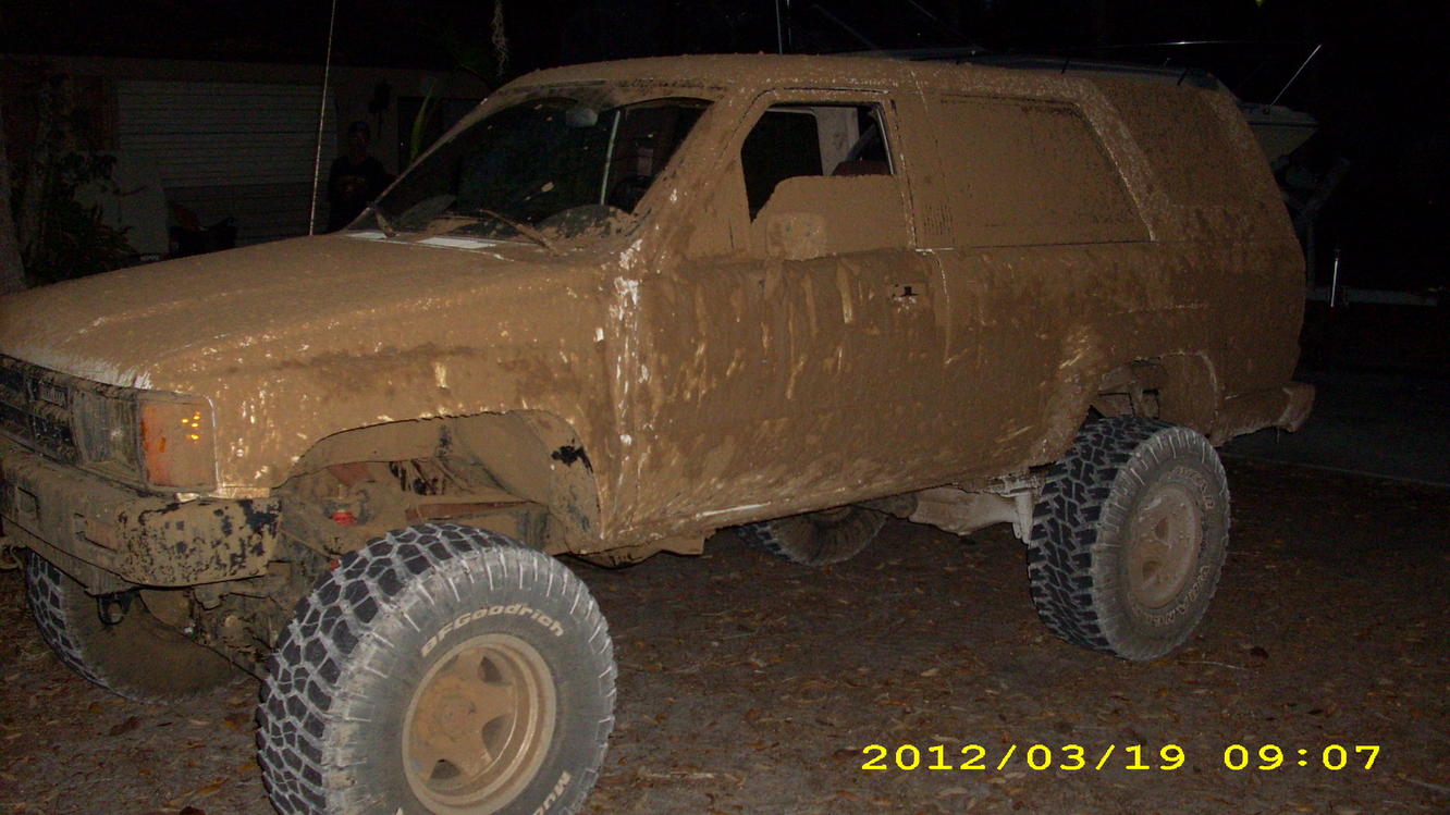

I have a rough country 4 inch kit on mine it was 600.00 it came with shocks rear blocks front drop brackets and spindle brackets I cranked the torsion up a bit and added pro comp rear helper spring . it rides a little stiff but i like it.
33/12.50/15 no rock crawling where im at in fl but there is a lot of mud and sand and a little clay as you can see from picture.
