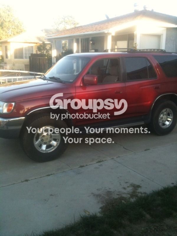

Picked up this 4x4 5spd v6 yesterday for $3,000. The body is far from pristine, which is good...cuz I'm just gonna thrash it anyway.
ccee5c26.jpg~original
It's a factory e-locker truck but someone has swapped in a standard axle...I found an e-locker 3rd with 4.88 in it for a good price, so I picked that up and I'll modify the housing to make it fit. Plans are 4.88s for the front diff with either a selectable or probably a true trac lsd to help save the cv axles. Seems "lefty" t-cases are a bit more expensive to gear than the old ones, so I'll have to bite the bullet there and buy a taco supreme from marlin. For now, we'll keep it IFS and run a OME lift to fit 33s, build my own tube bumpers and sliders, then wheel the hell out of it. I'll probably throw a winch on the front just in case.
The process will start shortly.
