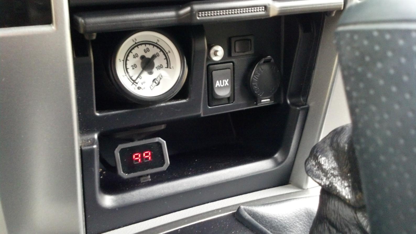

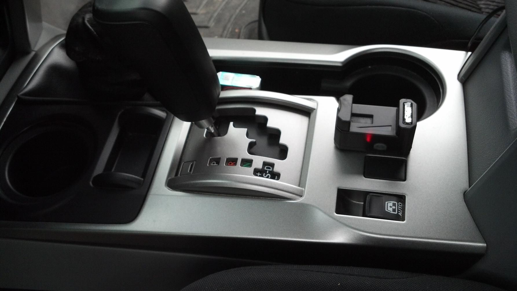

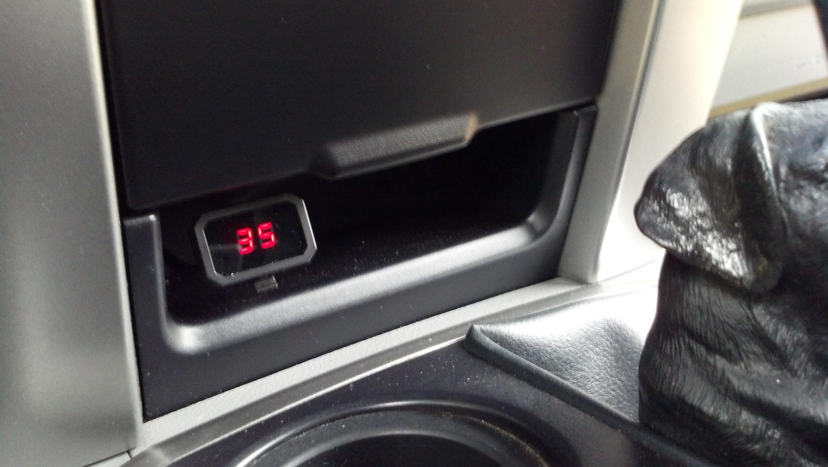

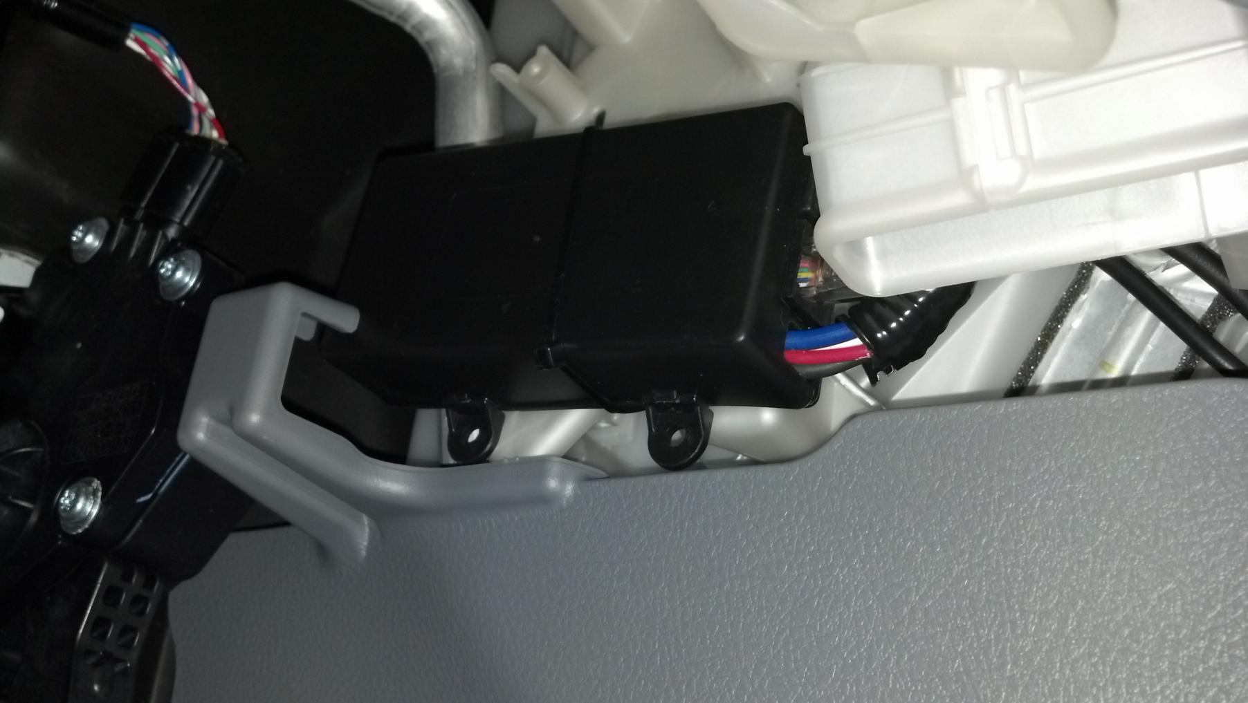

I installed Hopkins InSight Brake controller a couple of weeks ago. Got it online for $80 delivered. What's really cool is it's modular, only had to drill one hole in the center stack for the Flex-Display. Removed one of the blank plugs in center console for Flex Control (manual brake slide), Smart-Box (brake module) is mounted up high to avoid hitting with foot or leg.
They even offer an adapter to plug controller into factory trailer harness. I didn't order harness because factory harness provide with my 4R'er was plenty long enough. System is pretty stealth (which I like) and can be mounted in many locations. Very happy with how it turned out, works great also. Installation instructions below.
